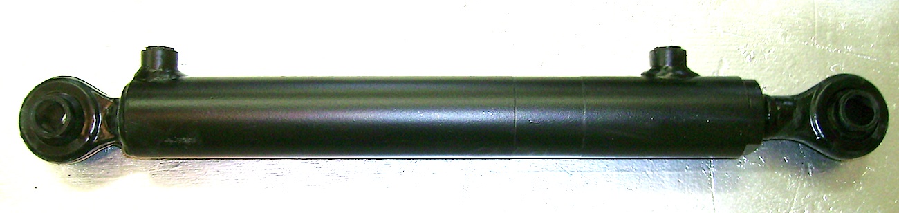

I took these hydraulic cyl. off of a Unimog that I am parting out. They were used on a rail unit and would raise and lower the rail wheels. They are 2" diameter with a 10" stroke with a 1" rod with swivel ends that take a 3/4" pin, just like the top link on my Kubota. Would they be too light weight, or would they work for top links? I have four of them and have no use for them. What do you think they are worth? they were working just fine when I took them off last week.

Like mentioned in the other thread, you need to measure the closed length-in that picture they look long. Here are two very popular sizes of HTL't to compare them against: 9-7862

They are just under 19" from pin to pin when closed.
Von, that would seem to be a perfect toplink size. The ball adapters on each end are a perfect configuration too. I'd find similar new cylinders at Surplus Center and price those about 1/3 less from being used and put them on craigslist or eBay and/or the TBN classifieds.
