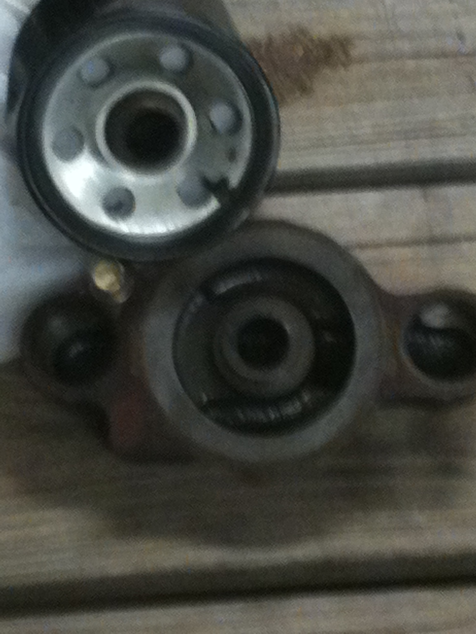

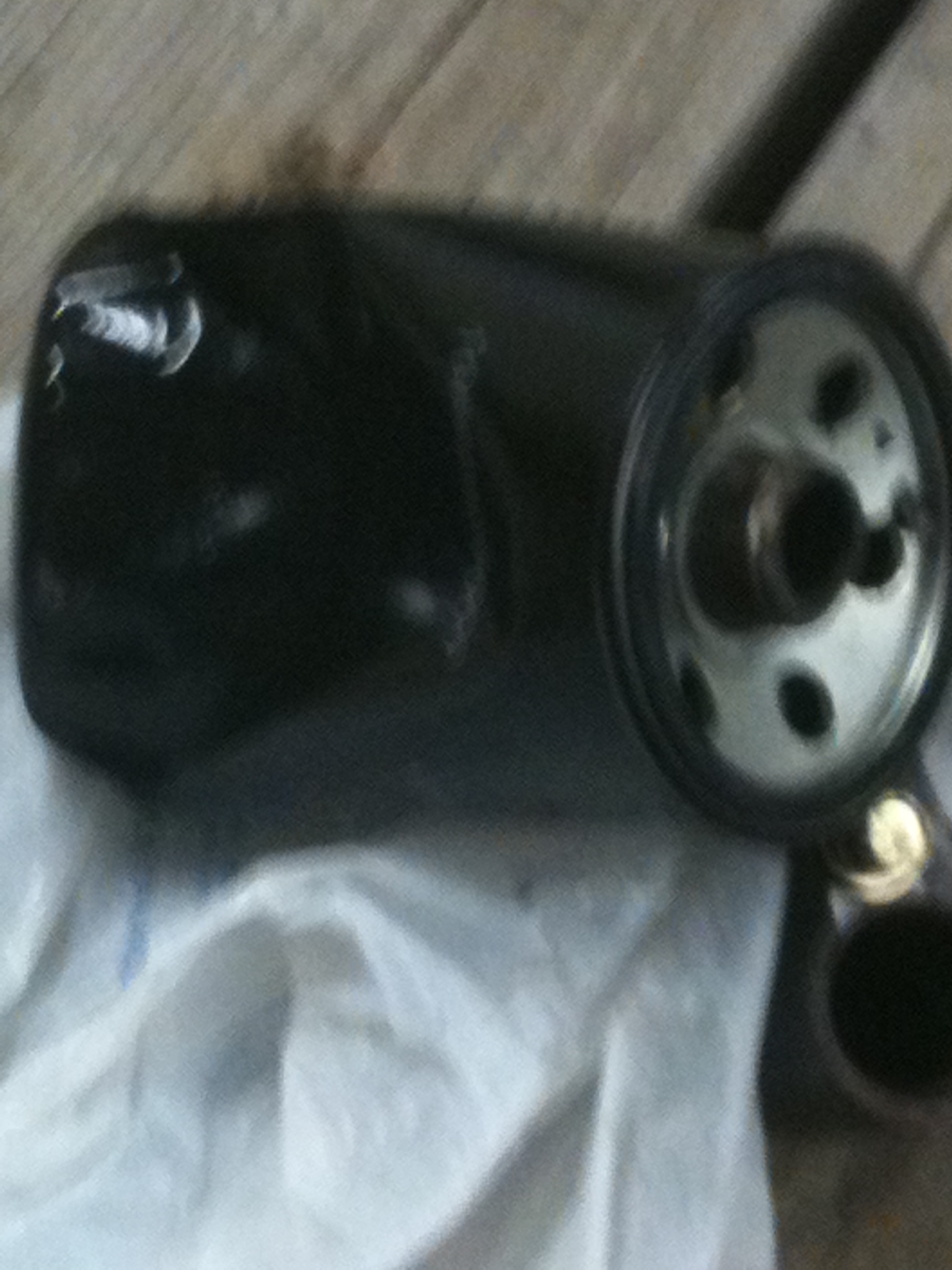

I spent the morning at the hunting camp doing a little bush hogging until my hydraulic filter found a log. I was clearing a new trail through a thicket and found a downed tree. I was using the FEL to move the tree when the front tires went over a T section of the tree. As the tires went over it rolled up and a large limb got the filter. It crushed the filter and broke the filter assembly. I had to drive 35 miles home to get tools. Went back and removed the filter assembly. According to a Mahindra dealer website the assembly is $265.20 list. I will call the local dealer Monday to check the actual price if it is too high I will check with a friend that runs a tool and die shop to see if he can repair it. I have posted pictures for your enjoyment:) Pictures are with a cell phone camera so not the best quality.

I looked at Mahindra 5525's and 6525's yesterday and noticed that a LARGE filter, was directly under my left foot, when sitting in the rider's seat and it was sticking down way to far---in my opinion. It looked prone to damage.

I won't blame this on engineering. The filter is actually tucked away pretty good. It is only luck that I have not broken something before now. Many of the hours I have put on this tractor have been clearing thickets. I back in if there is a question. I backed into this thicket and found a downed tree then turned around to move the tree with the loader when the incident occurred.
