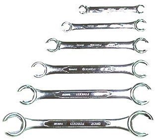

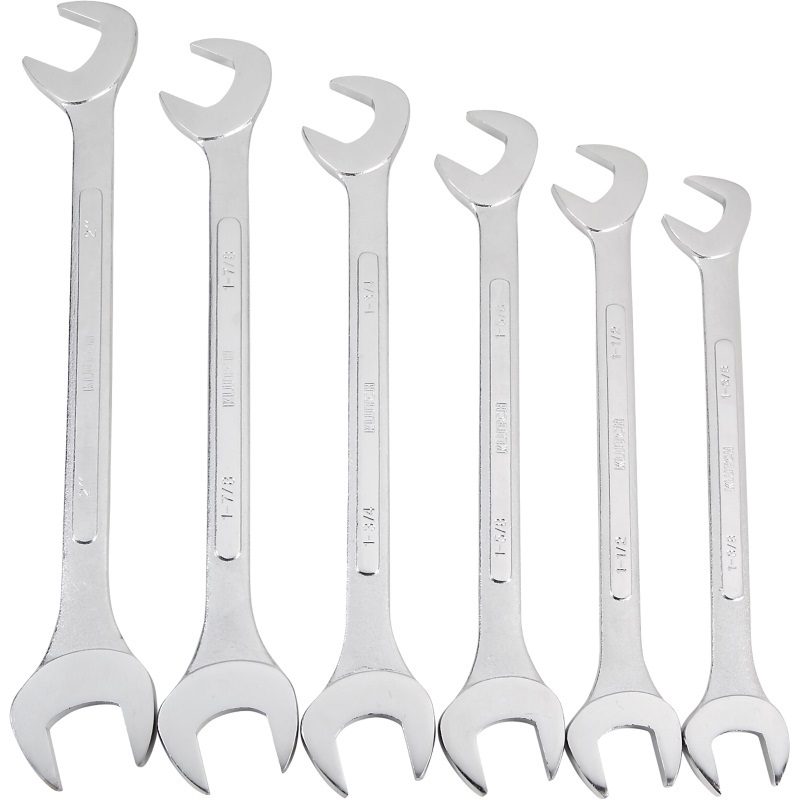

For hydraulic hose fittings, I have this style.
attachment.php
And Flare Nut wrenches.
attachment.php

Ok, I appreciate the feedback! I ordered some larger sockets (11-32mm), a 16" breaker bar, and flare nut wrenches from tekton, so we'll see how that goes. There is an extra $10 off for Father's day, so the price is pretty good, $50 for everything. Hopefully the flare nut wrench will work on the hydraulic lines, but I guess we'll see
