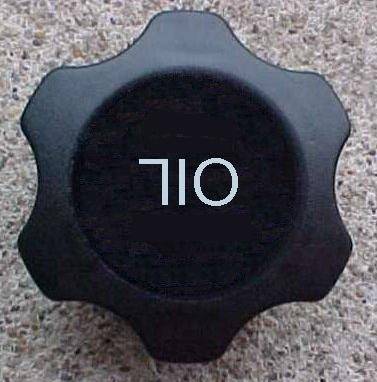

Oh, regarding oil.
There was a blonde once who actually checked her oil and found it low.
Then she proceeded to look for a place to pour the oil into the engine.
She finally went over to the service station attendant and asked him where she should put the oil.
The attendant wasn't too bright either. Seems he was looking at the oil cap from the same side of the engine as she was. After all, he was trying to be as close to that good-looking blonde as possible.
Here's what it looked like (attached).
Ralph
