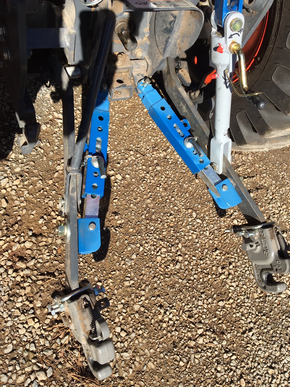

My B26 lift arm mods.
Pat’s quick hitch ($165),
Leveling box from Weavers($67),
Modified pin type sway bars from eBay($113).
Makes hitching up and adjusting so much easier. The extra length from Pat’s hitch is nice. Longer top link.
Kubota should have better 3pt hitch system to compliment this high end TLB.
Pat痴 quick hitch ($165),
Makes hitching up and adjusting so much easier. The extra length from Pat痴 hitch is nice. Longer top link.
Thanks, I'll check out your B26 mods.
