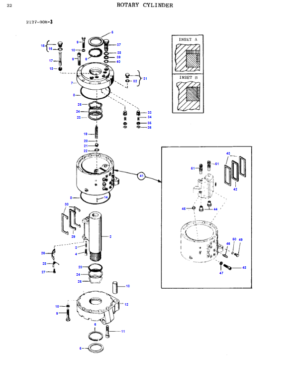

I have a copy of a manual for Massey Ferguson 52A and MF 54A,a and the parts drawing for the "Rotary Cylinder MF PN 729 -829-M91, Page 30, appear to be identical to mine but cannot vouch for sizes of O-rings and seals from pic. This book does NOT include PN's,,,,

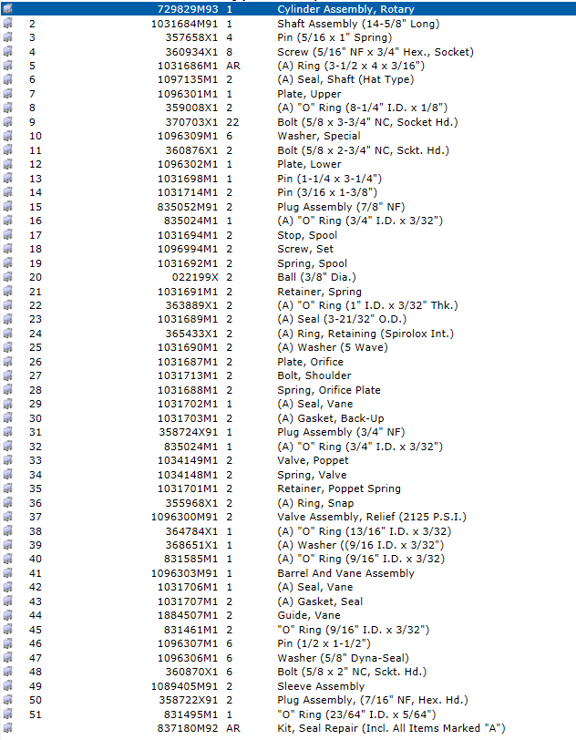

I searched the agco parts book online, see if this helps? If you view the parts book, you MUST use Internet Explorer. All other browsers I've used will crash and freeze.
AGCO Parts Books click :view book" near guest user. on the next screen punch in 54A in the "search by model" box, and where it says "all brands" click Massey Ferguson.
And attached is a screen shot of information you may find helpful.
The part number you provided cross references to the Massey Ferguson 54A Backhoe. I couldn't find this information in the 50B books. The part number also was updated, instead of M91, they've updated to M93 but it is still the same unit/parts.
These pics do show sizes of o-rings and whatnot, so it should be of help to you.
