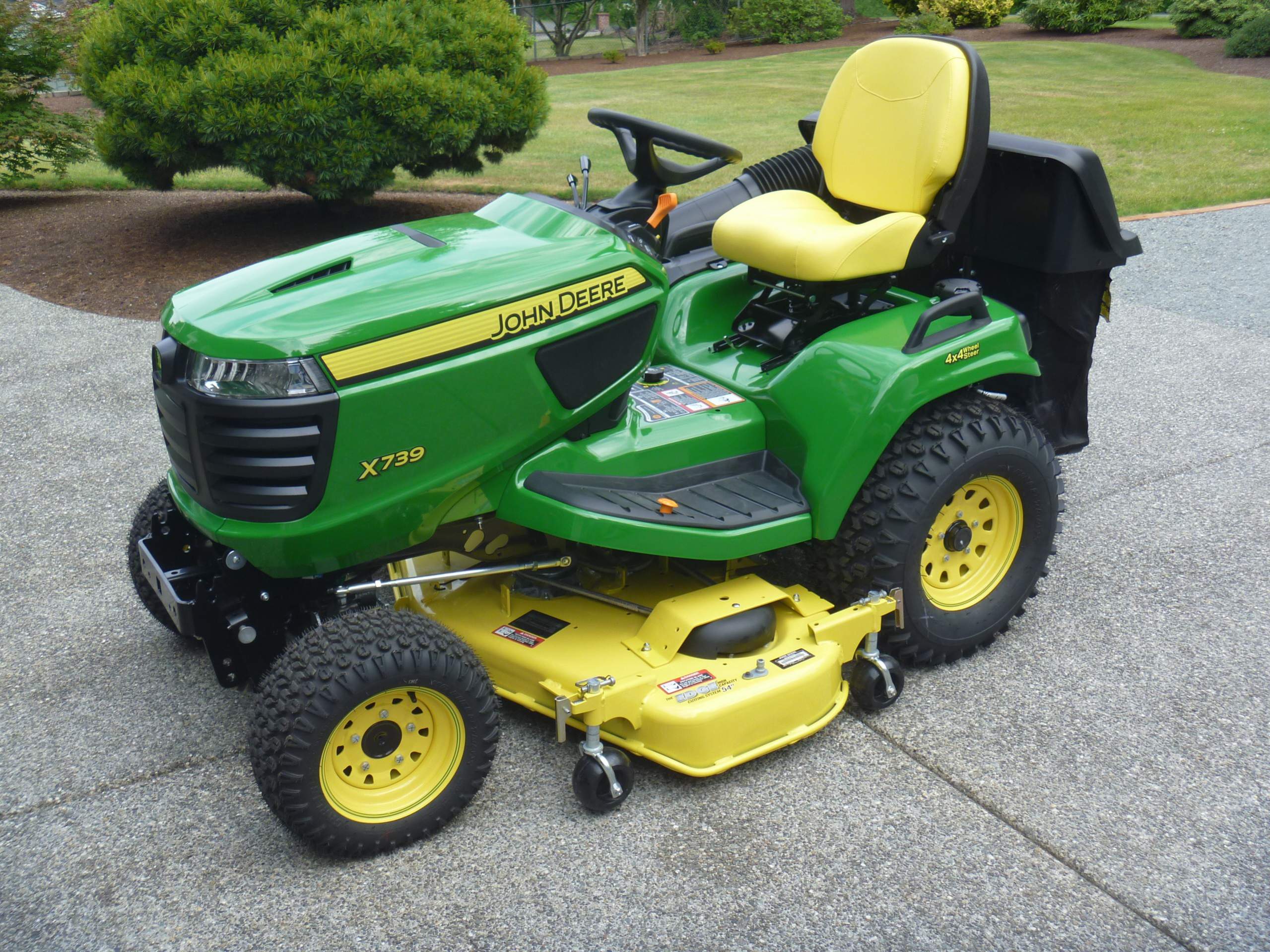

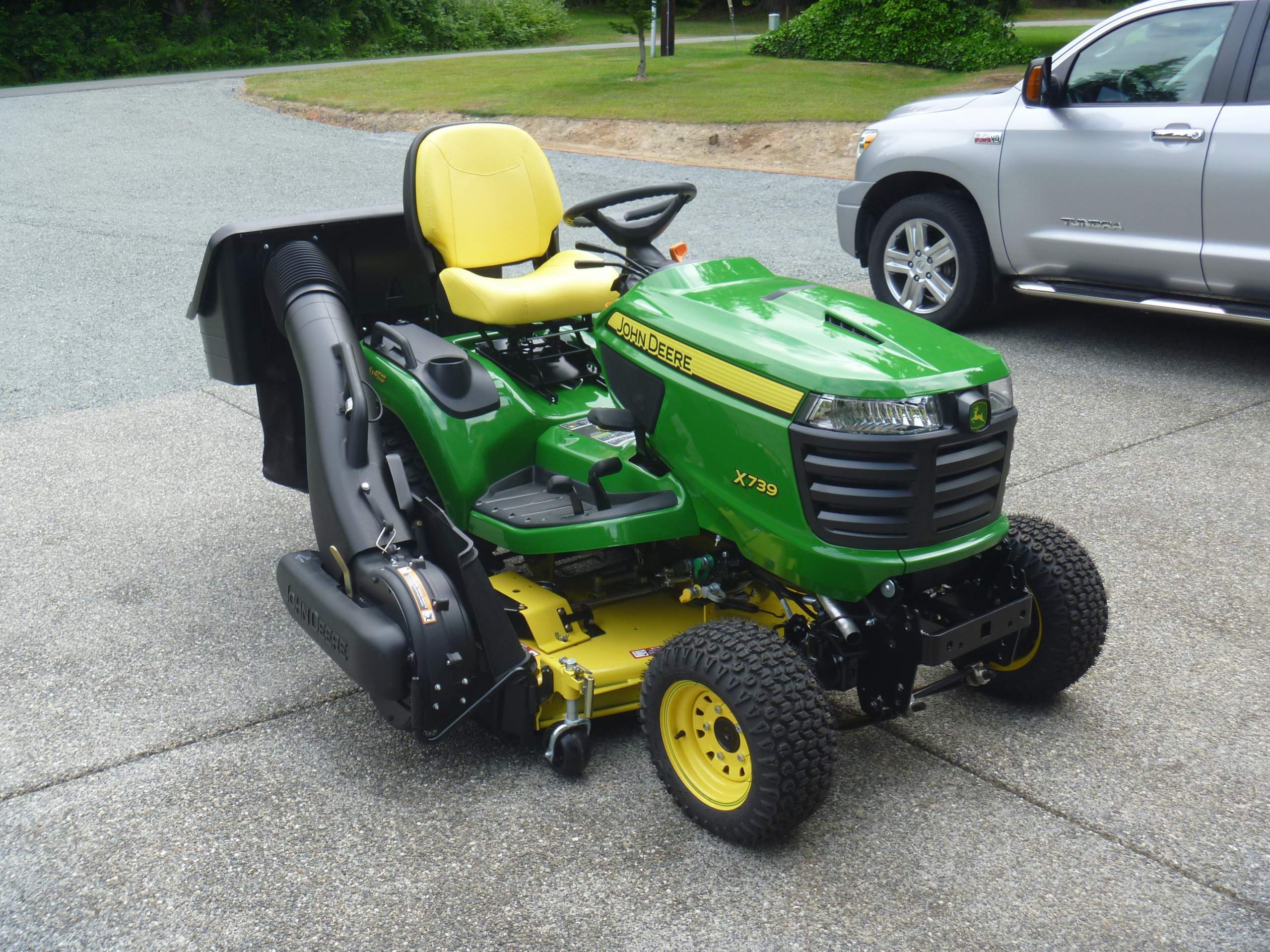

Just got my X739 last week but haven't mowed yet (rain) so can't comment on that aspect but just driving it around its amazing how tight the big beast can turn compared to way smaller 2 wheel steer lawn tractors. The all wheel drive is going to be great on my hilly bumpy terrain and while testing it on hard pavement could detect no front wheel binding on full lock turns so it shouldn't tear up the lawn like some small 4 wheel drive tractors might.
Didn't want another diesel so the X739 was perfect for me since I wanted AWD and AWS.
I went with the 54HC deck and power flow bagger.
Purchased mine in Mt. Vernon, WA.
