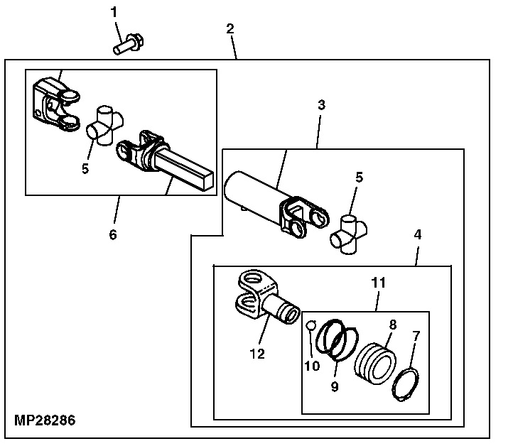

Hi All,
I'm new here and hoping to find some help with a problem. When I last went to remove my mower deck, the quick connect coupling would not come off the shaft. I wound up having to leave it on and remove the set screw and slide out square shaft from the quick connect end. A couple ball bearings fell from the quick connect.
Any tips on getting this off?
If it comes off can it be repaired or will a replacement need to be purchased?

I think they did used to make a repair kit for the quick couple on the small drive shaft. If you keep putting kroil penetrating oil, wd 40 or pb blaster on it or some sort of penetrating oil on it, it should come loose with a little bit of tapping with a hammer. There should be 3 ball bearing balls that come out of that coupler.

Welcome to TBN!
Are you sure it isn't still frozen? seems like winter does not want to let go around these parts!
anyway here is the parts picture, it shows a repair kit for that coupler. you may just have to
cut that collar off to make sure you can get the drive shaft off the pto without harming
the mid pto shaft or the housing around it.. there have been a few threads about similar
problems, and they usually don't end up well for the parts involved!
this only shows 1 ball in the coupler, it's probably 3/8" or so. do you see anything
damaged in the coupler? the repair kit is about 65$.

I had this happen with my tractor for several years before I gave up and bought the rebuild kit. There is a snap ring that holds the collar on. It is nbr 7 in the diagram supplied by Dutch445. We did what you did with the set screw to get the mower deck out of the way. Then we backed the tractor up on some car ramps to get better clearance. My brother was able to move the collar back enough using strength and some prying with a screwdriver. It wouldn't release the pto shaft to slide off, but he could get to the snap ring with a small flathead screw driver and pop it out. At that point, the end fell apart and easily came off. We reassembled everything and it appeared to work fine and was able to reinstall and use again next spring. The following fall I had the same problem. I then used bought the rebuild kit. Hope this helps.
   / X585 mid pto shaft problem #7
I am pretty positive there are 3 balls in there. Look at the parts quantity. It only shows one in parts but the parts probably shows 3. Until you get those other balls out of the groove it probably won't release. You could do the same as the other gentleman and pry the seal ring off or you may be able to rotate the shaft with the tractor off and get the balls to fall with gravity. The balls rattle are and they shrink with age from all the vibrations. All the steel builds rust and the balls can fall out into the collar and bind it up

Thanks Guys,
That info was helpful.
I'll buy a repair kit or a whole new part before I remove it.
