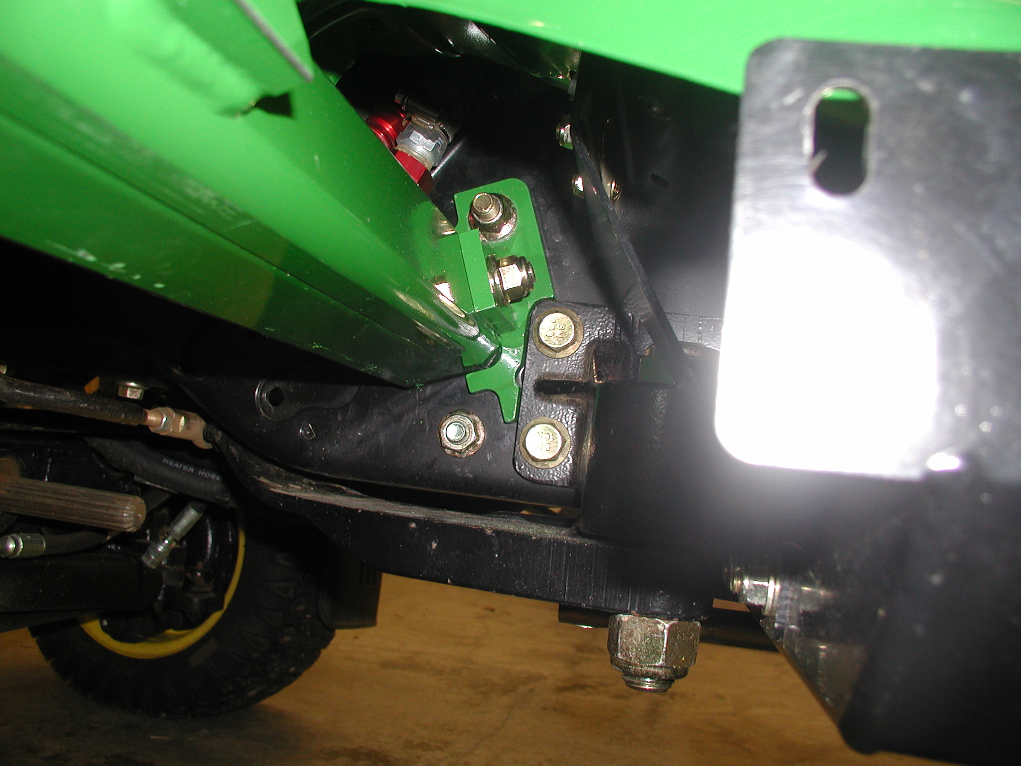

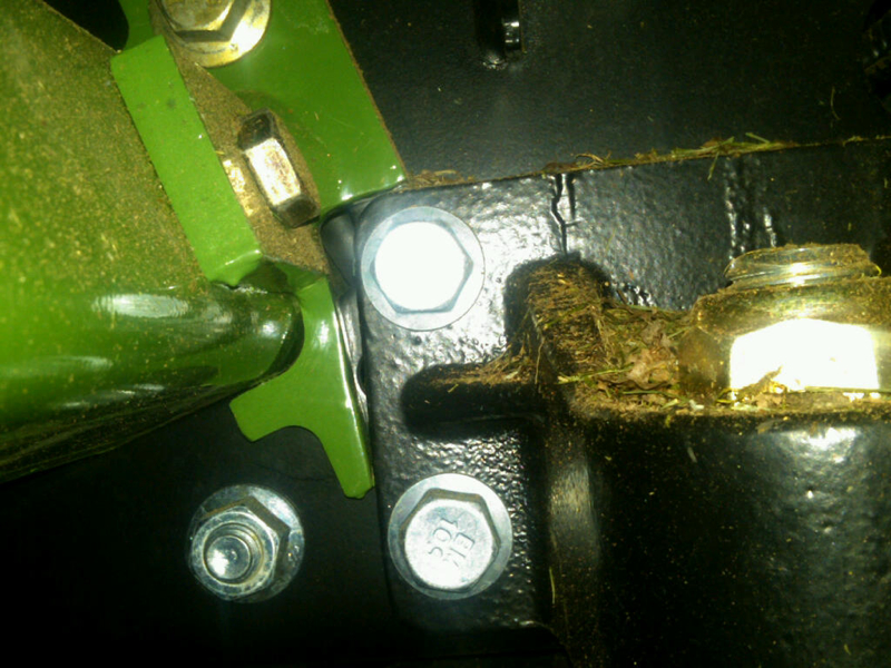

Two details to note, there is an interference on the frame for the rear support of the 45 FEL ((left side). The hydraulic pump is 4.5 gpm where as most of the X Series is 6.0.

It's a minor interference with the rear steer bracket that has an easy fix.

Did you modify the bracket and eliminate one of the bolts?
Did you add any shims?
   / X724/744 and attachments #8
I modified the bracket, but did not have to modify the 4WS idler arm bracket. I shimmed the hydro to 1250 psi. Works great.

Again, inspired, your modifications look better. Ordered shims and gauge today. Picked up six weights yesterday. Just call me Tommy Jr.

Yes, wish I had the shims while I was under there. Expected delivery this week.
