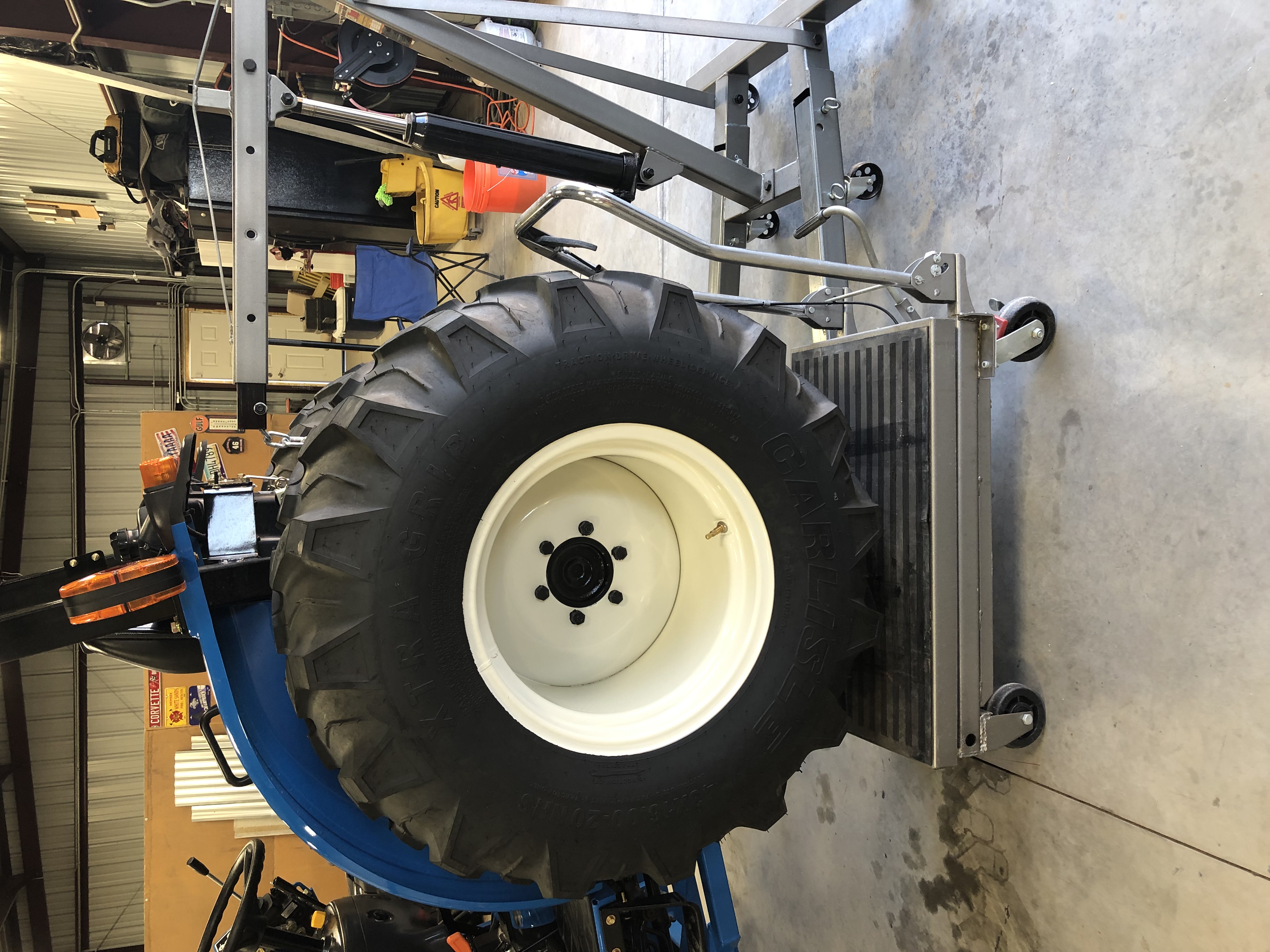

First steps is to jack up the right rear of the tractor and place a jack under the axle. My pictures show the entire rear end of the tractor up on blocks. This was due to my rear main seal go bad on my left hand side final drive casing. I did a complete write up on that repair, you can check that out.
Next step is to take the tire off as it is in the way. To do this without possible injury is to have a platform jack rated for 1000lbs. This is what I used and you can see in this picture.

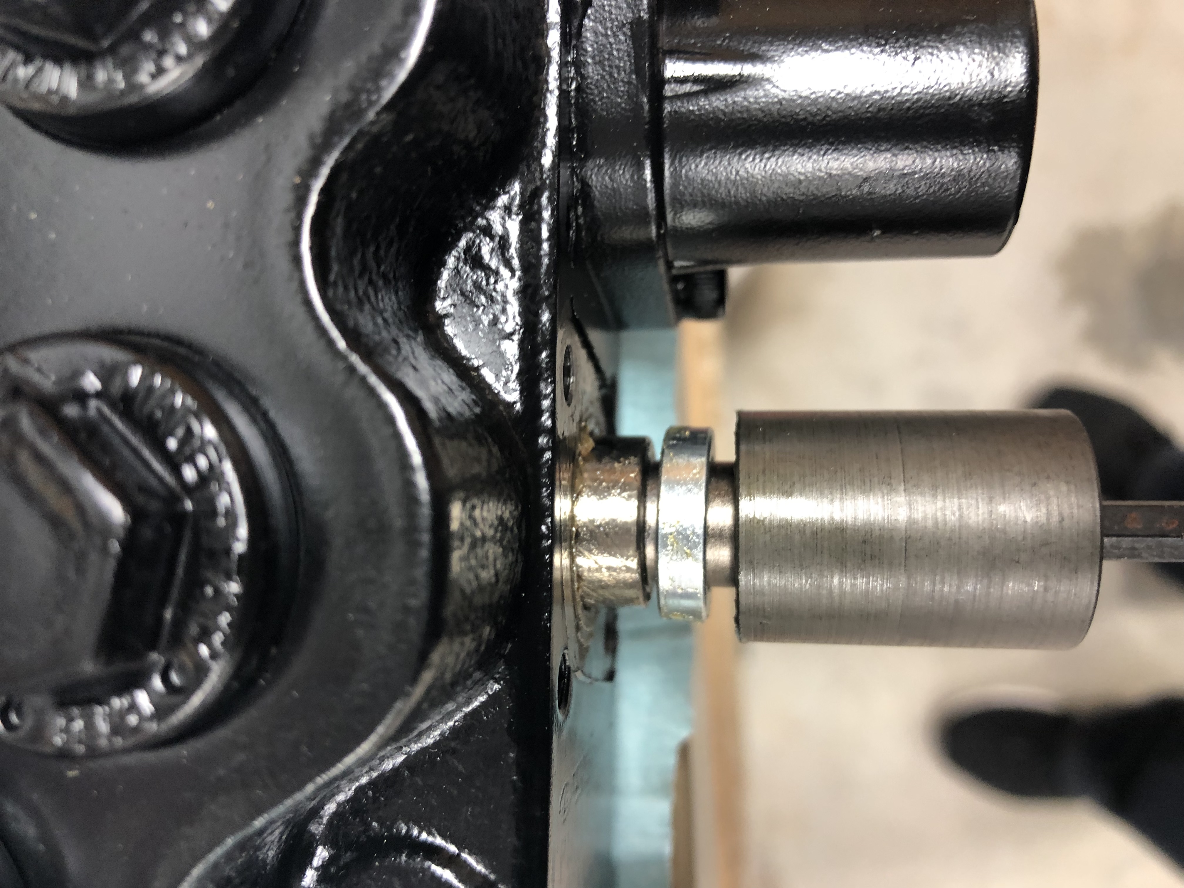

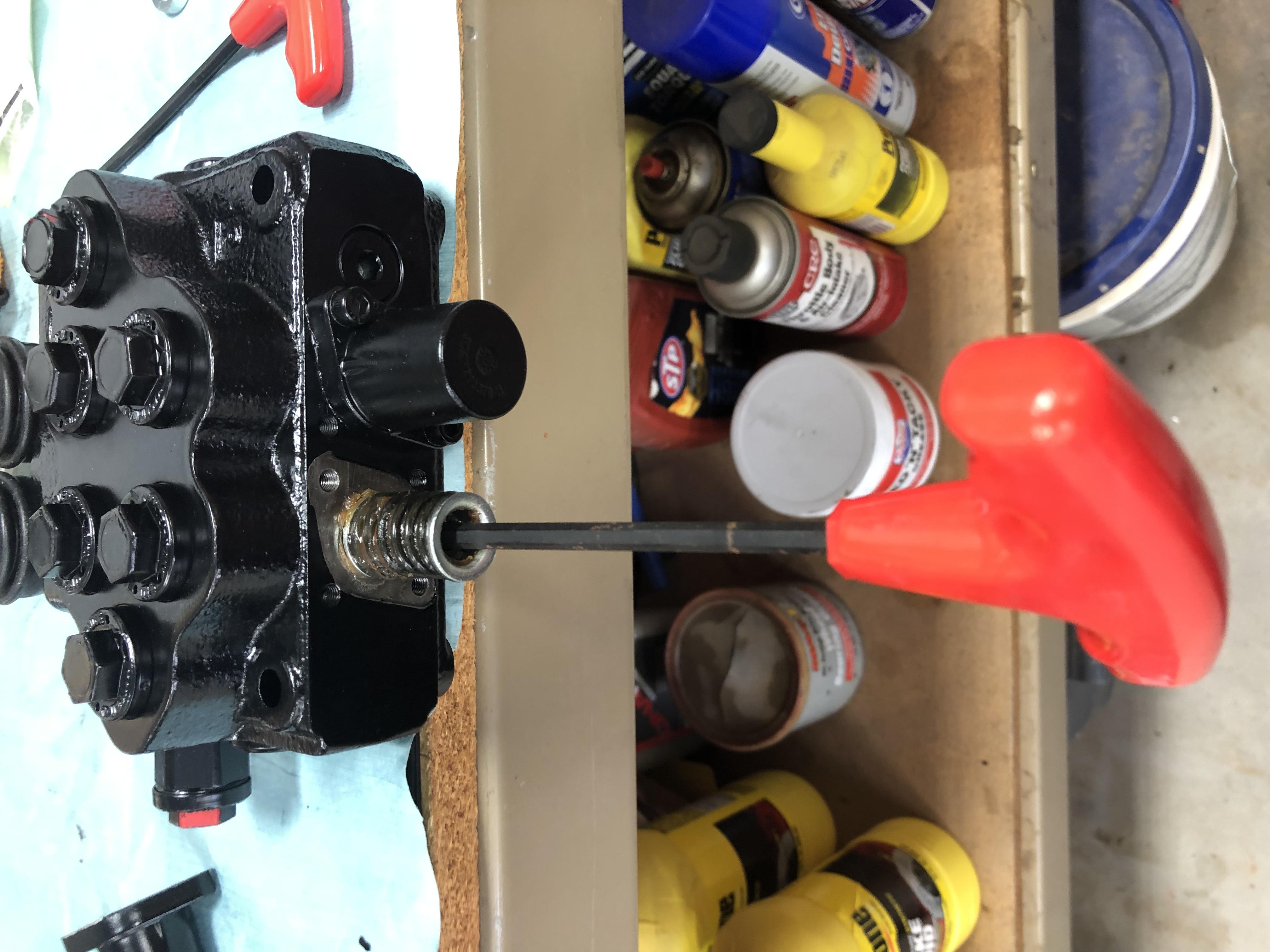

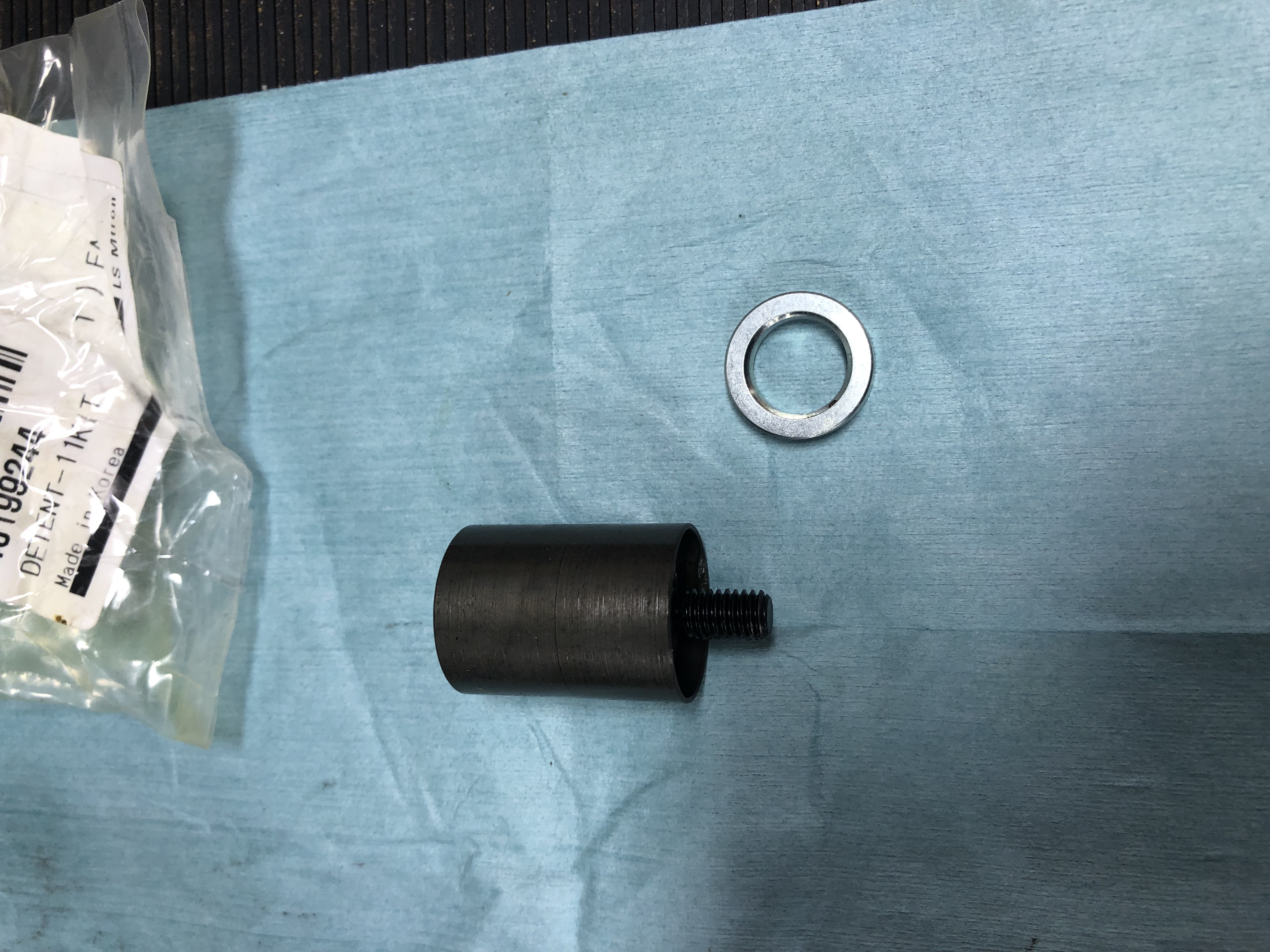

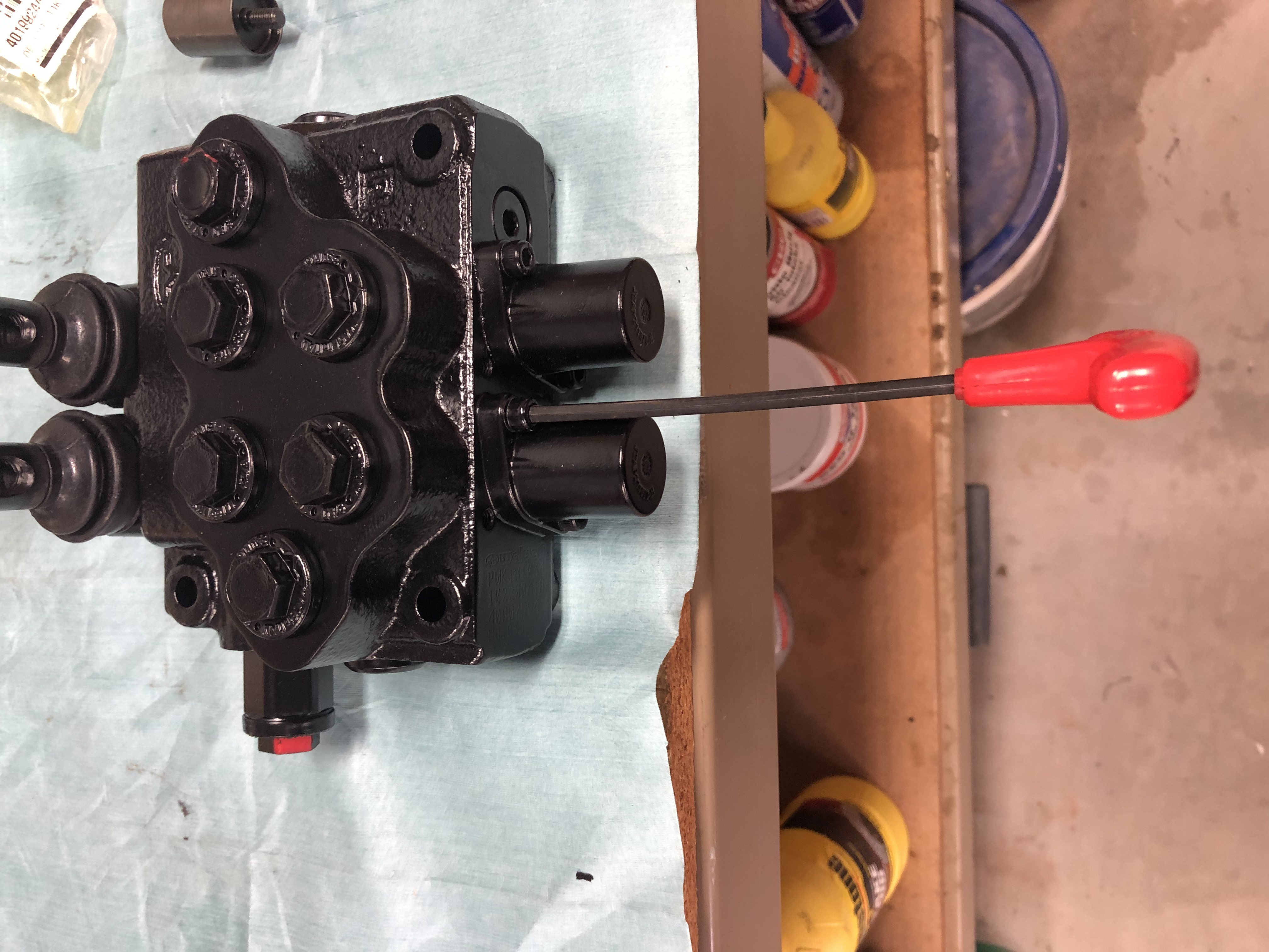

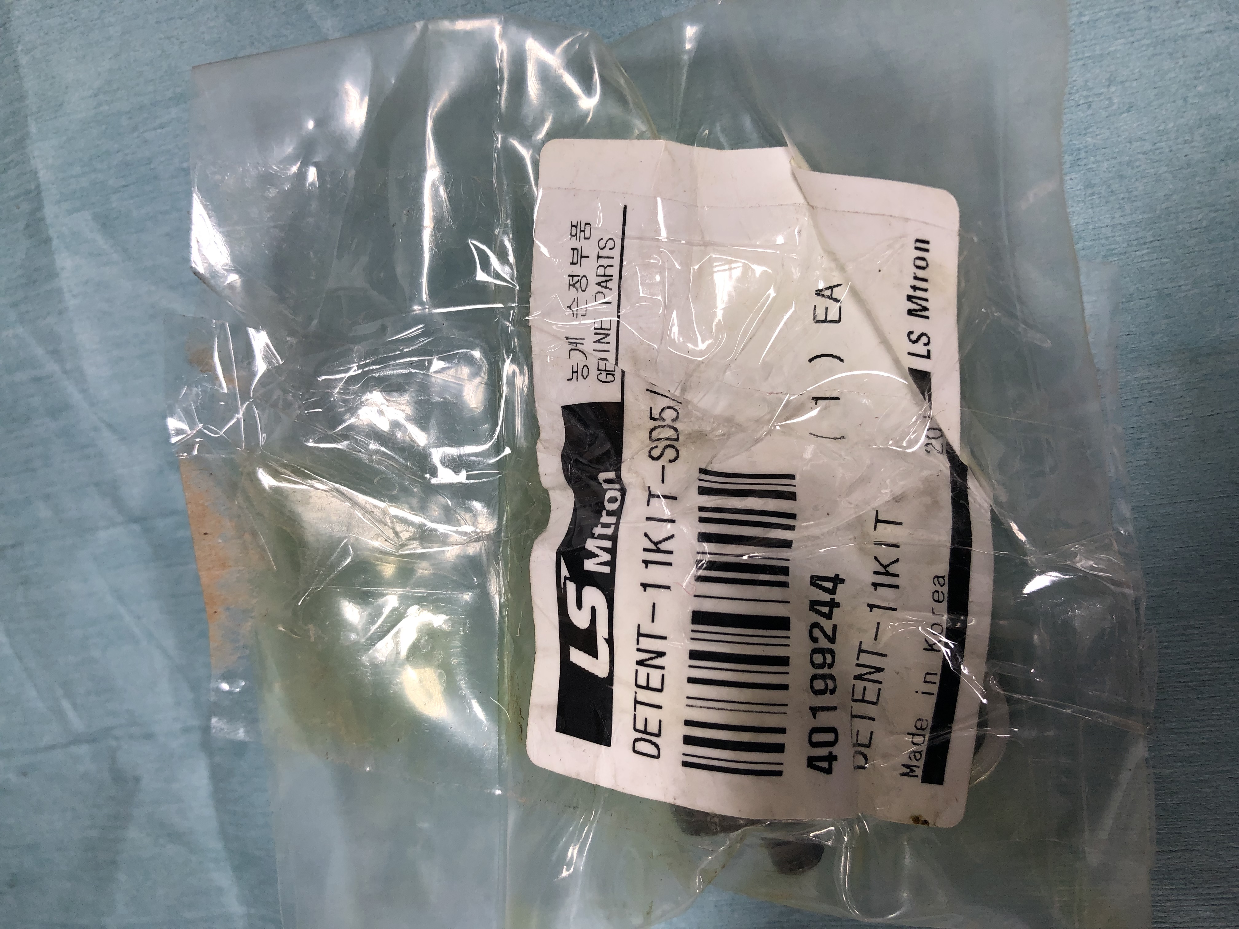

1st step is to take out the double rear remote manifold. Since I have the backhoe, I ordered the "detente" kit which is a MUST and I feel when you purchase the backhoe, this system should of come on the tractor from factory. You can install the detente on either valve, I chose the inner valve as it is closer to the seat. Good news is if you want to switch it to the other valve you can with not to much hassle down the road. The detente cannot be confused with the auto spring installed. Even after you install and possibly forget which one you installed it on, you can move the lever and you will find it real quick.
After taking out the two allen head bolts, to get the spring off you have to use a bigger allen head to take off. Than install the new Detente valve with the aluminum spacer like this.

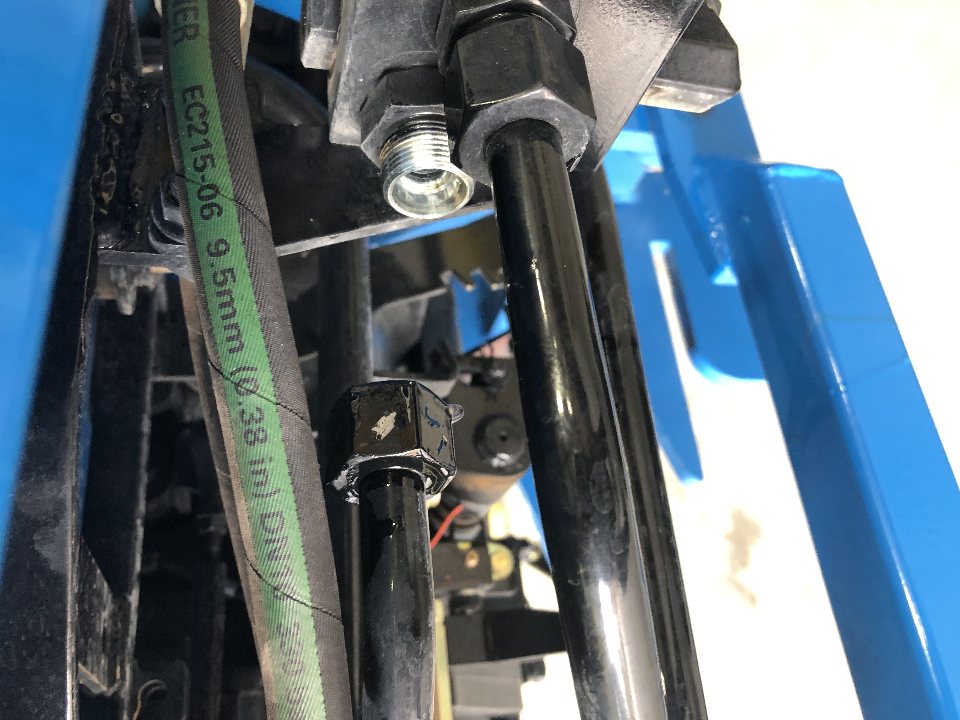

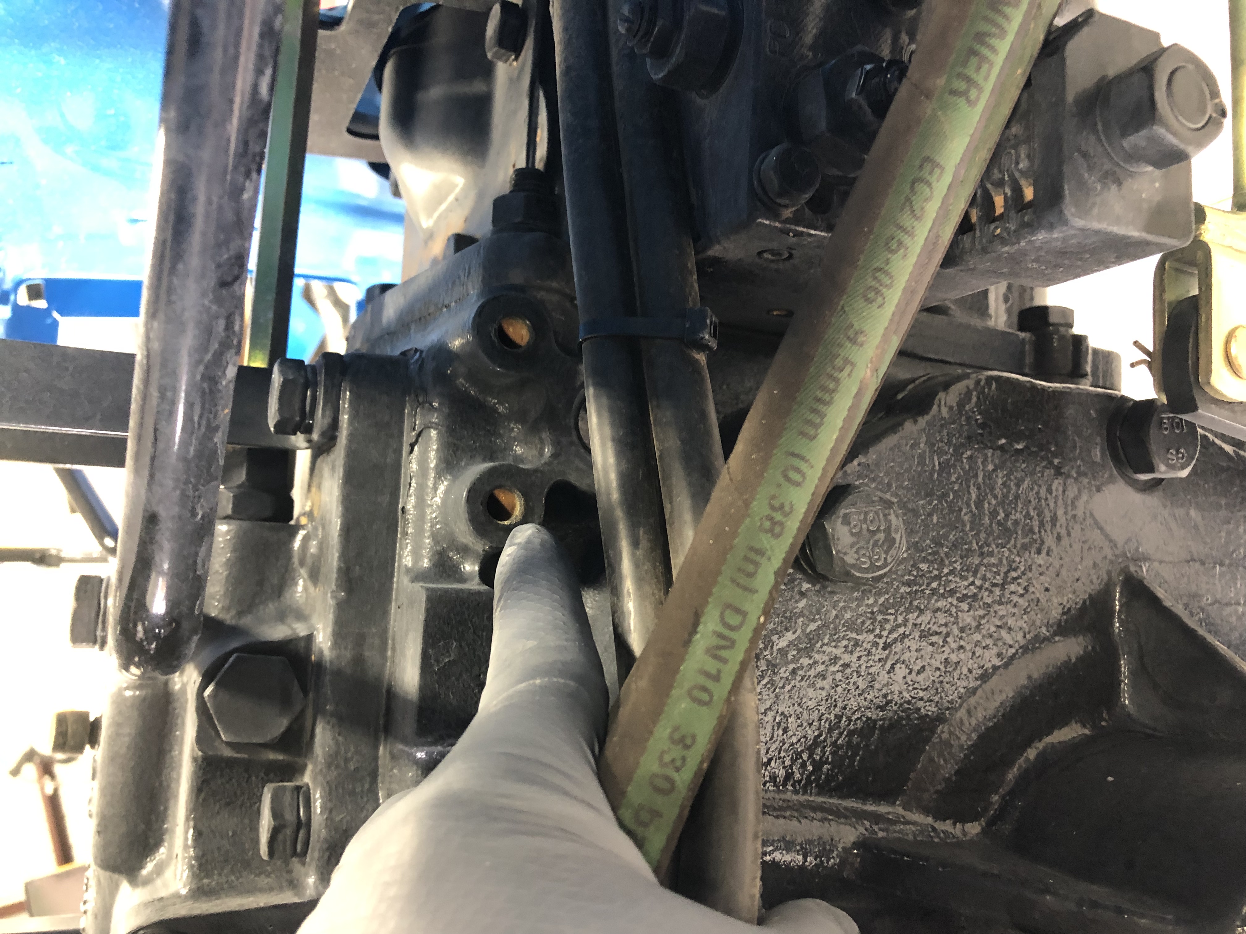

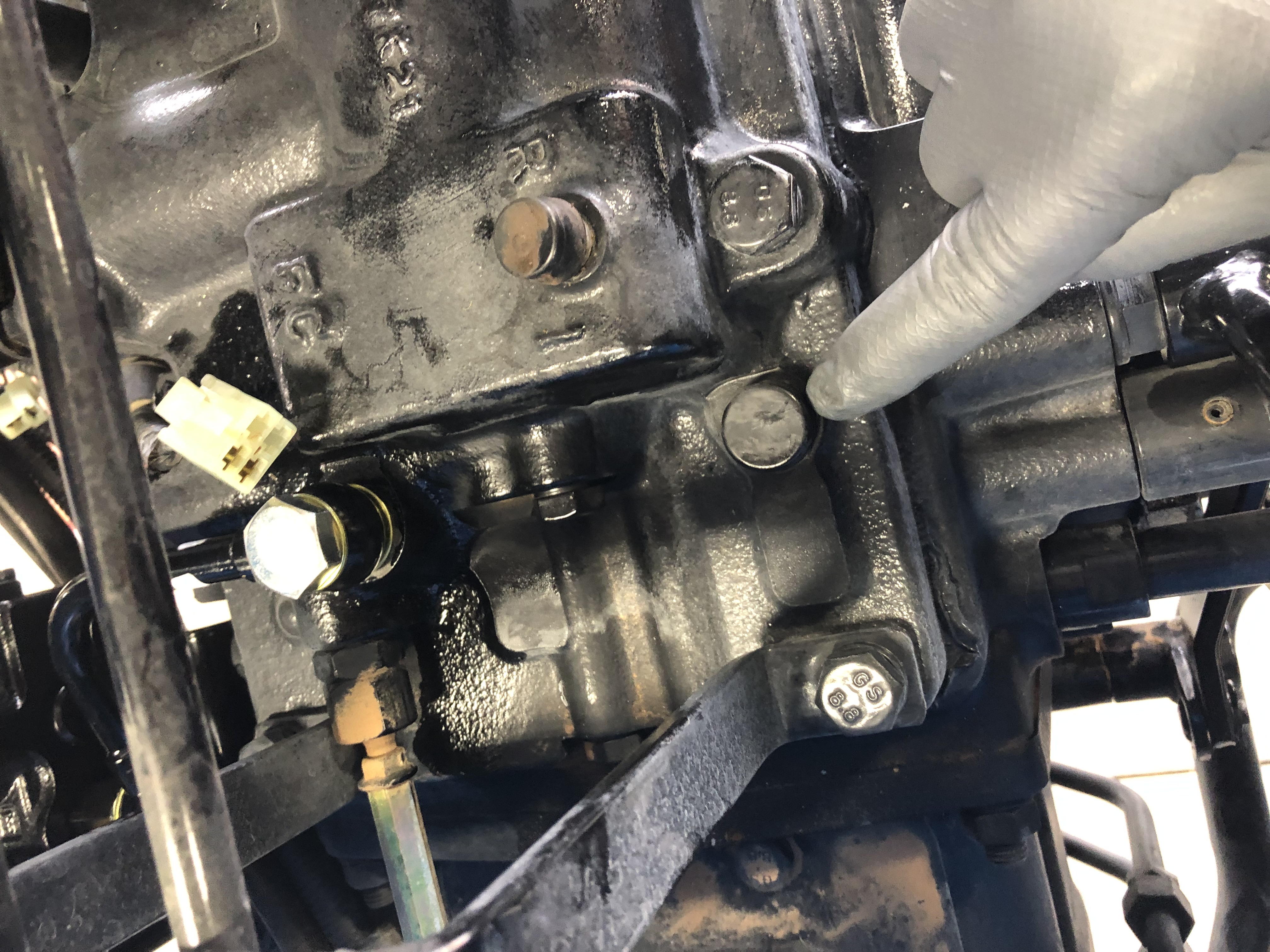

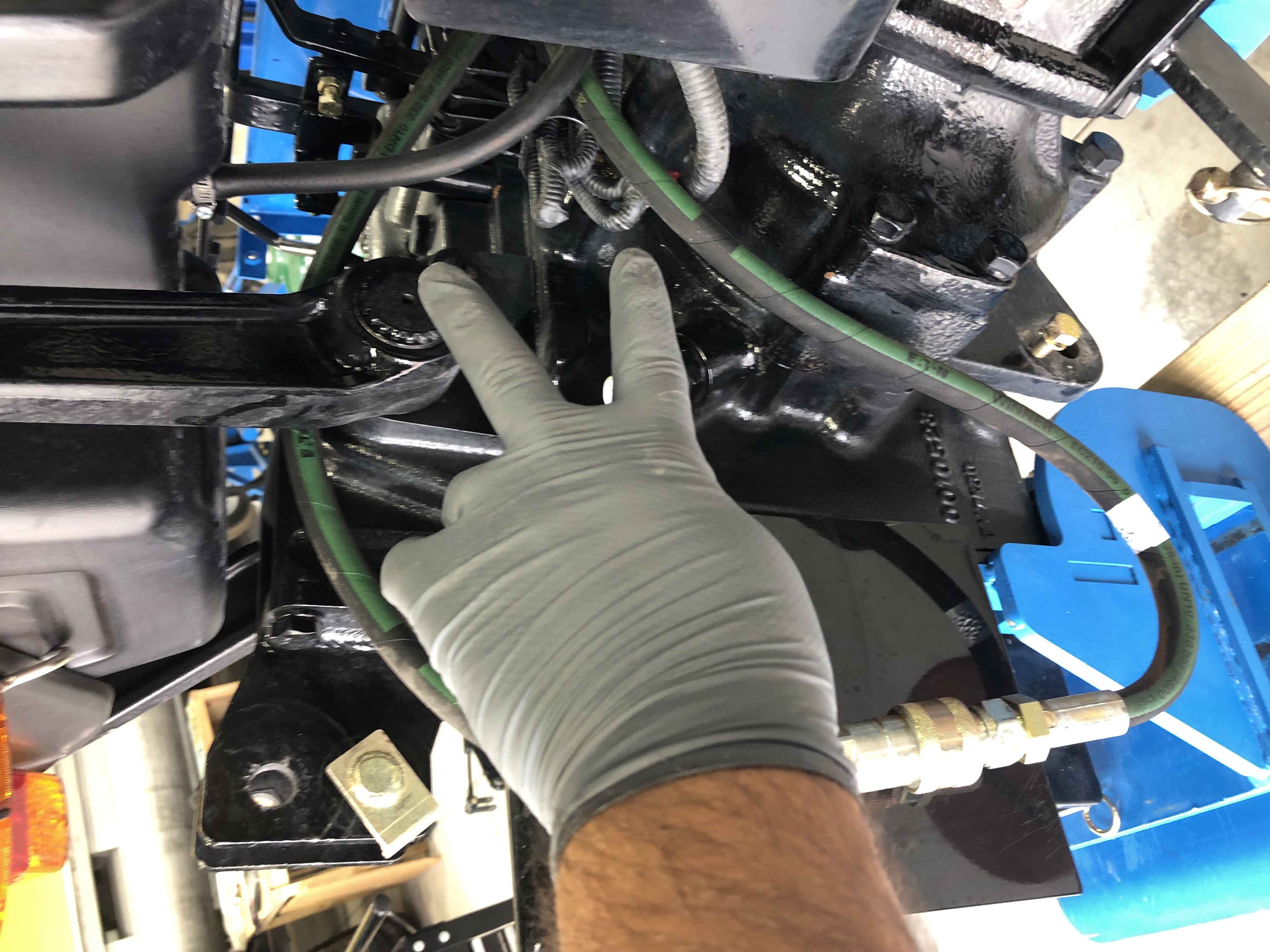

step 2. This part is for anybody who has the FEL installed on your tractor. The FEL block is underneath the step platform outside of the forward and rear peddles. The block will have a banjo hard plumbed pipe going from the FEL block to the top of the transmission. This pipe has to come off and make way for the valve manifold.
To do this you will need a 7/8 wrench or socket to take off the banjo bolt on top of the tranny. Once this is done you will need a 27mm wrench to loosen and take off the block connection.

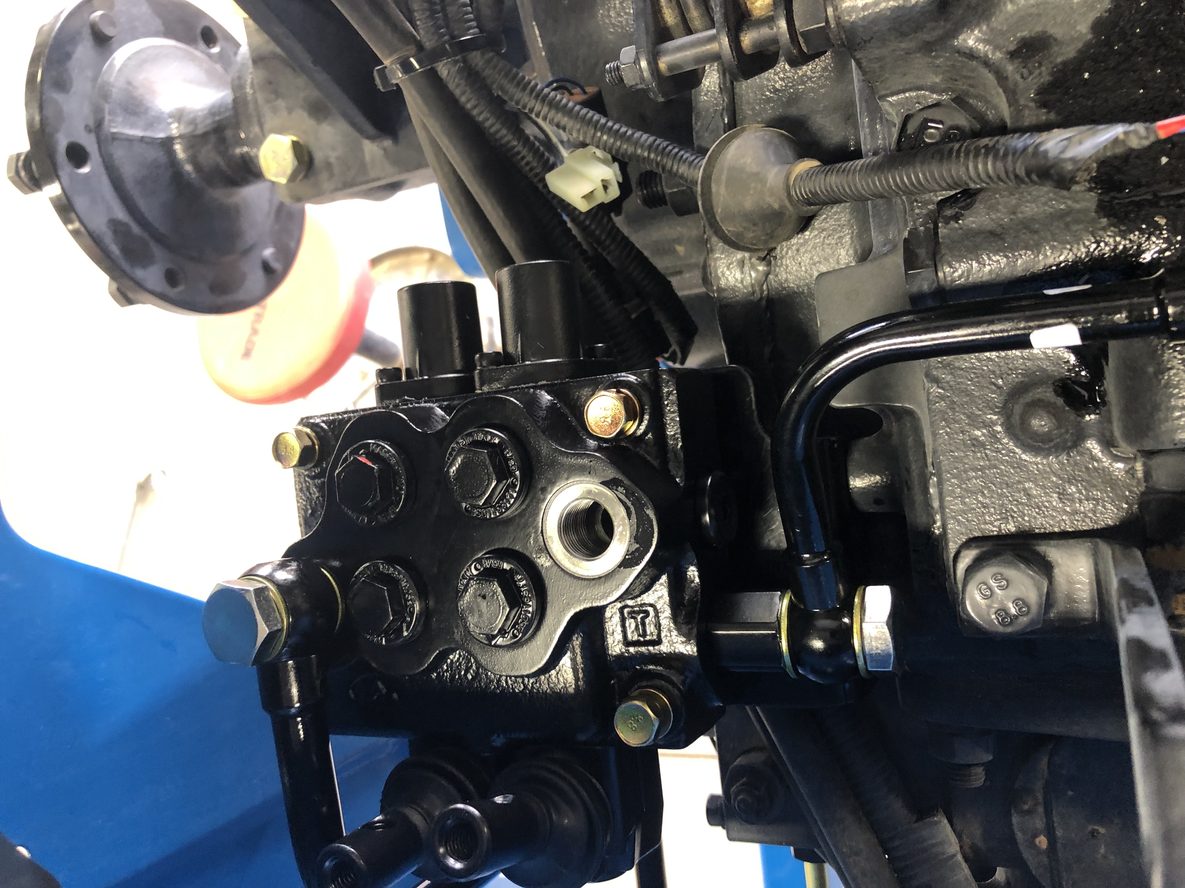

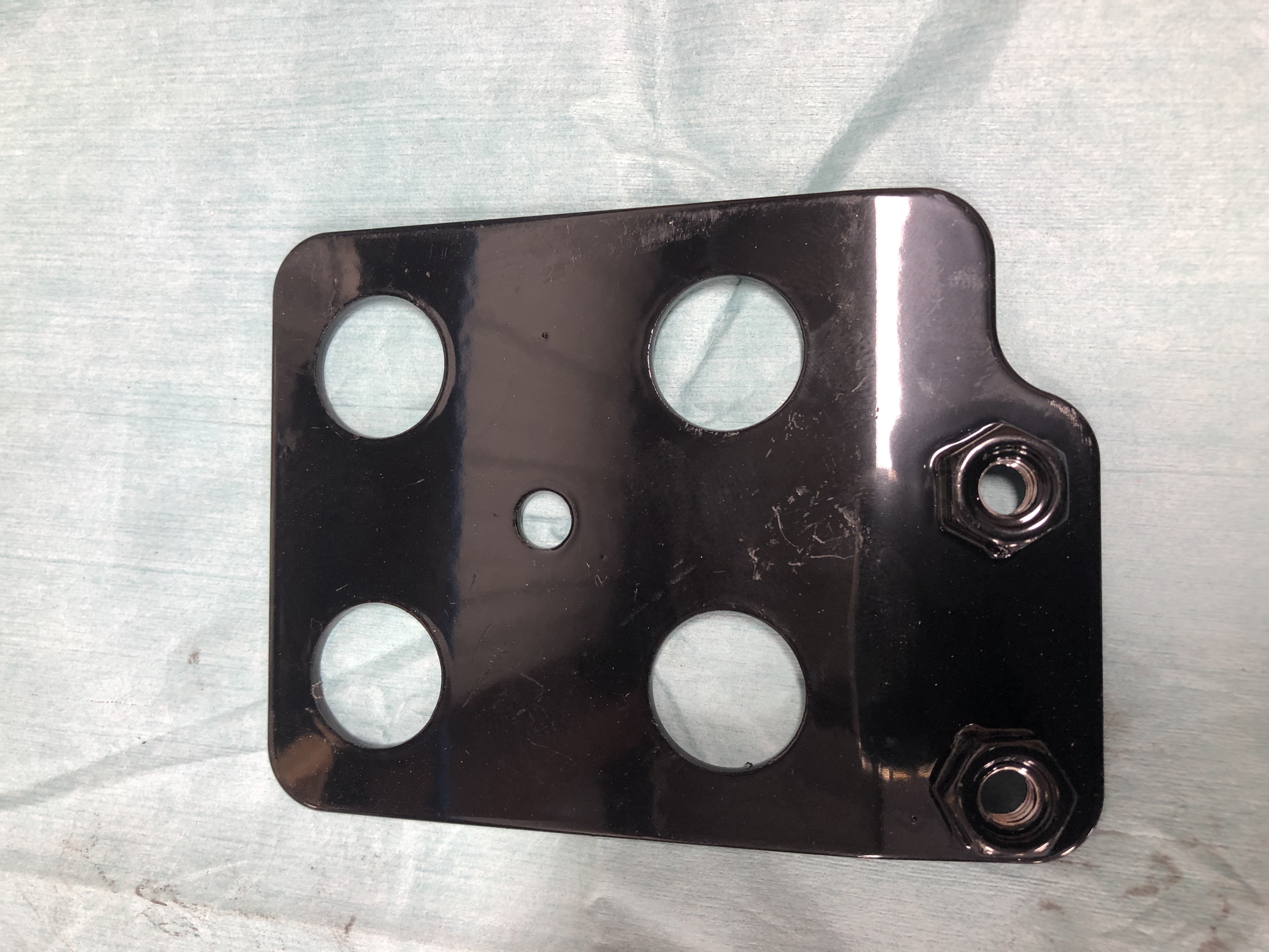

Once that pipe is out of the way, you can now bolt up the mainfold base plate to the side of the transmission box. The two holes are already there and I have pointed them out.

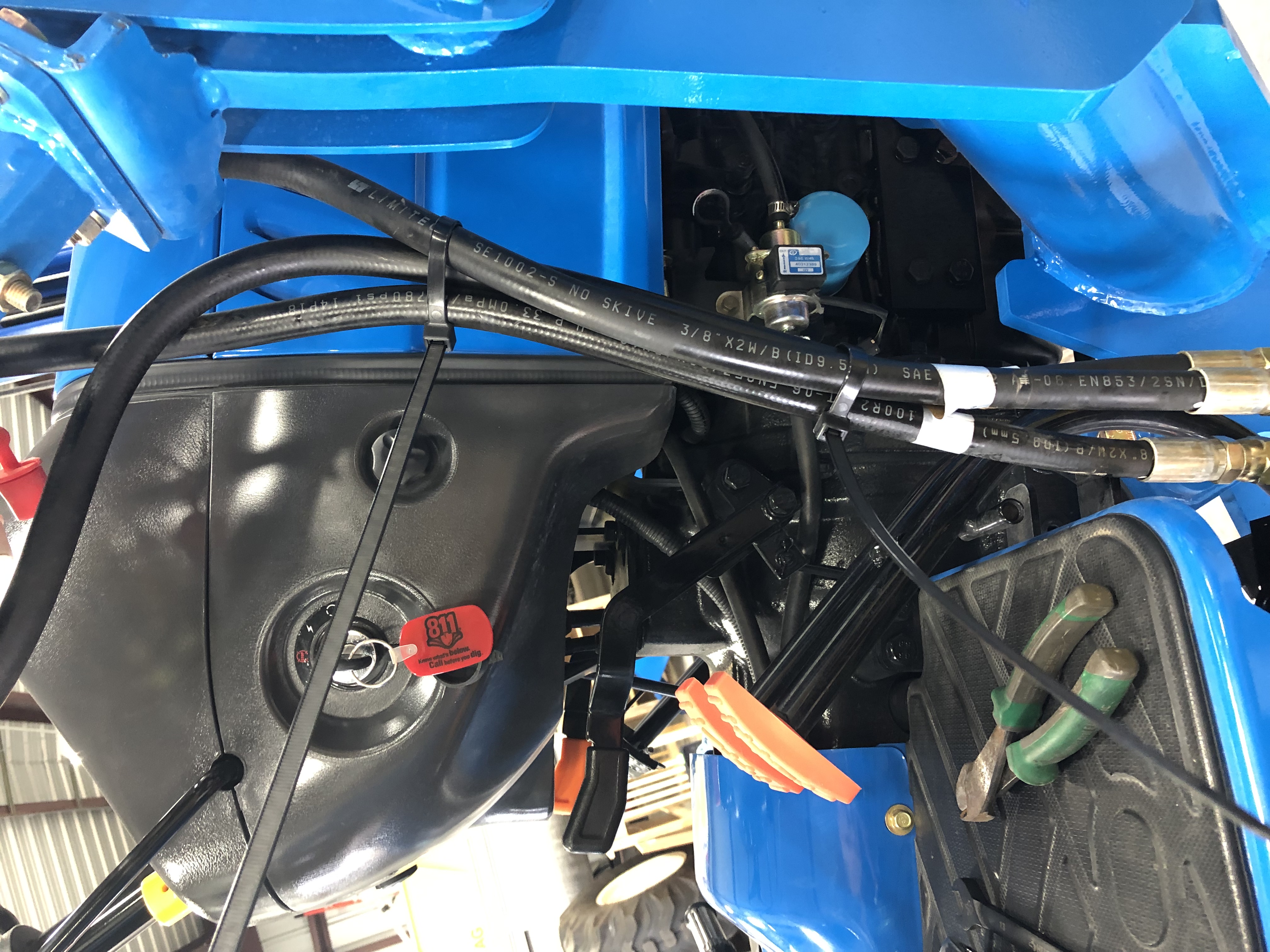

The factory installs two hoses for your backhoe. One hose is hooked up through your joystick on top.
The second hose is hooked up on the FEL block down below.
This leads me to my grief with this kit. The kit does not give instructions on taking these hoses off, NOR does it come with the two plugs you will need in to replace with once you take the hoses off. I have to go into town tomorrow morning to pick them up. Once I do I will add what they are in detail.
Here you can see how the two hoses look through the side and the rear of the tractor. Mickey Mouse if you ask me.

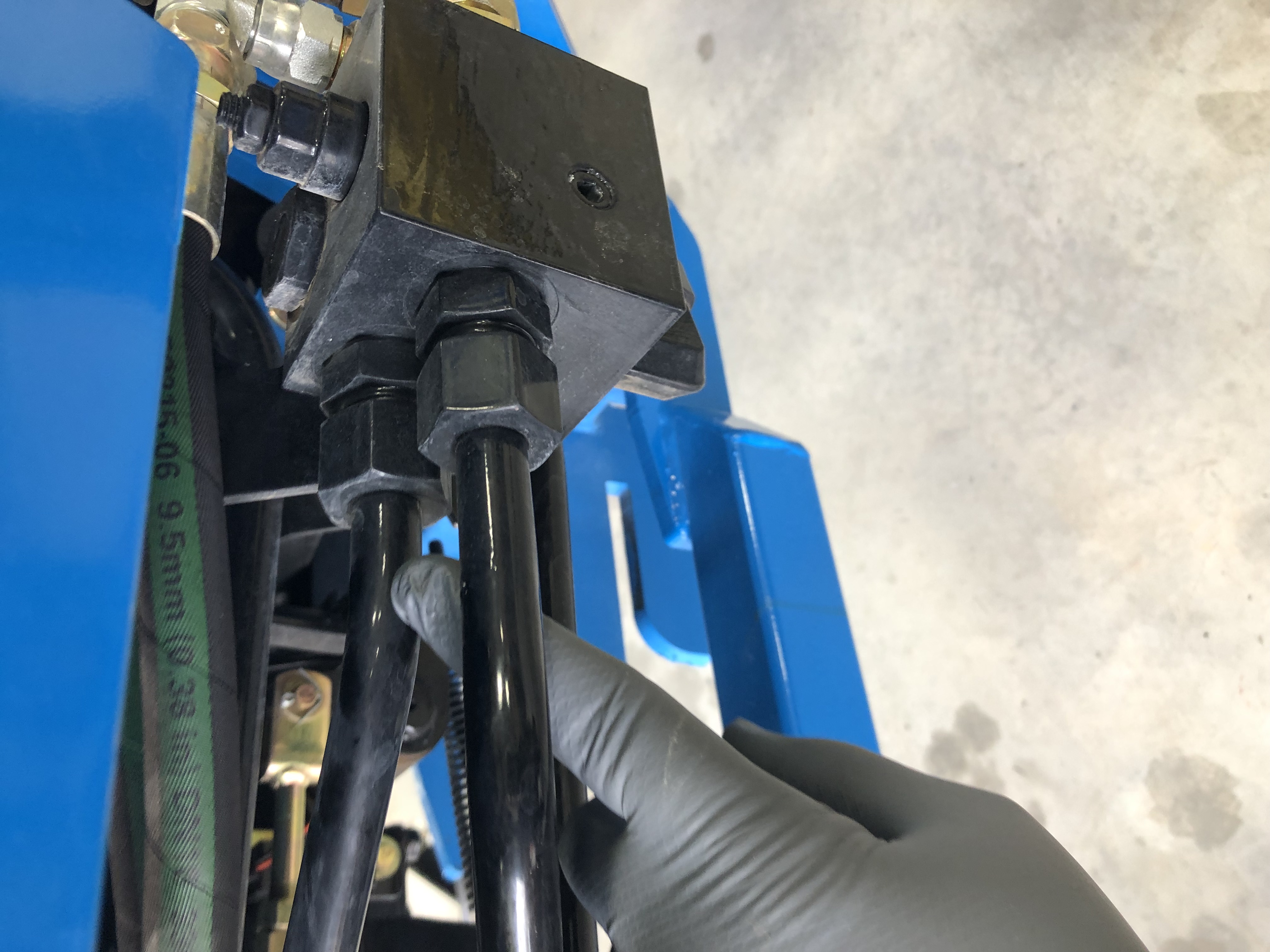

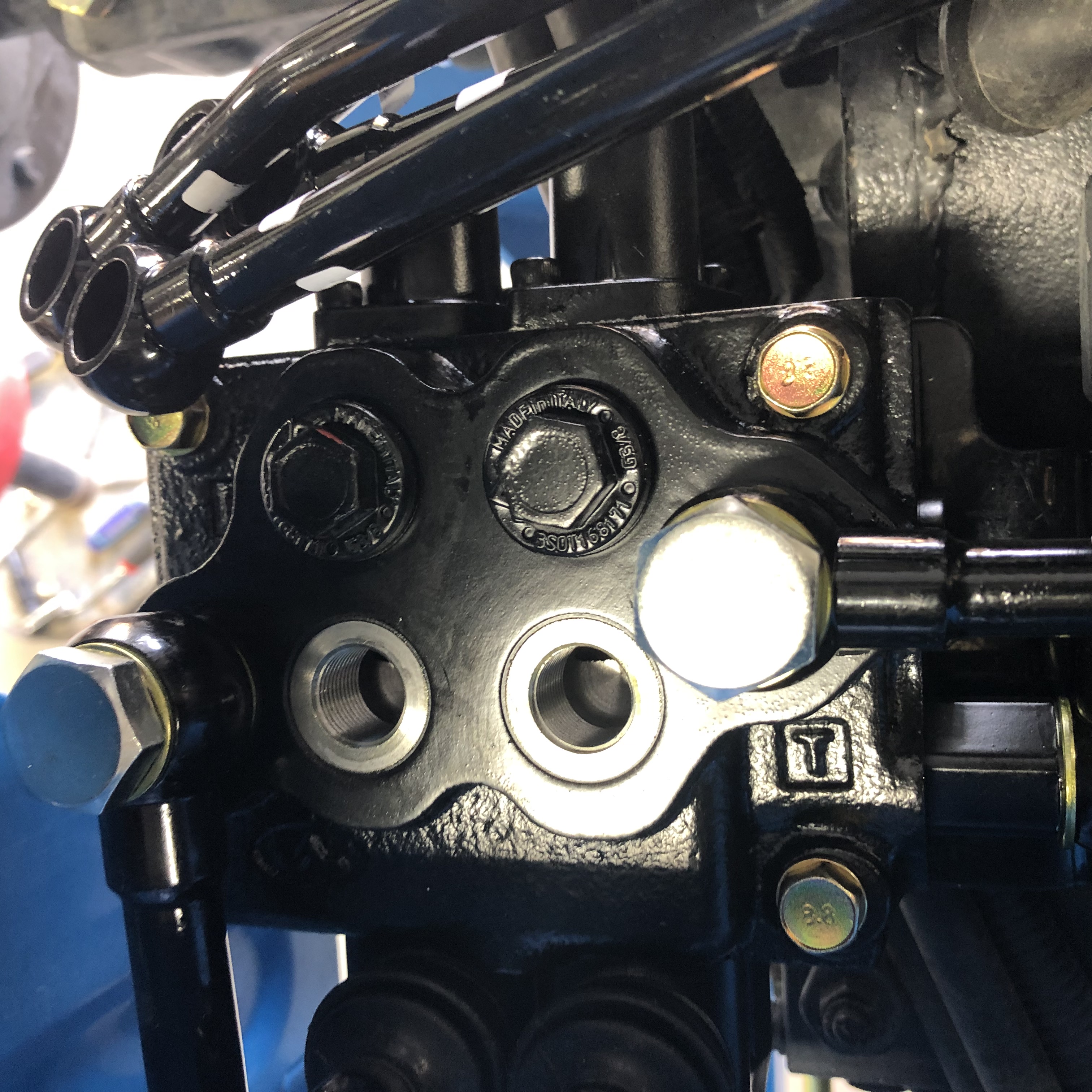

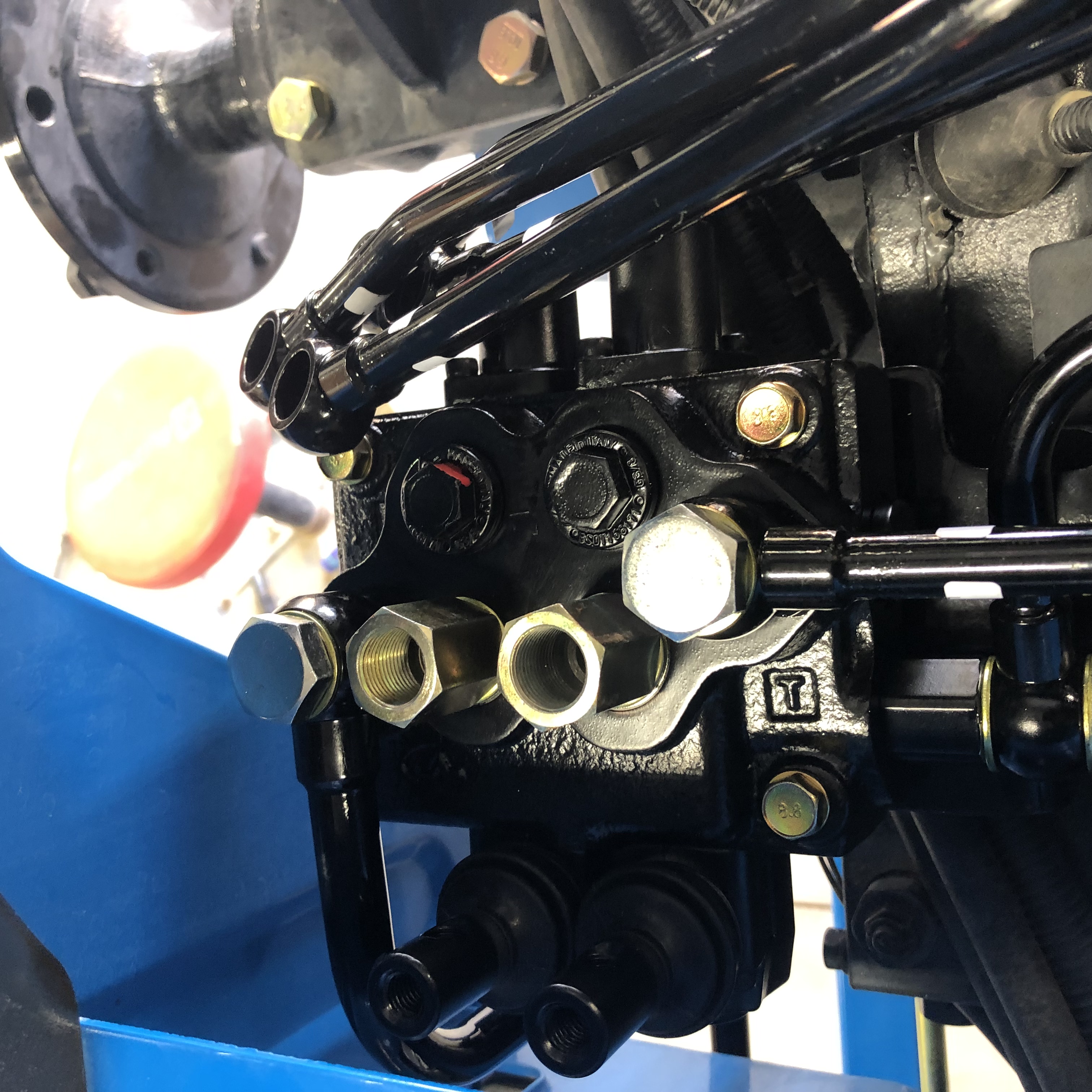

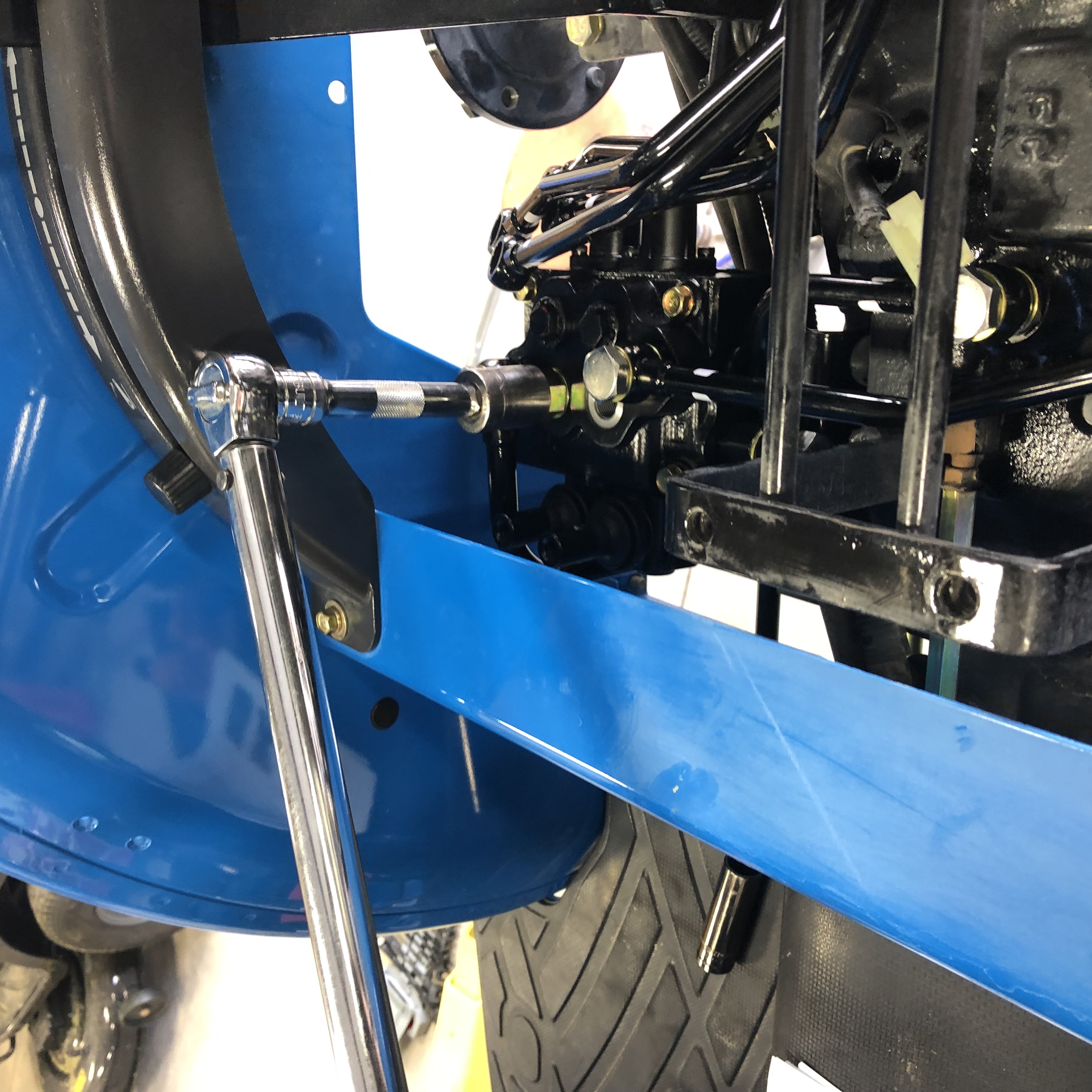

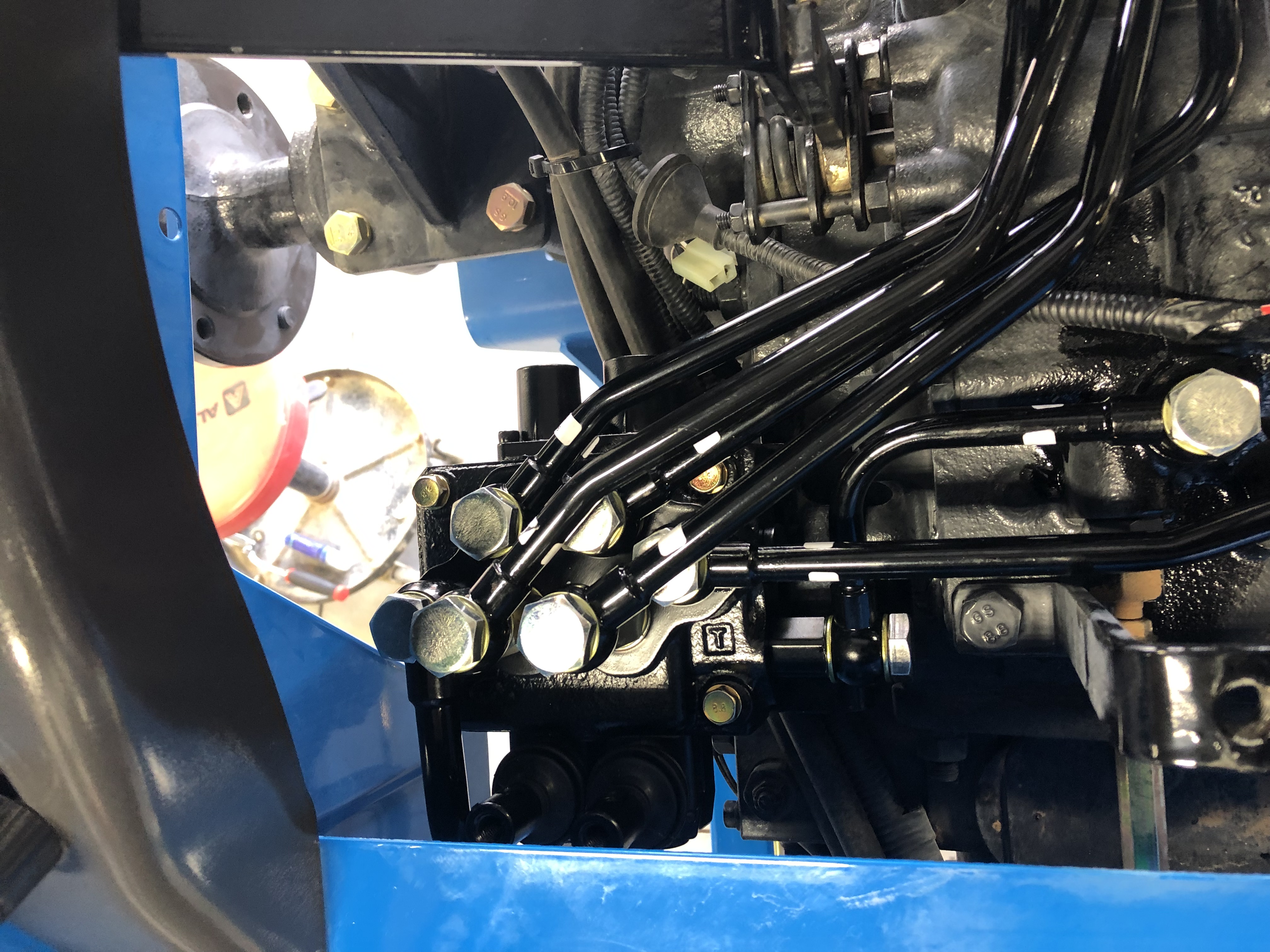

step 4. Install new dual remote manifold with the included 3 bolts. Do not tighten them right now. Once that is installed you can now install the new main supply line from the bottom of the FEL block to the dual rear remote valve body on the top left. ALL BANJO FITTINGS will have two copper rubber orings. One on top of the banjo and one on the bottom. Torque to 20 foot pounds on ALL Banjo connections.

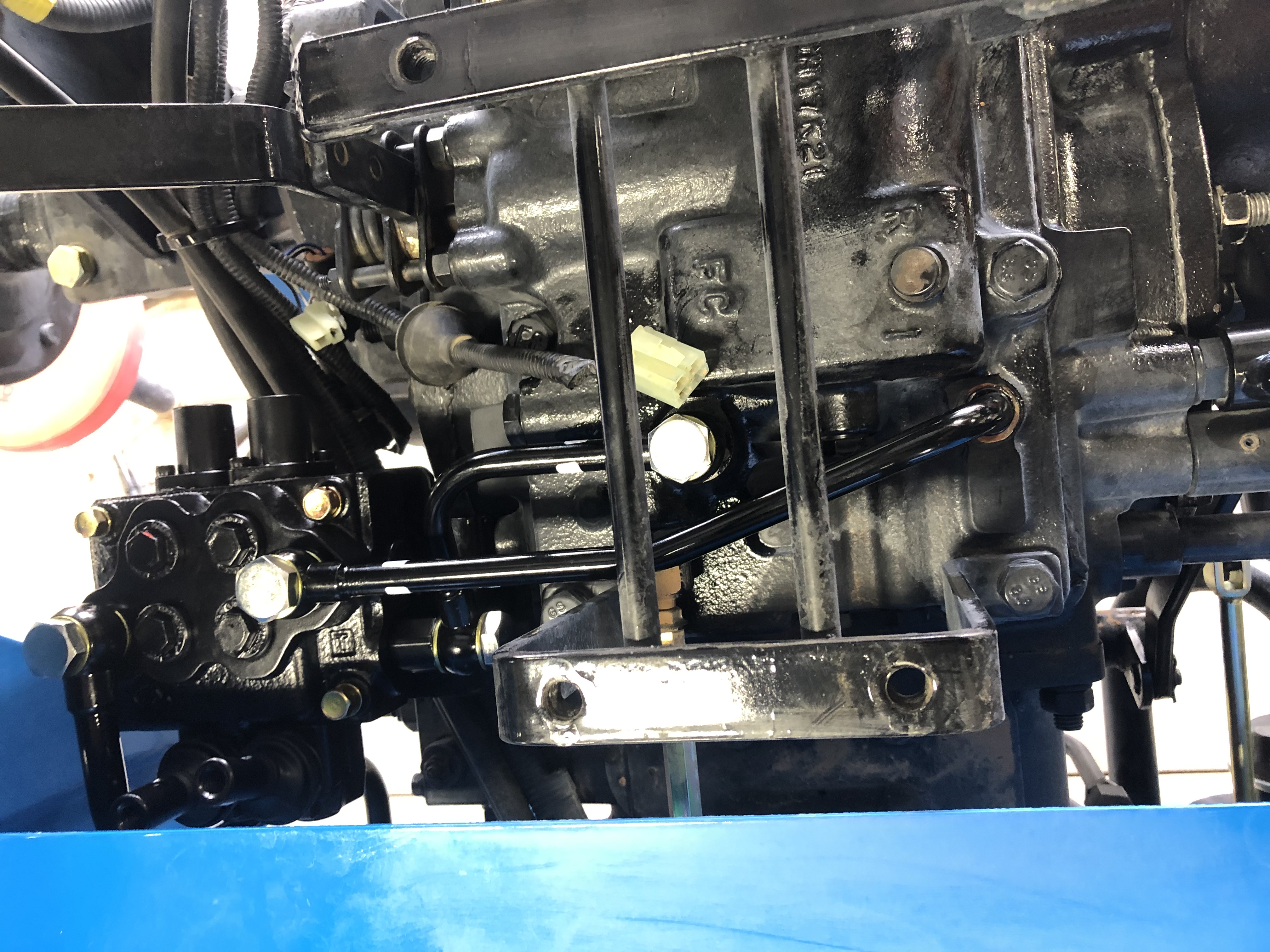

The next item is the over flow bypass that connects the manifold to the return to the tranny connection we took off that banjo line.
You will want to connect to the manifold before connecting to the tranny.

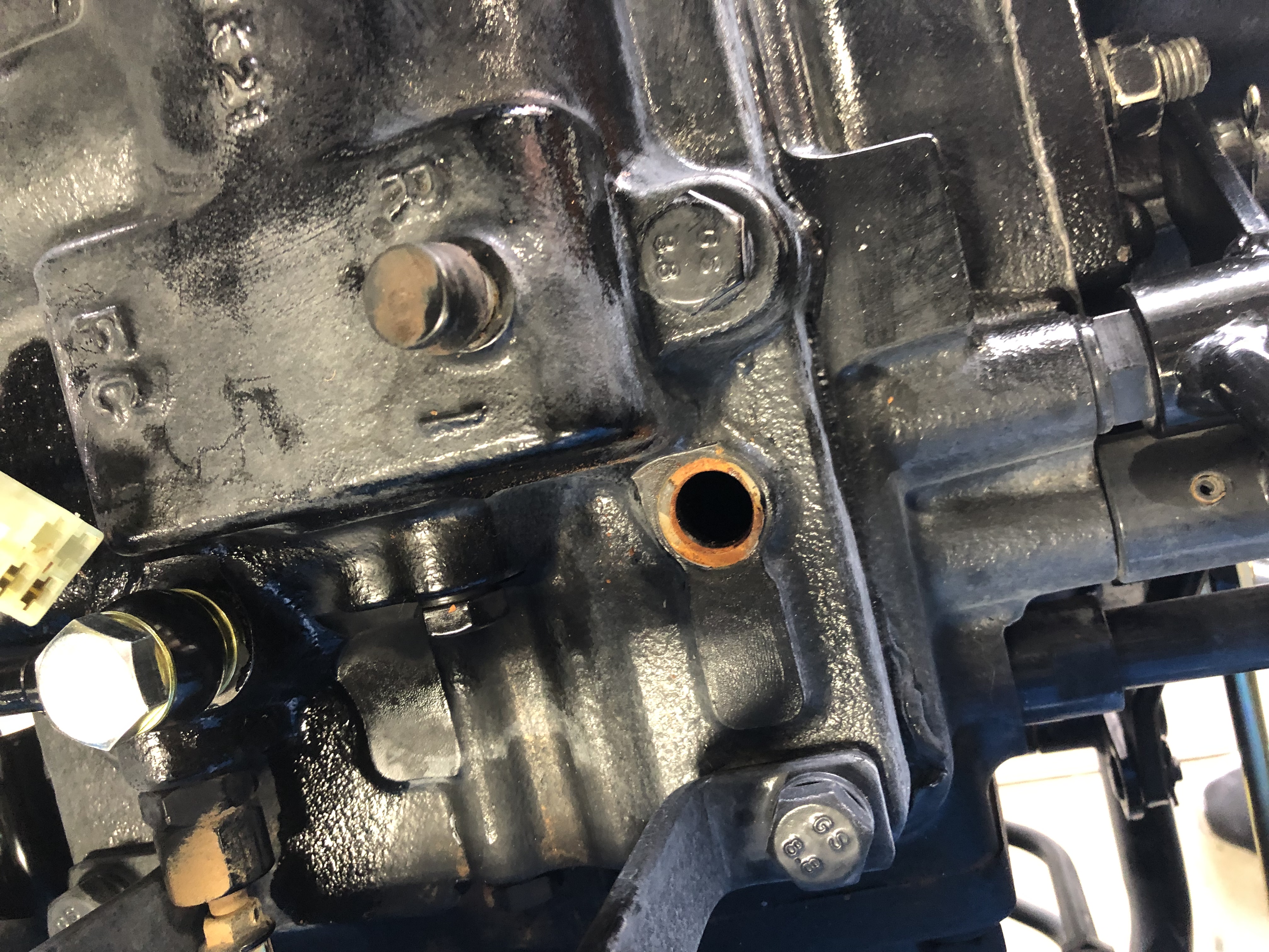

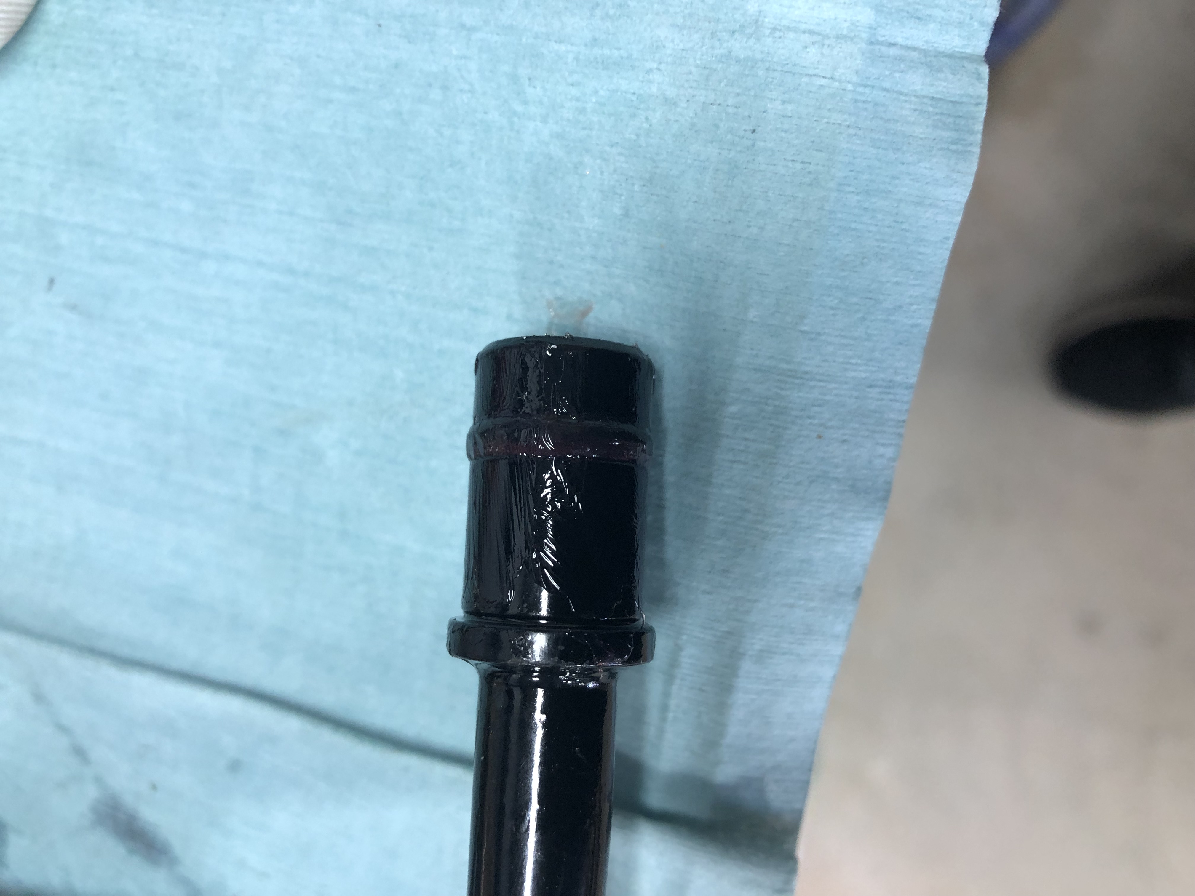

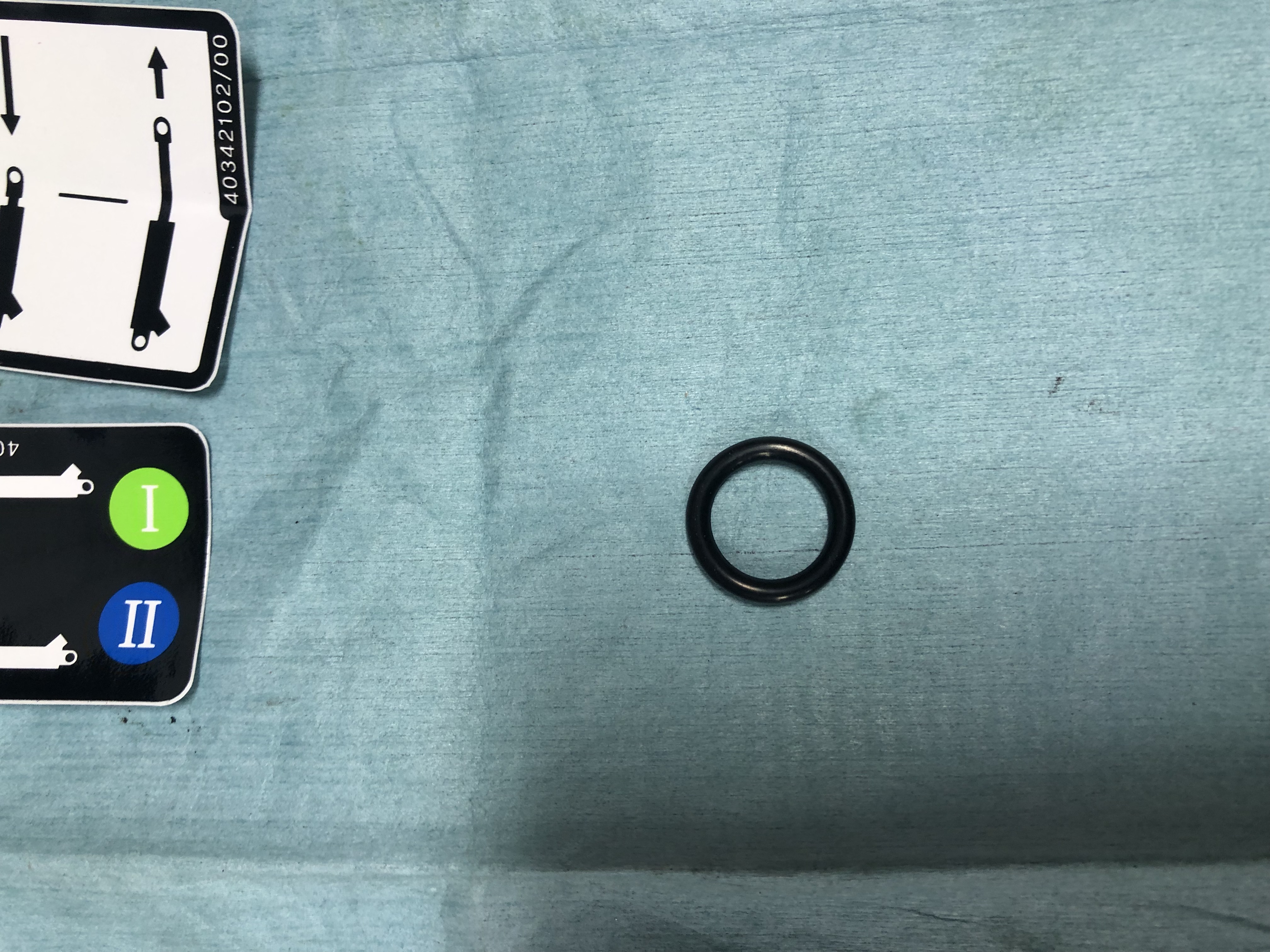

step 5. Install overflow tube. But first you need to add o-ring grease to the tube and oring provided. Than take off the plug on the transmission. Once completed install tube as shown.IMG_6766.JPGIMG_6767.JPGIMG_6768.JPGIMG_6765.JPGIMG_6772.JPGIMG_6769.JPGIMG_6775.JPGIMG_6770.JPGIMG_6771.JPG
   / XG3025H Dual Rear Remotes WITH Detente COMPLETE INSTALL!!!!!

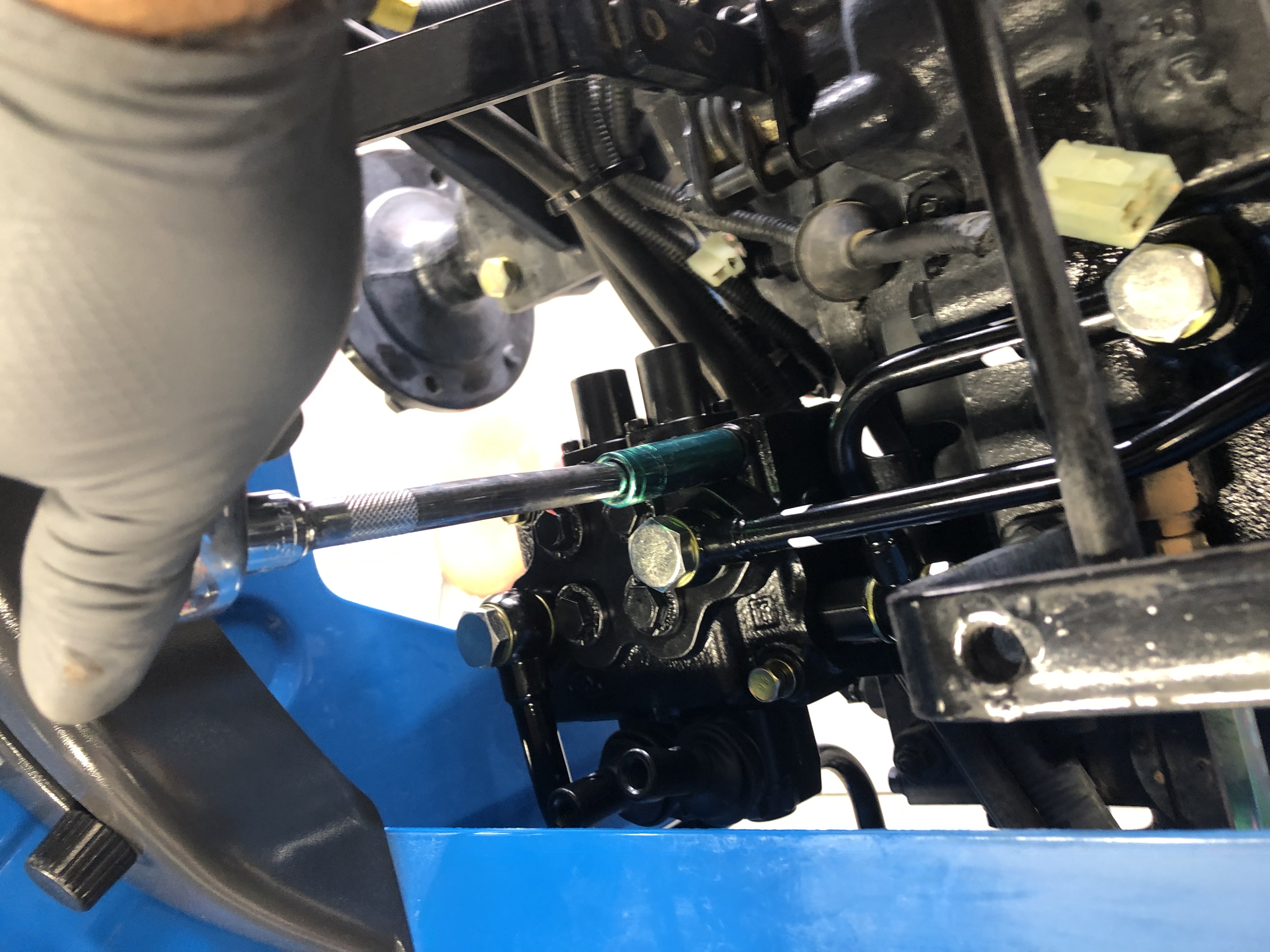

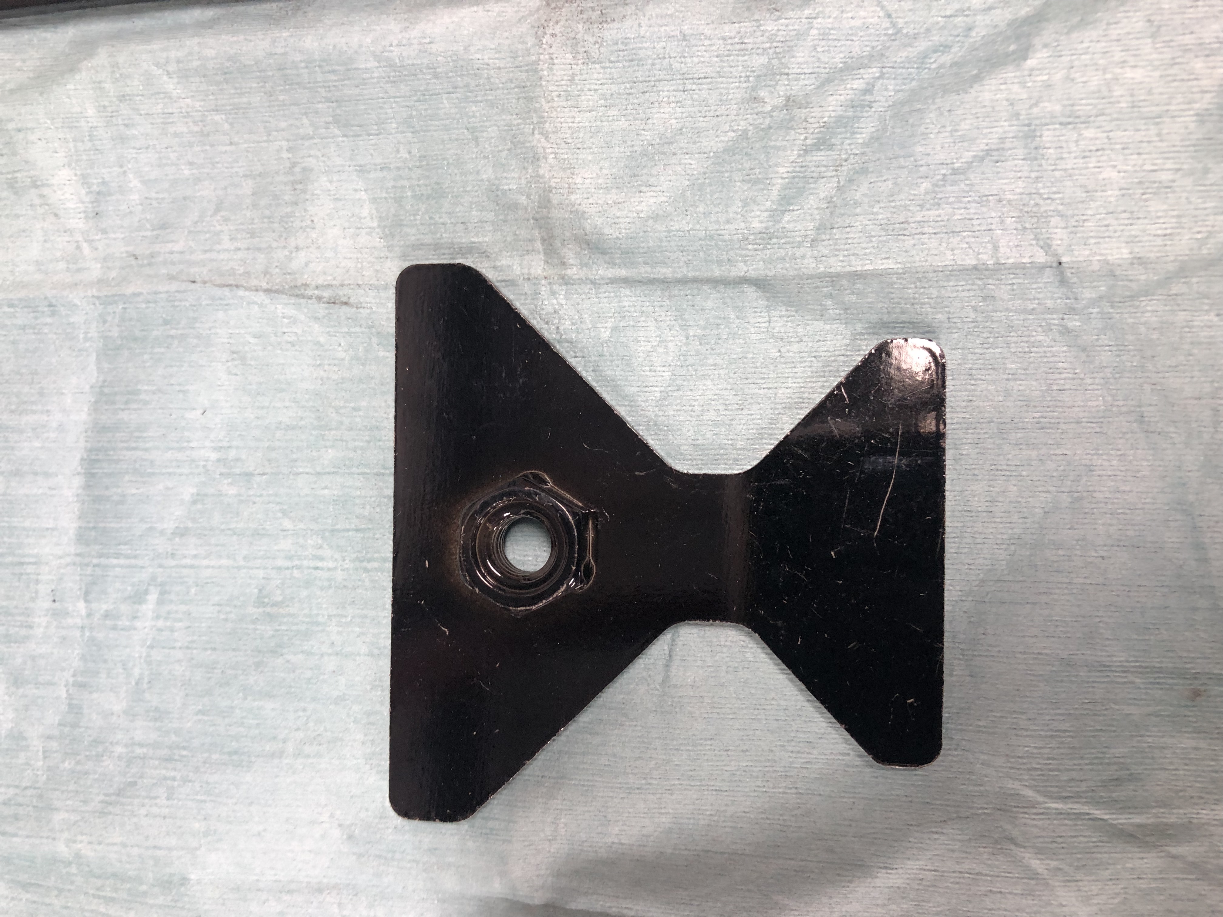

step 6. Once all the banjo fittings have been tightened down, you can now tighten the three bolts that hold the manifold onto the base plate.

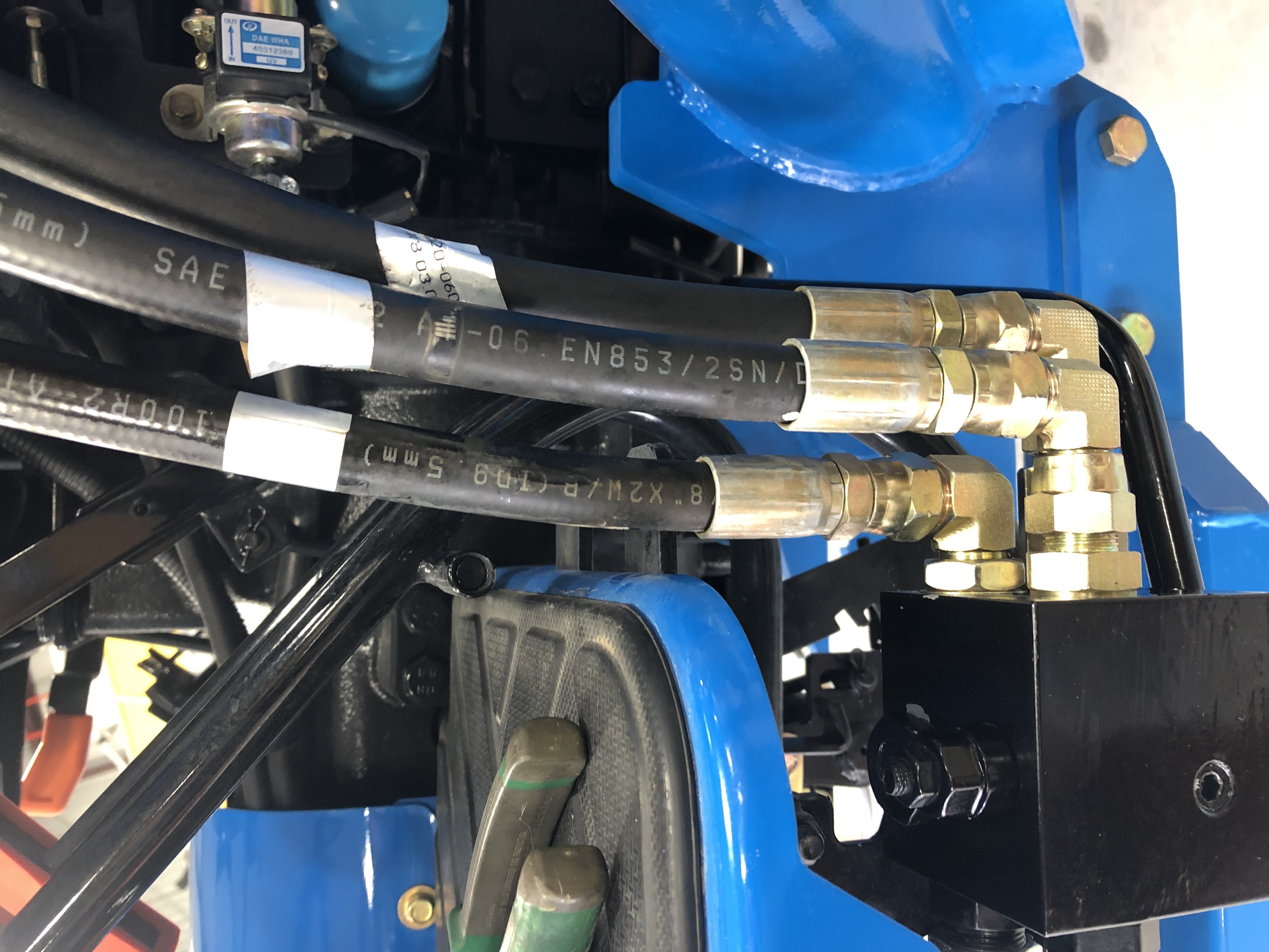

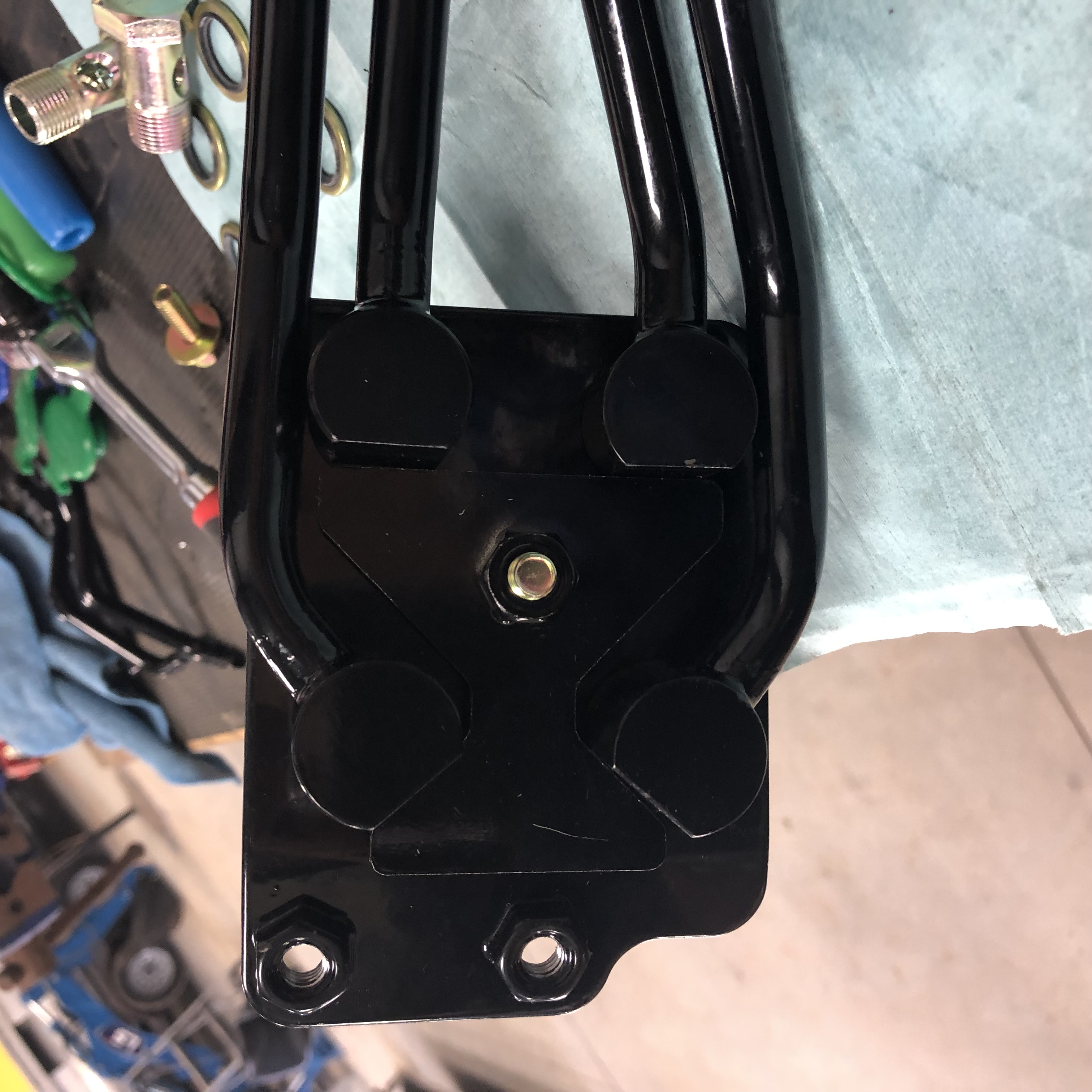

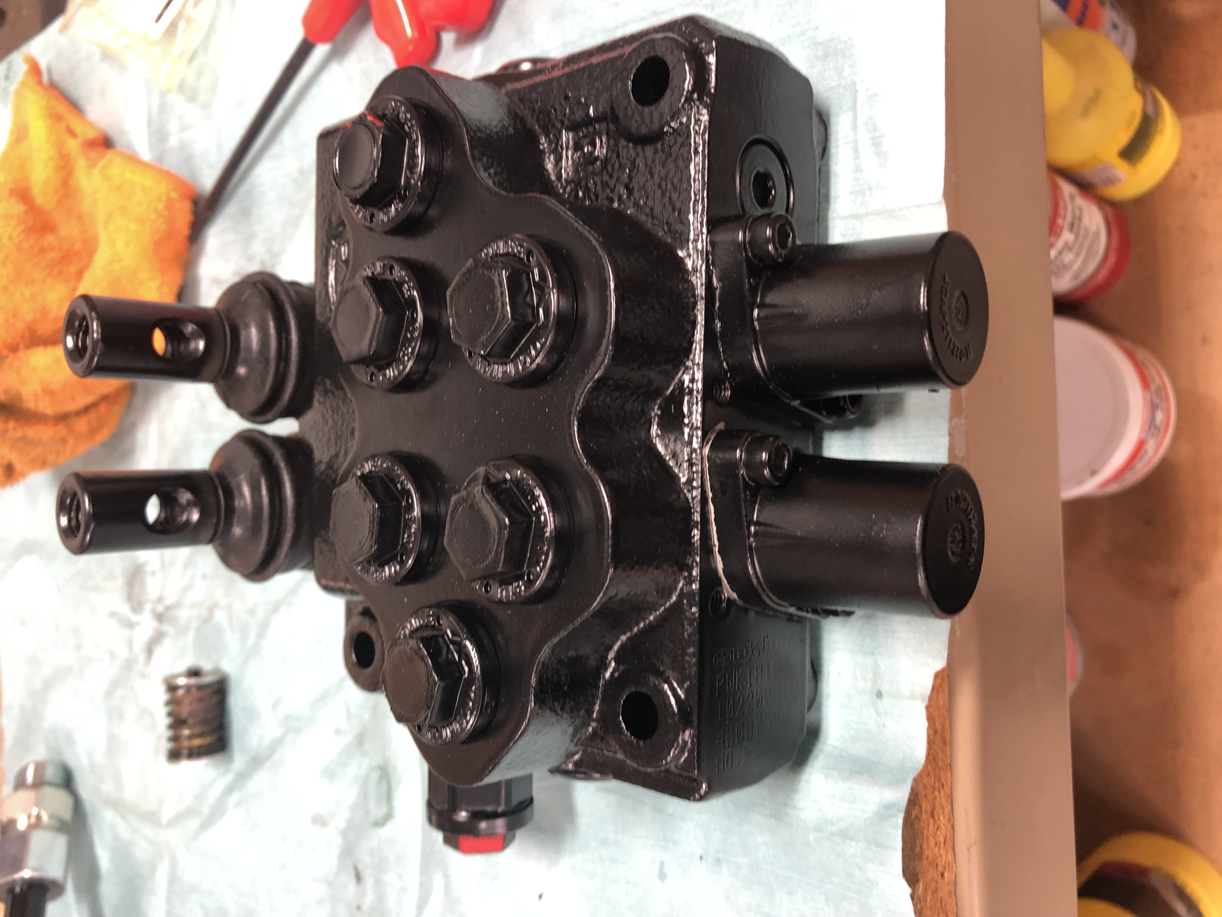

Step 7. The rear remote manifold and pipe fittings with the front and back plate that looks like the symbol of the black widow. The instructions give you the step by step so I will only show you the parts and than what it looks like with all the pipes installed correctly.
Once that is done you will now install two risers on the front of the remote valve body. I torqued these down to 20 foot pounds as well. Make sure you are using the brass oring fittings on ALL banjo fittings as well as these two adapter risers.

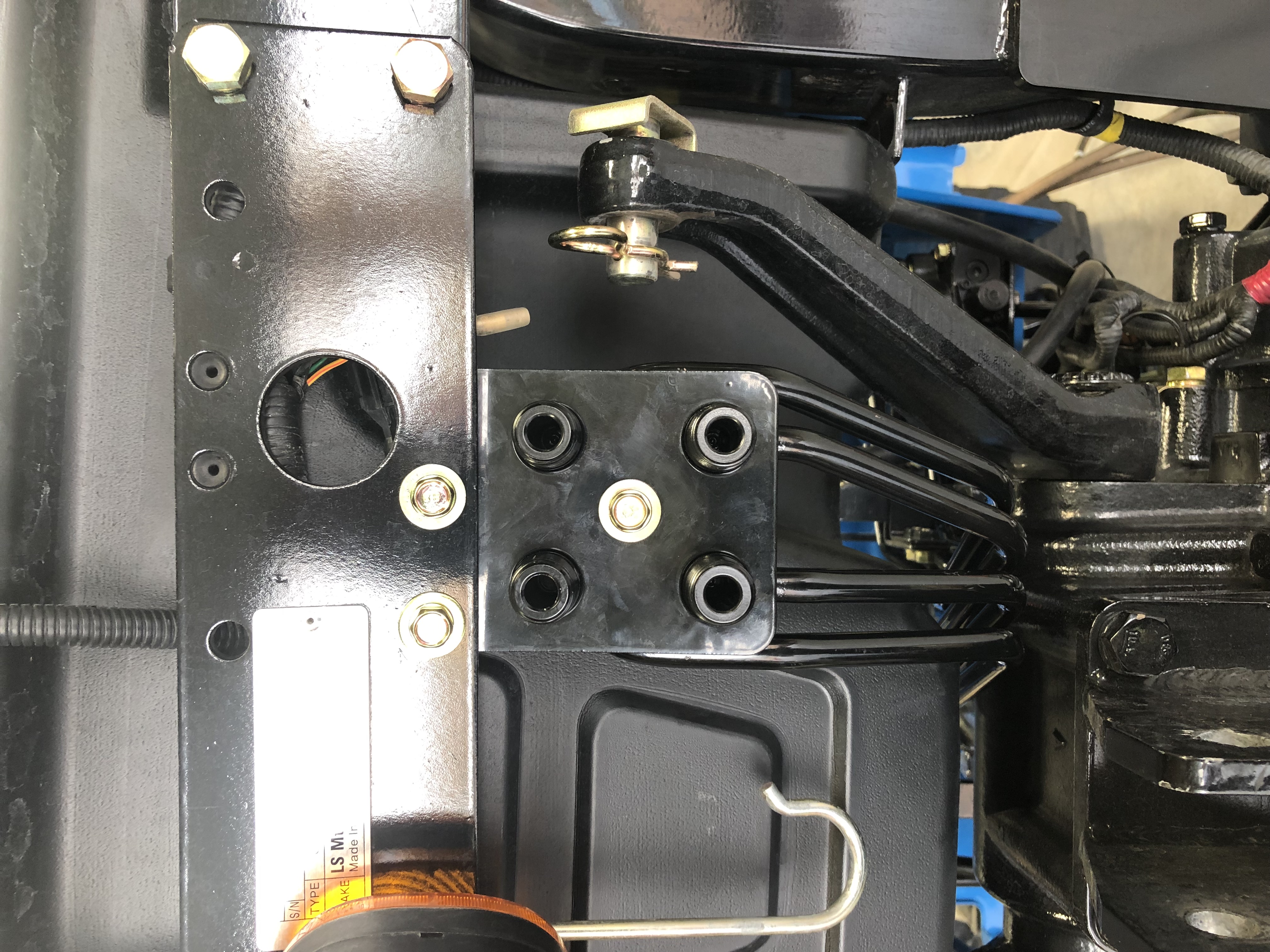

After that has been completed it is now time to install the rear remotes with the banjo pipes connected to the back of the ROPS back panel with the supplied two bolts. Followed by connecting the hard lines at the remote manifold in the corresponding spots.

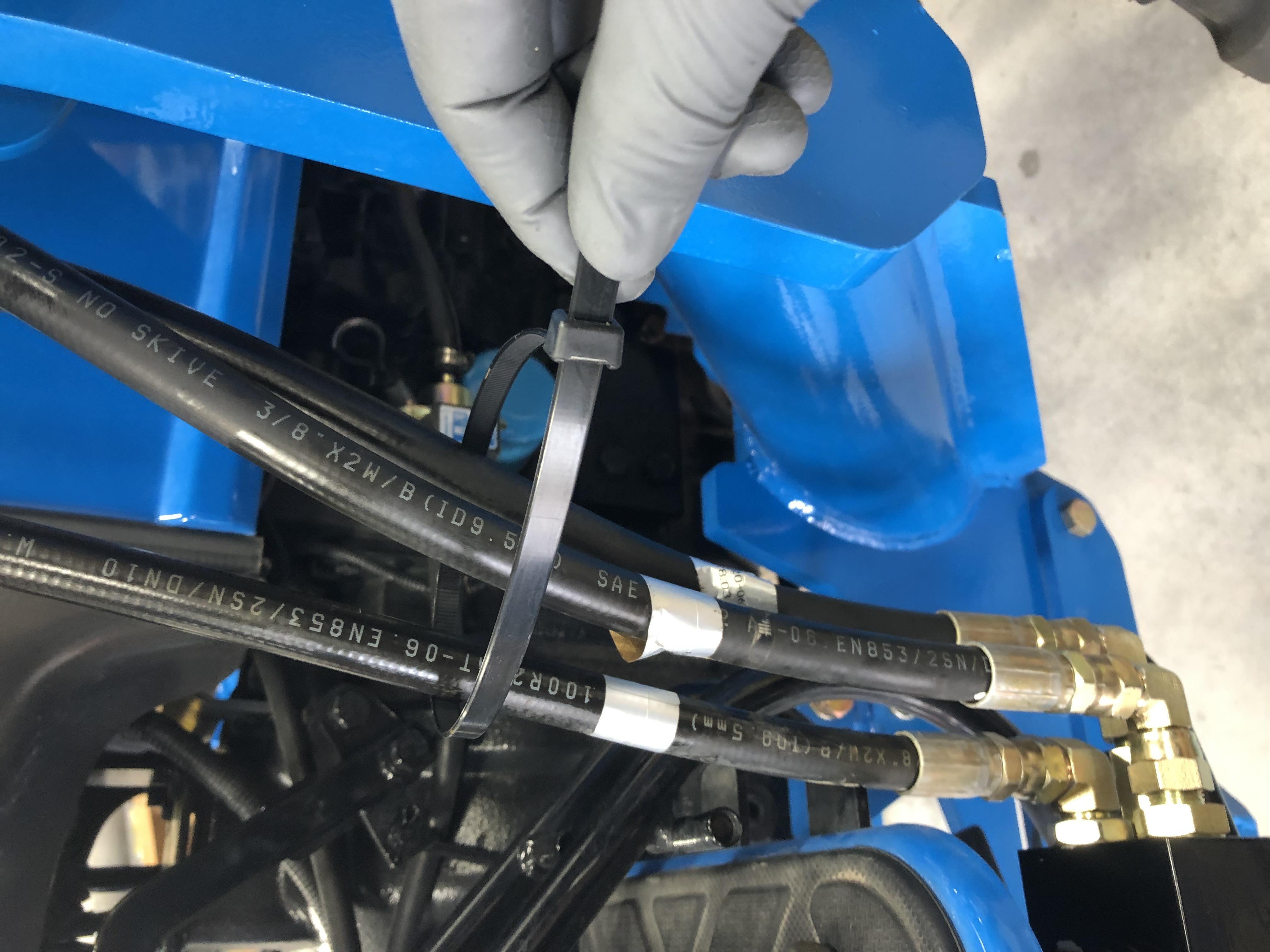

Now I went to 2 different hydraulic parts stores here in town and purchased 5 different types of plugs that they were confident would be for my application. Well they didn't work and I wasn't going to cause damage trying to booger it to work. So I came up with a much better plan. I sure wish I could of thought about this before driving 150 miles and 5 hours of my day as well as $60 worth of useless fittings. If you DON'T have the backhoe this won't be an issue for you as you will already have plugs in these spots.
So I took the hose that was already on the top and disconnected the 2nd hose that went to the back. I disconnected the 3/8 elbow fitting so the hose would ge directly into the 90 degree fitting already on the FEL block.
To make this hose work and not stretch it, I loosened the bolts to adjust my joystick down just enough where there was slack in the hose. This worked out PERFECT and is a real clean installation. Last thing to do is replace the zip ties.
