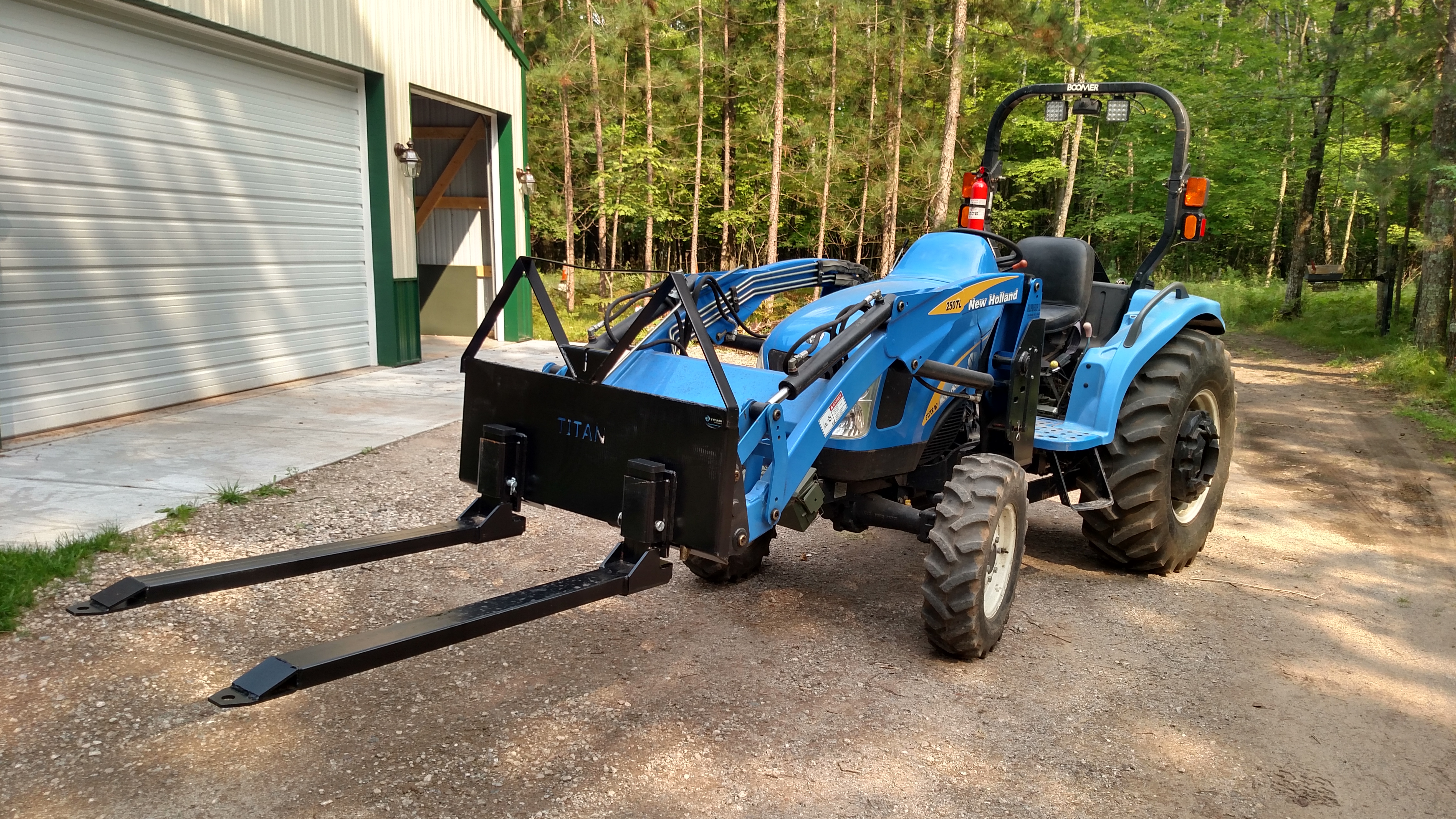

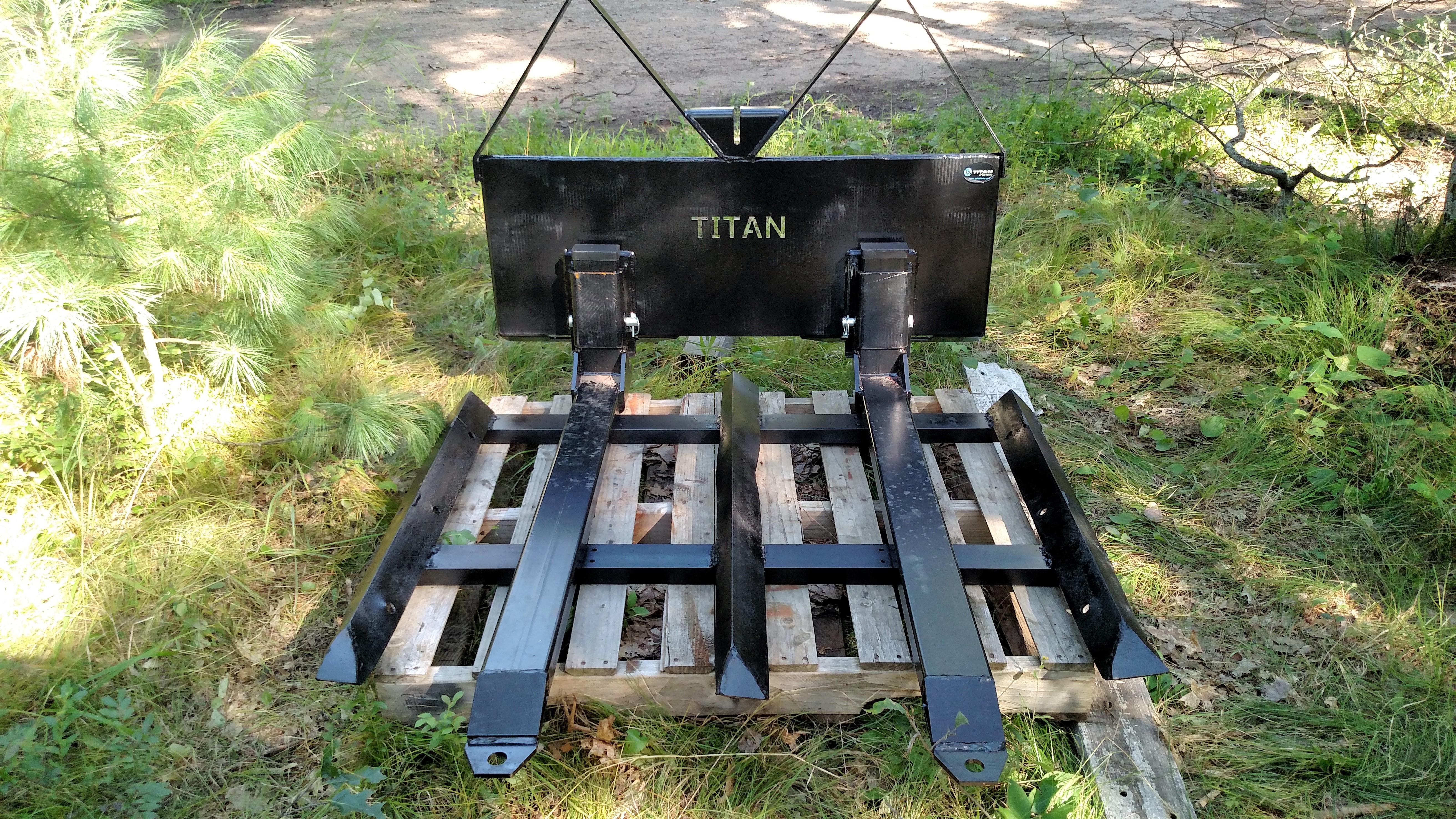

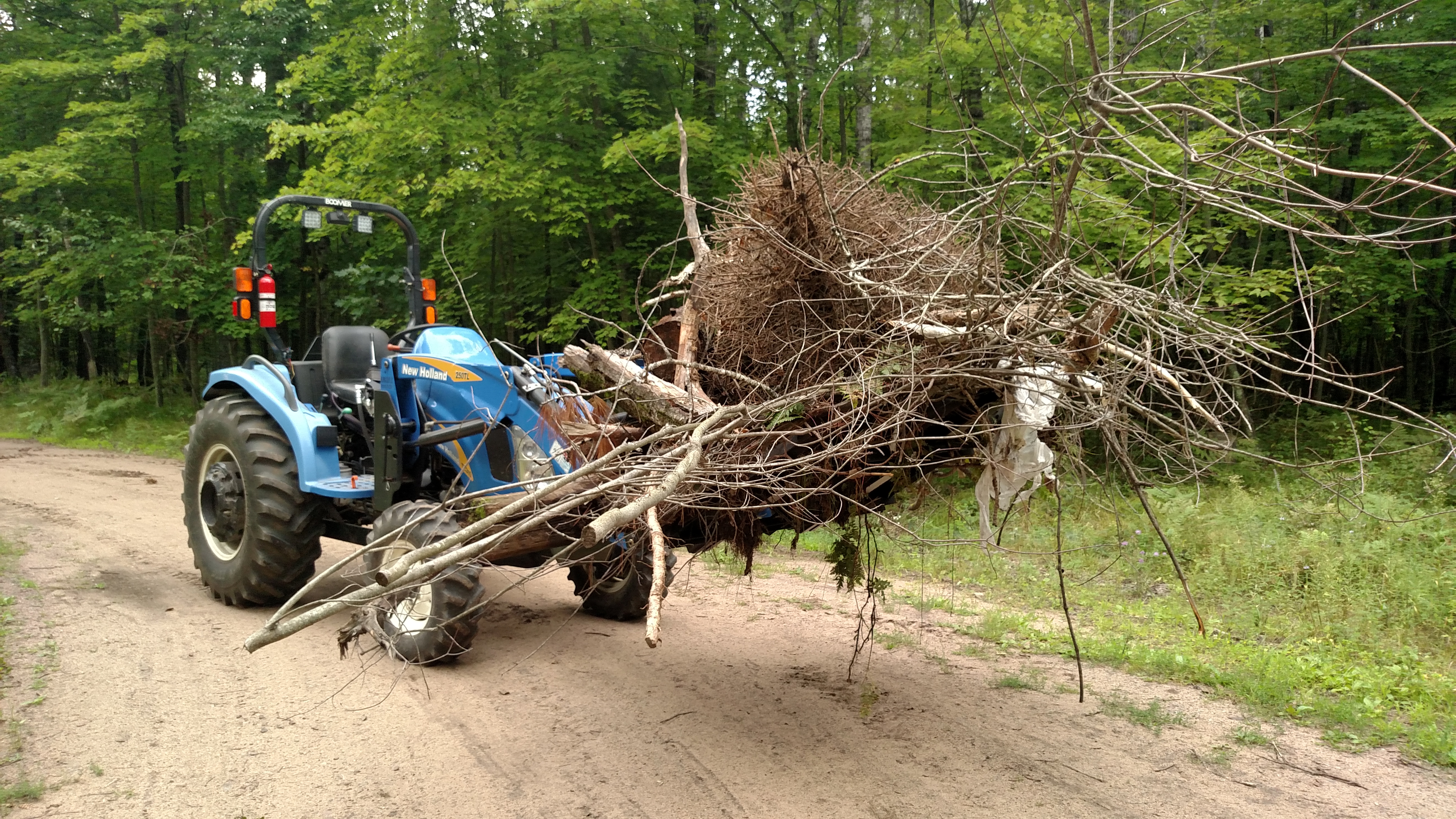

So I looked everywhere to find cheap used forks. They don't exist. I bought Titan 46" nonadjustable forks on sale for $251 with free shipping! I couldn't be happier. They are well built and a great value. I had some scrap angle iron laying around, so I made some debris forks for brush. Works for me.
