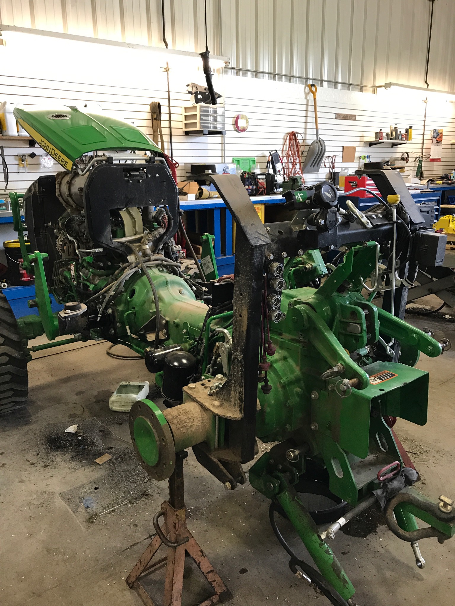

#7 - while it does look tight in there I haven't had any issues with standard maintenance - greasing, cleaning air filters, cleaning cabin filters, tightening the fan belt, cleaning out the radiator screens, checking fluid levels, etc. I haven't changed any filters myself but I feel like they were accessible, maybe not great but oil changes are only scheduled for every 300 hours (I believe...). I'll get my buddy to send me a pic of his JD compact tractor that's at the shop right now. They're trying to diagnose a transmission issue and it looks a lot more like a pile of parts than a tractor...
