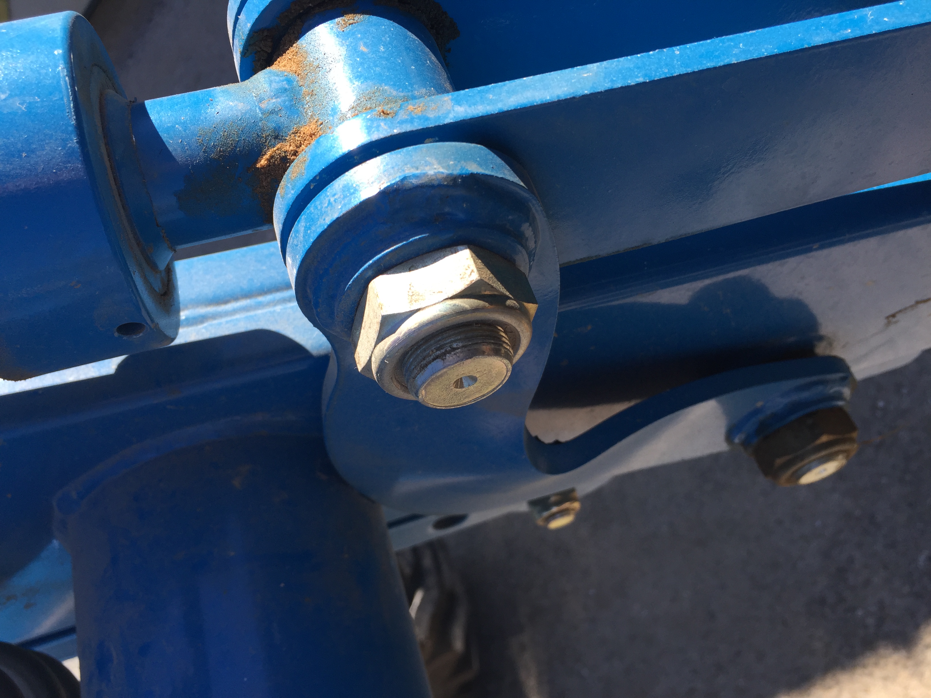

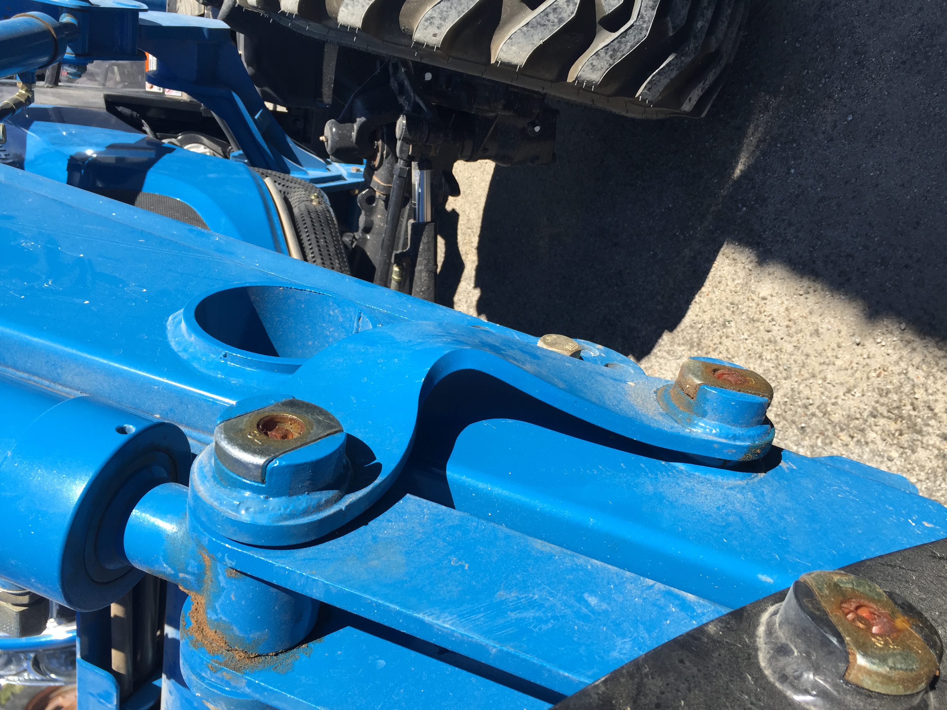

Has this been an issue for anyone else? I wish I had a clue how I bent them but I really don't. I'm guessing while using my grapple a few weeks ago but I surely would have noticed it before now. I have recently used the auger for several holes but the most damage it to the side opposite the right offset. Dealer is trying to get me a price and availability to replace all four.

I'm not seeing any cracked paint or stress lines. How does the the bucket or grapple 'sit' when raised? Is there an angle to one side?

I would remove one and take it to a metal fabrication shop and have them make a set . Looks easy enough to replace by the diagram above

Several LS members have bent these dog bone shaped brackets /arms. They are a weak point that can bend from either back dragging with the bucket tilted too vertical or running into an immovable object such as trying to push a tree over with the bucket. There are many links, here's one I found.
http://www.tractorbynet.com/forums/ls-tractor-owning-operating/314457-bending-metal-loader-2.html

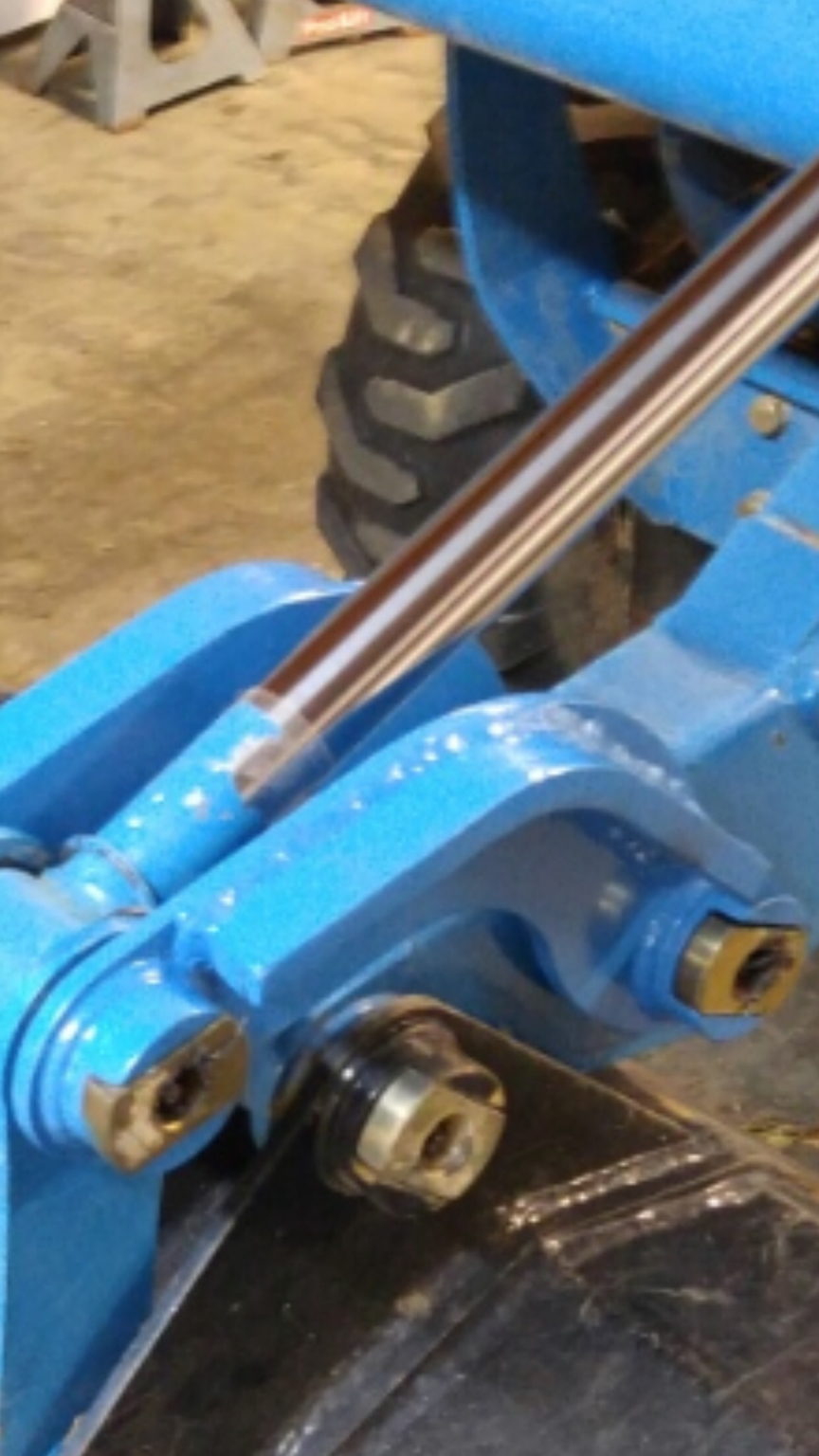

I remember seeing another members replacement reinforced dog bones that had an extra vertical piece of heavy bar stock welded on for extra strength to prevent bending but couldn't find that link. If your loader is less than a year old they should be covered under warranty.
Its not just LS loaders, Mahindra and John Deere owners have bent the dog legs too. I think the loaders are made by Ameriquip but not sure.

No, they both sit square to the loader quick mount. George posted a link and it seems I'm not alone having this issue. Guess I'd rather have the "dog bones" bend than do mount or ram damage.

Thanks George, good info and great link. My dealer has another set coming and I'm going to research the pros and cons of beefing them up. Hate to do other damage to the loader further up. Appreciate everyone's replys...
