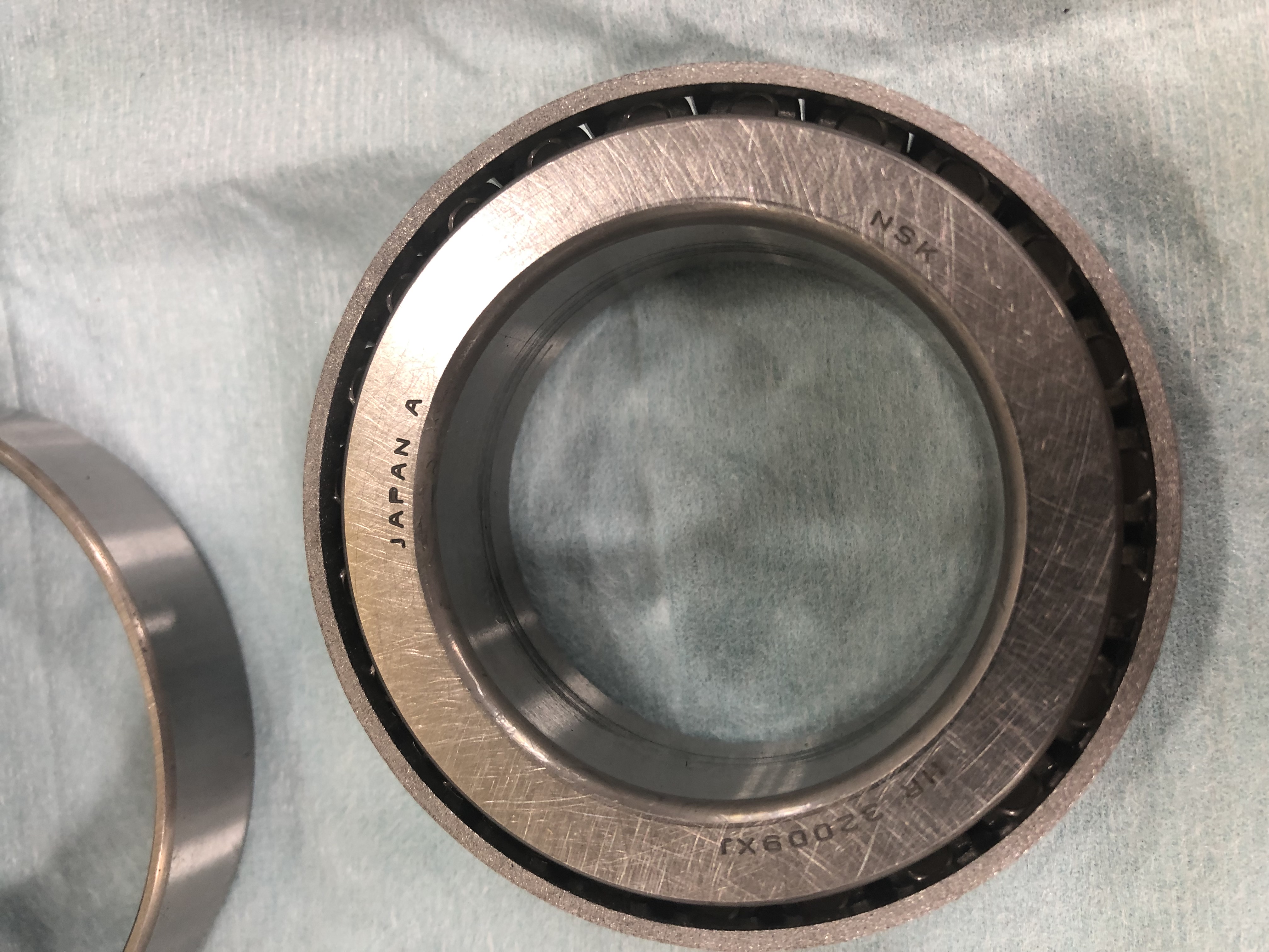

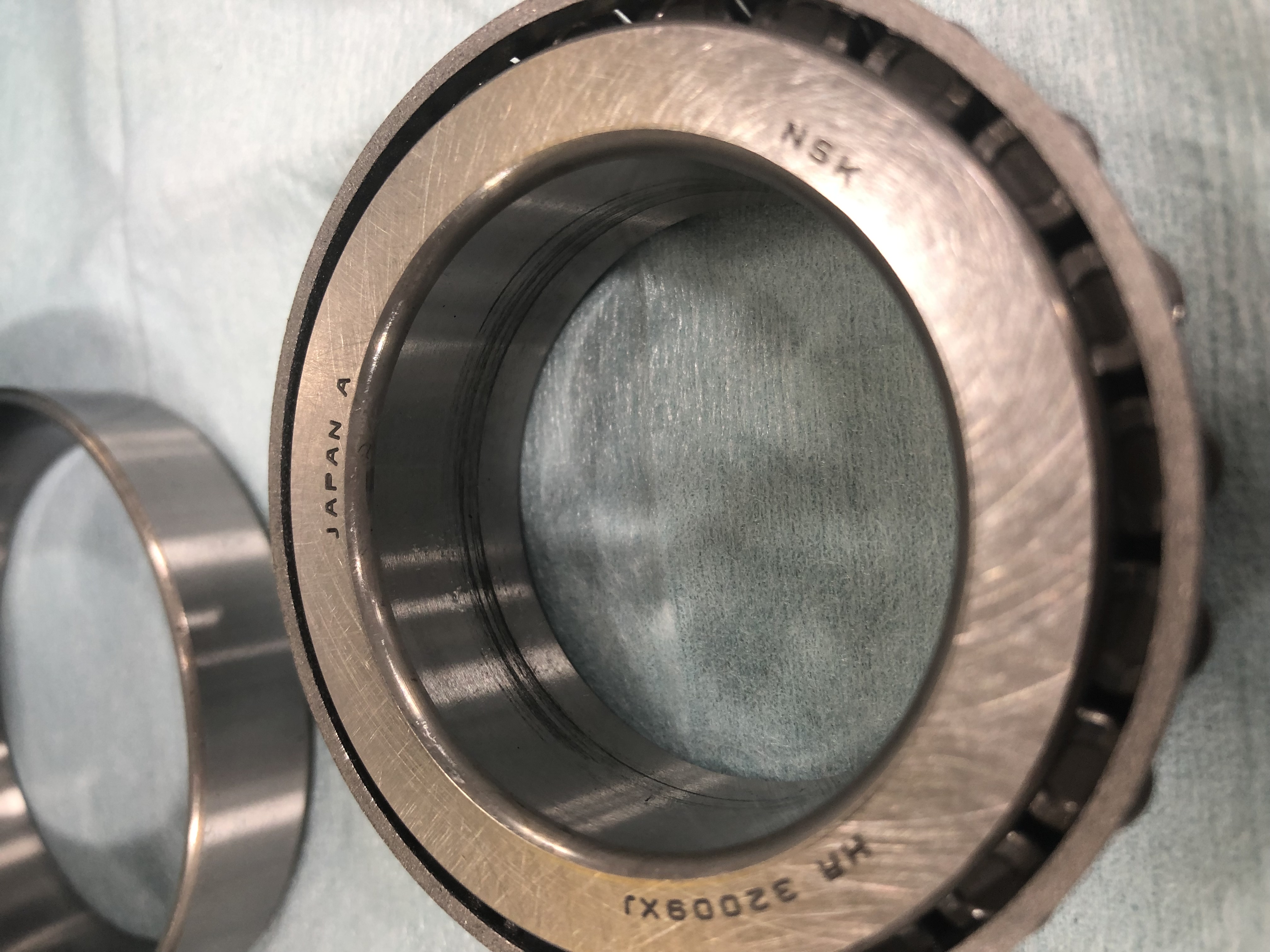

My tractor is the 3025H and is a 2018 model. I am having to replace wheel bearings to my final drive hub assembly in what began to be from a seal leaking bad. My bearings came from Japan and I attached a picture of the outer bearing that got to hot. IMG_6354.JPGIMG_6355.JPG
   / XR4150H Hub and/or bearing #10
NSK is supposed to be about the best there is. I think I'd let them know. seriously
There is a lot of counterfeits going around. The Dangers of Fake Bearings | Machine Design
It looks to me like that bearing 'spun'. Not sure it's the fault of the bearing itself. I could be way off, just a guess.
Did the bearing seize, causing it to then spin??
