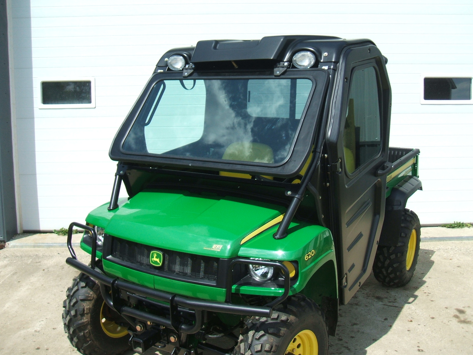

This is the glass windshield we offer. It is hinged at the top, and you can see it in the open position in this photo to allow ventilation. It doesn't go all the way down to the hood, but rather a panel cuts back down to the dash so you can open the hood freely without anything to move out of the way first. We can set it up for both our own Poly Roof Kit and Header/Light Kit you see in the photo, as well as the Deere poly roof.
I've hauled this at interstate speeds with no problems, albeit full cab and loaded backwards on the trailer.
A lot of my dealers have commented on the short life span of the factory poly windshield due to scratching.
