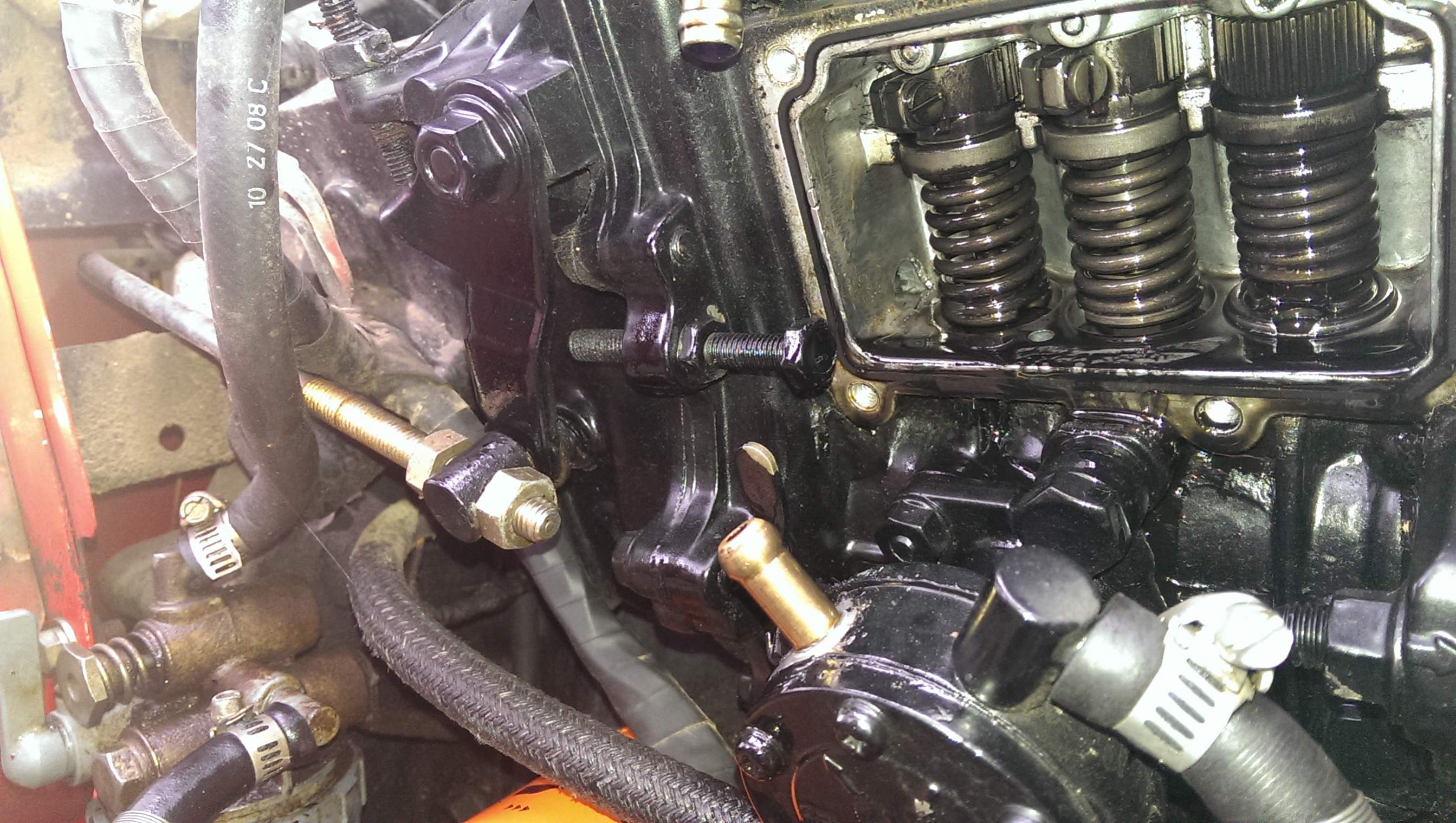

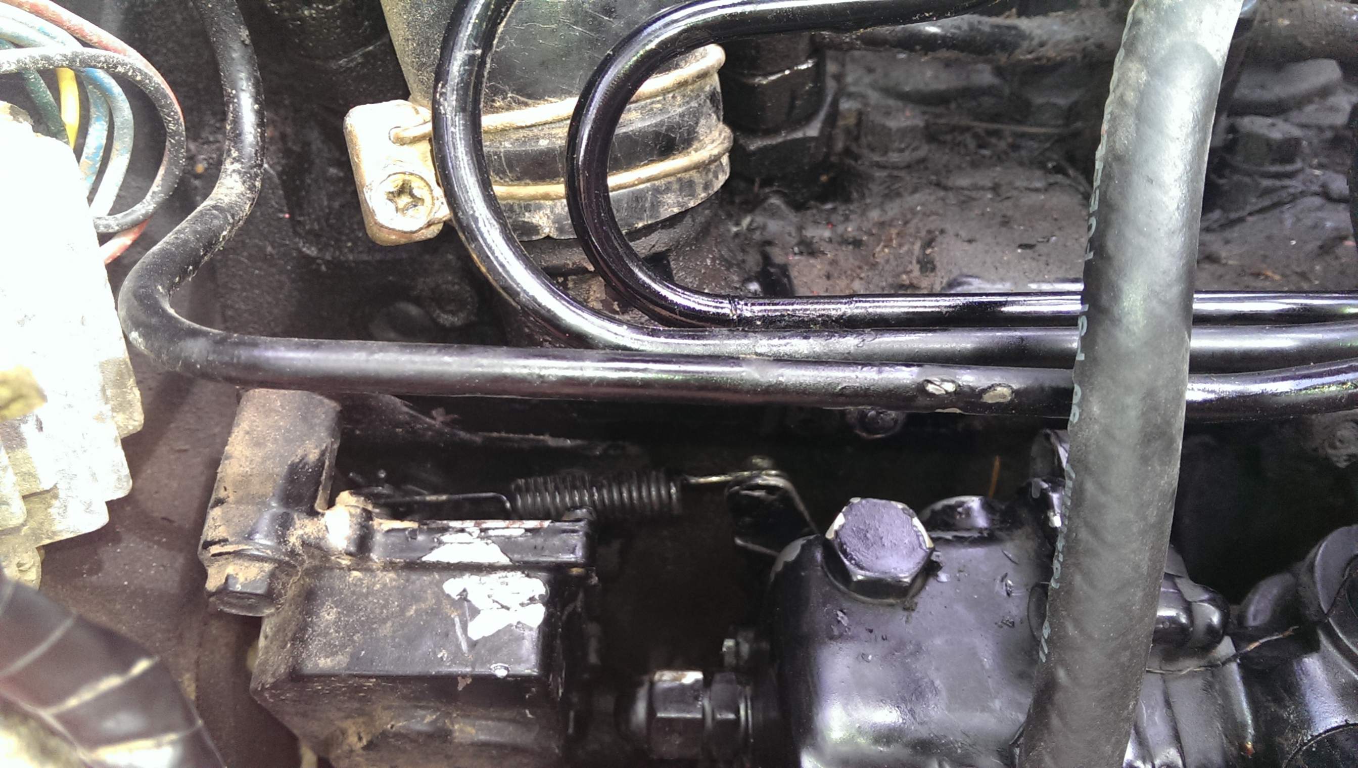

Sat few months, won't start even with starting fluid. I removed air breather and found small mud dobber nest on engine side,,I have no idea if any of this got sucked into engine,,, it sounds like it will almost start but never does,,,, I do NOT know much about injectors,,, any hints appreciated. There could be air in lines,, and some of them I'm not sure how to bleed.

Welcome aboard. :welcome: Pictures look sort of like an F17. Would that be correct? I would be very careful with ether on these engines. Heard quite a few horror stories of busted piston lands. You have a fuel feed pump shown in picture #2. Is it working? That little lever on the pump is a priming lever. Start bleeding air at the fuel filter and work your way all the way to the injectors if need.

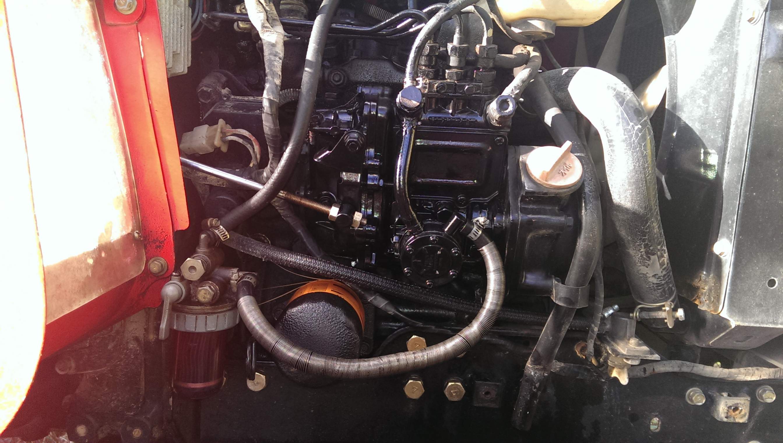

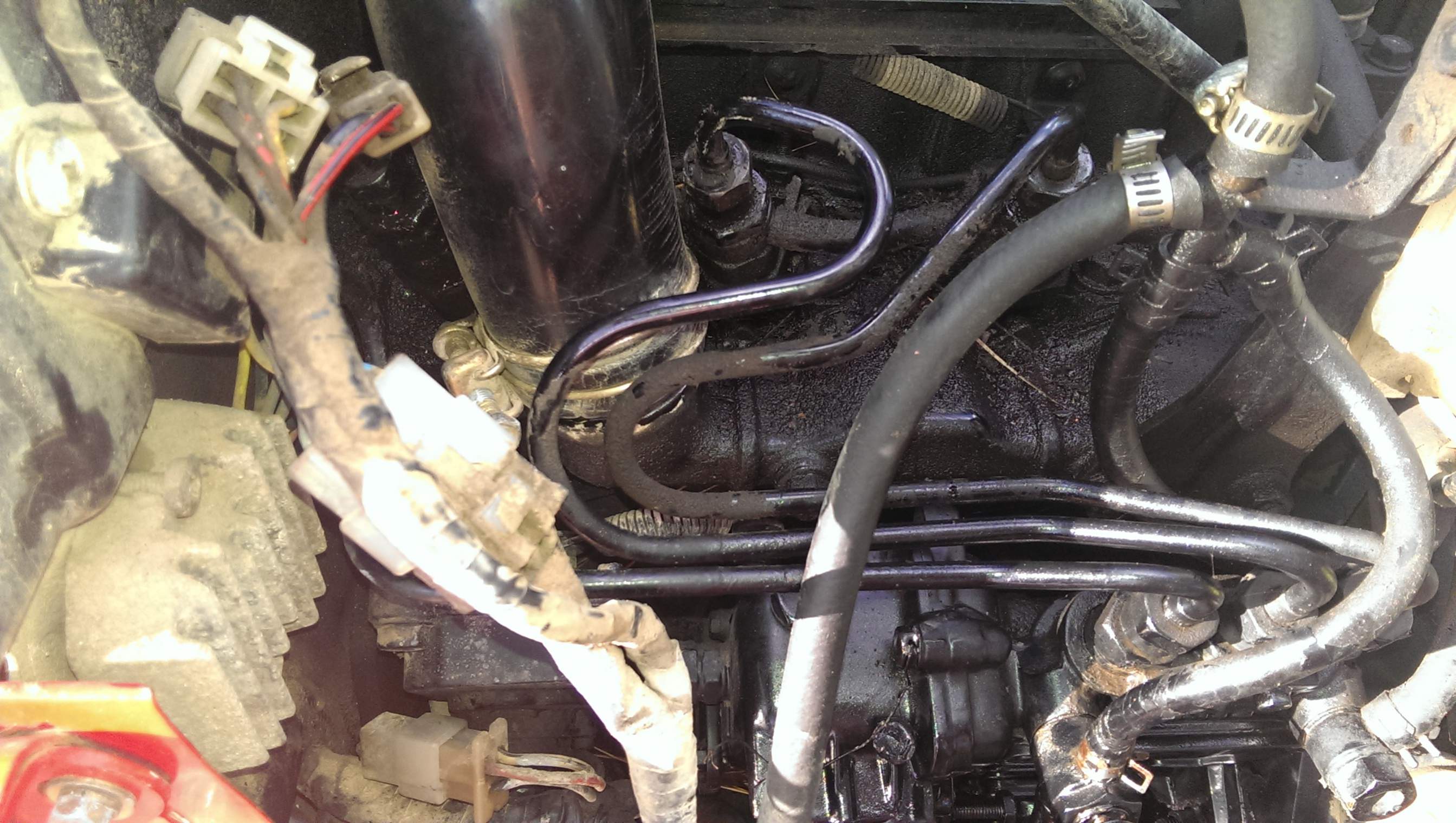

son figured out that on the F17.... the fuel switch was sticking ...the fuel cutoff switch. is that part available?? I'll just use my finger for now to shut it off,
   / y17. three cylinder, not cranking #9
Can you point the switch out on your picture? Does it look like an electric motor?
Yes it has electric motor that doesn't run every time you turn key but should. It is on far left directly above fuel filter and was connected to fuel cut off switch to the right. Which I can manually flip to kill tractor.IMAG0218.jpgIMAG0217.jpg
