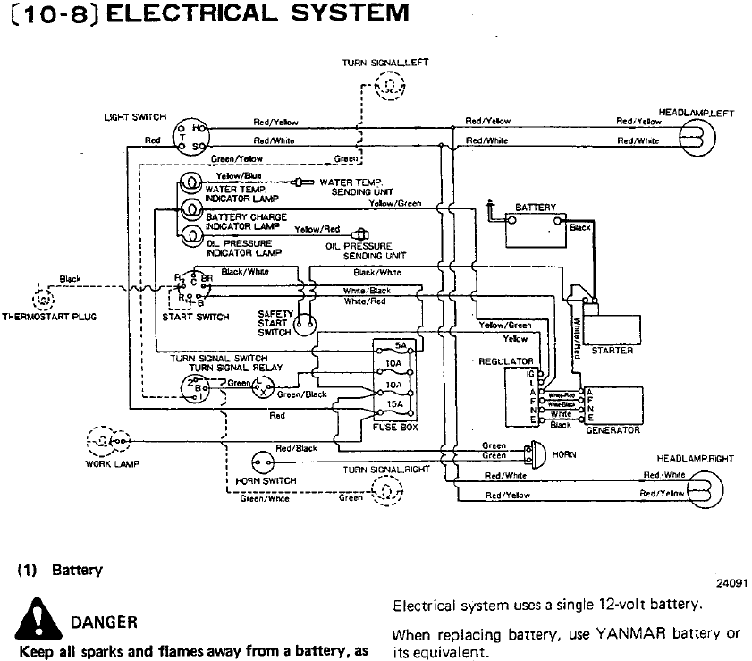

I'm new to this forum but have already learned a lot from the postings. I bought a 1100D that has the wiring all butchered up. Appears the ignition switch went bad and it looks like someone tried to direct wire it, and use the horn button for starting. Does anyone have a wiring Schematic? Thanks

Attached is a general diagram and not model specific. It may help until you acquire an I/T or parts book for your model tractor.

The general schematic didn't help much. My tractor has a 2 wire alternator and a 3 wire regulator, Have ordered a IT shop manual.
