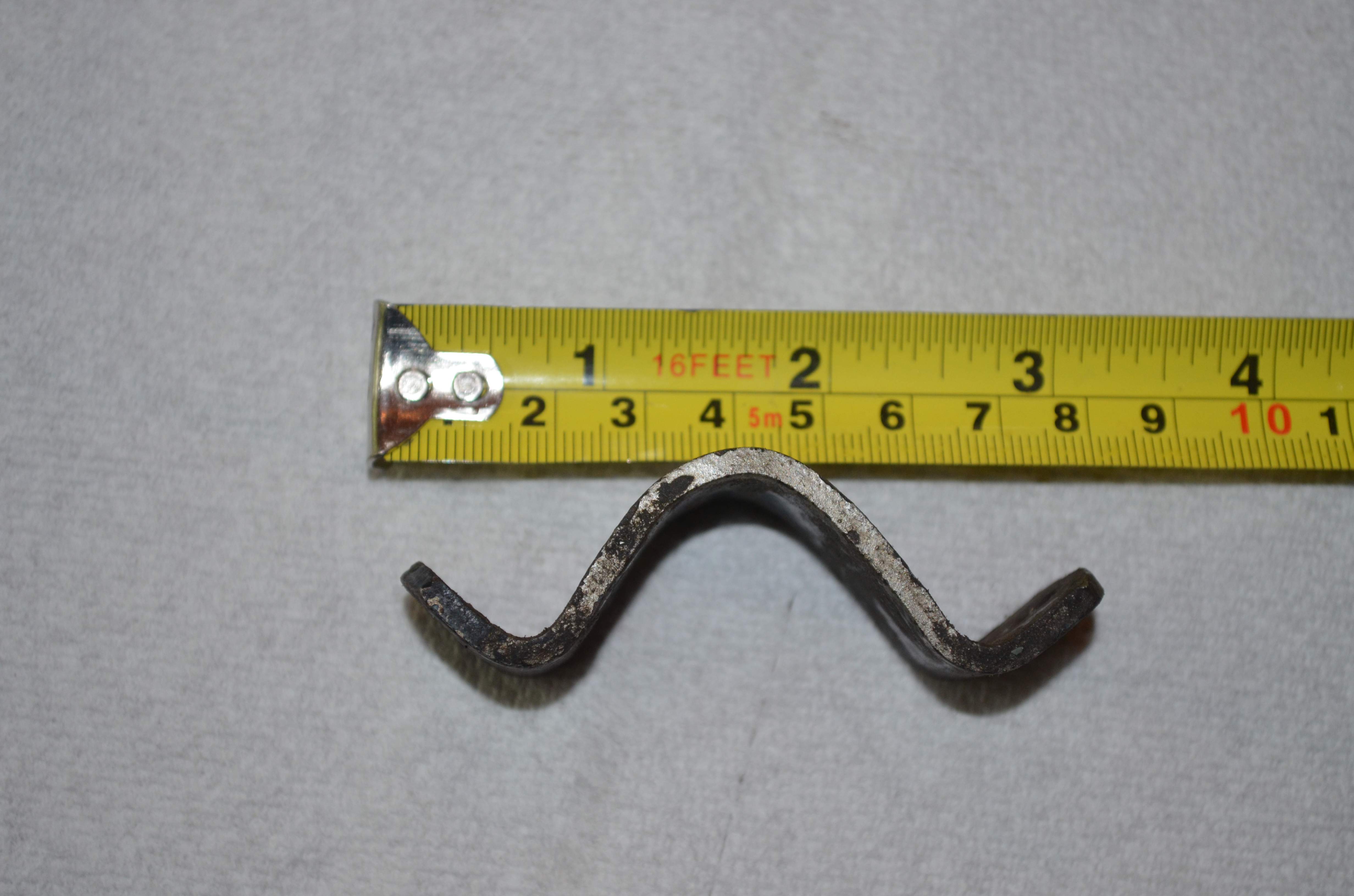

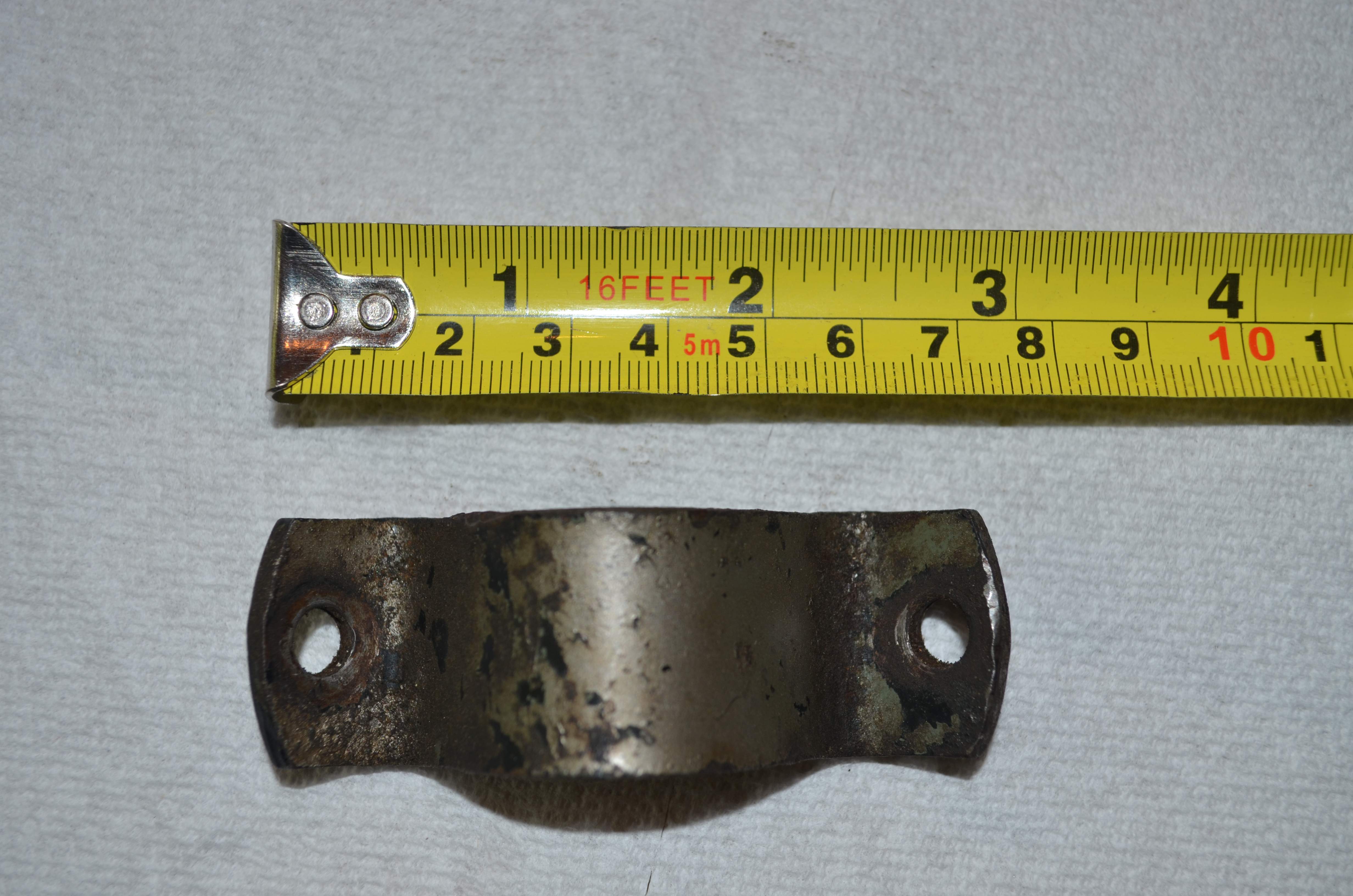

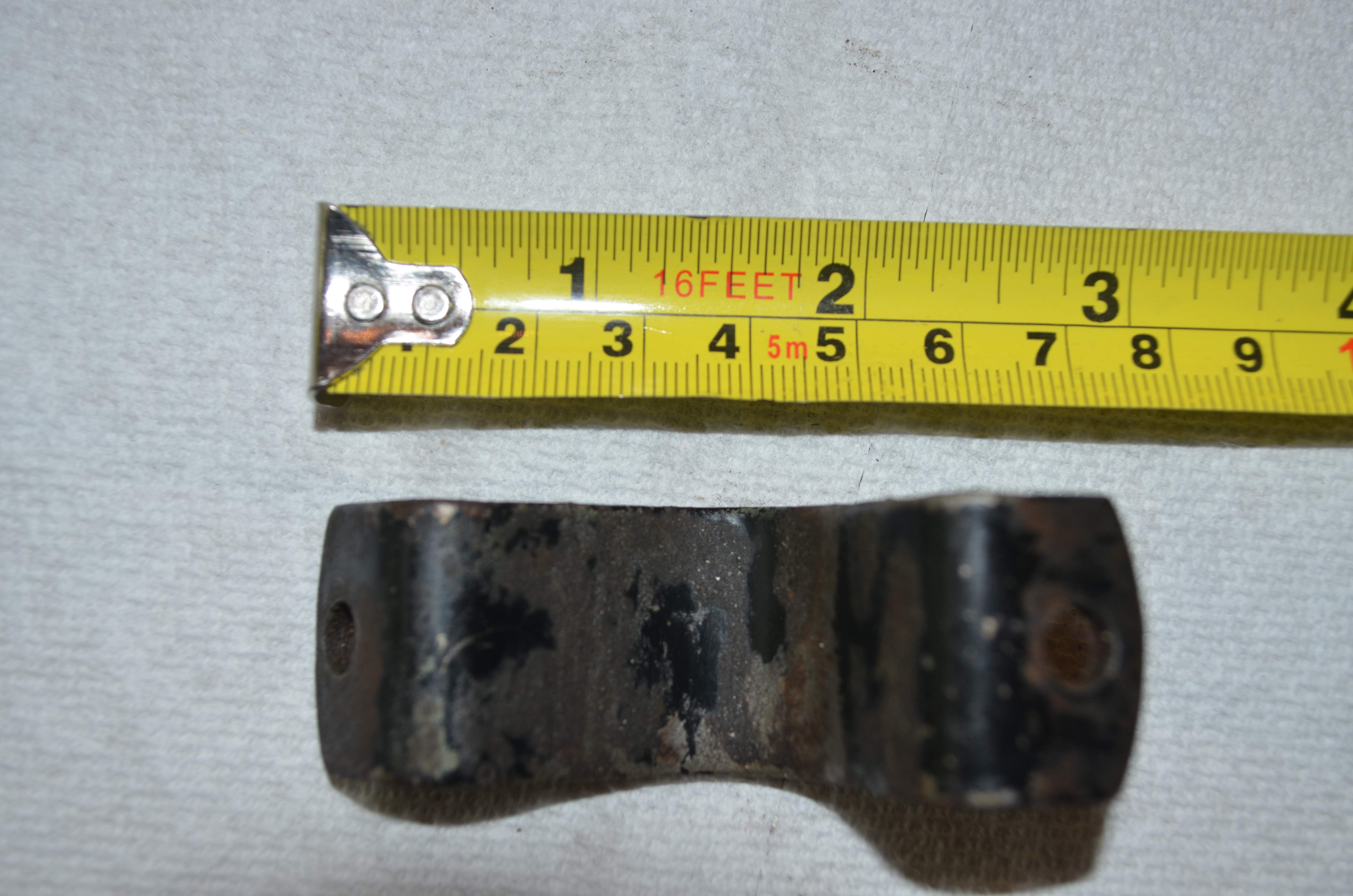

After 1 1/2 years of sitting I finally got around to replacing the clutch and internals on my YM 1500D. Only one problem - when finished I had 1 part left over. After looking for about 2 hours, I asked 2 buddies where it may go, no help. I have even stooped to asking my wife to see if she can see a place for it to go. Still no help. I am sure it is not an internal piece that goes in the bell housing. Is anyone out there good enough to tell me where it goes? I attach 3 photos of the part.

Maybe a clamp for a hyd hard line.
   / Yanmar 1500D 1 mystery part .left Over - Any Experts out there that can recognize it? #3
Dang beat me to it.
Additionally - since the screw holes are at right angles, it apparently fits an inside corner.

Thanks for the guesses (except Toddao) but I have already looked in corners (no bolt holes) and around the hydraulic lines (no bolt holes)????????
   / Yanmar 1500D 1 mystery part .left Over - Any Experts out there that can recognize it? #6
:laughing: There's a 2 piece clamp just in front of the Break Pedals on my YM2000. Half is bolted to the Trans. and then 2 bolts to the piece your showing.

Thanks Carey and Winston. There are some pretty smart people out there including you two.
Now I can be at peace. Next time I will take photos and not procrastinate for 1-1/2 years.
Thanks again.
