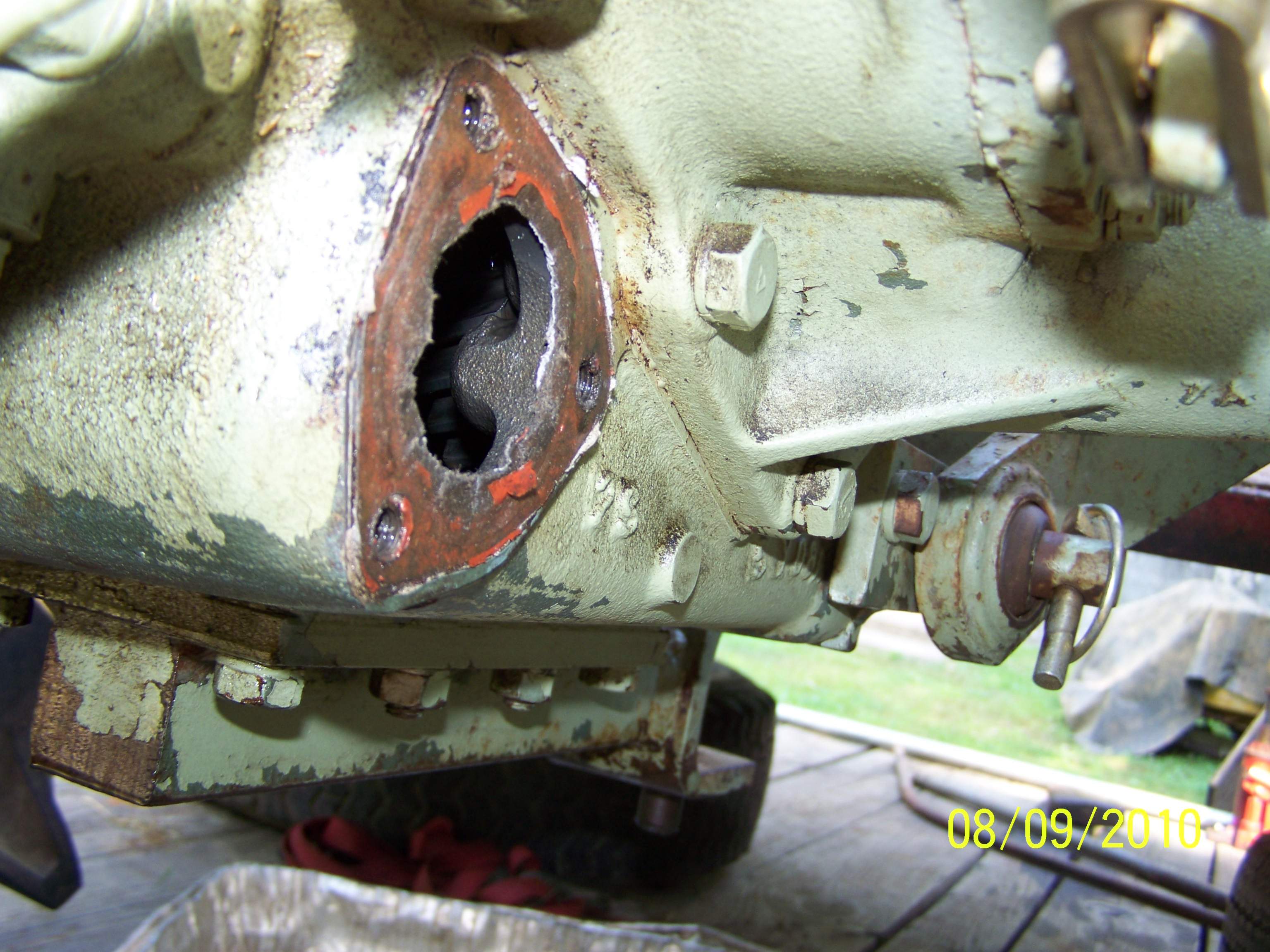

Just got back from Tractor Supply, got 5 gal of hyd/trans oil. I'm going to look for the strainer and replace the fluid. See if that helps.

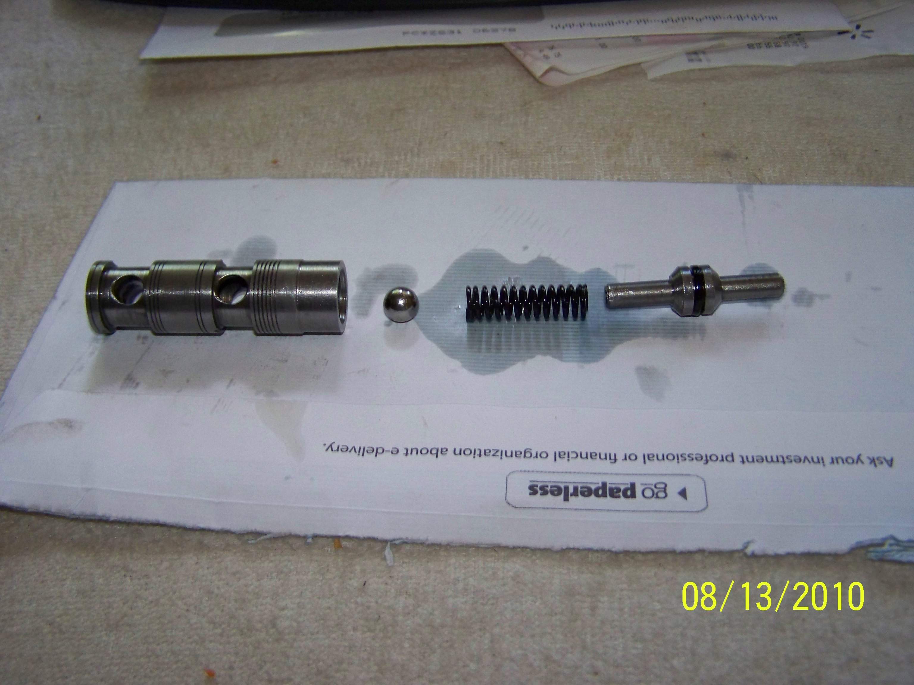

A parts diagram from Hoye Tractor shows two more parts inside the plunger then I have on mine. #26 and #16 or 23. I'll see if I can post the diagram.Yanmar Tractor Parts: 3_POINT_CONTROL
I have a ball, then a spring, piston with a o ring on it, that's it.

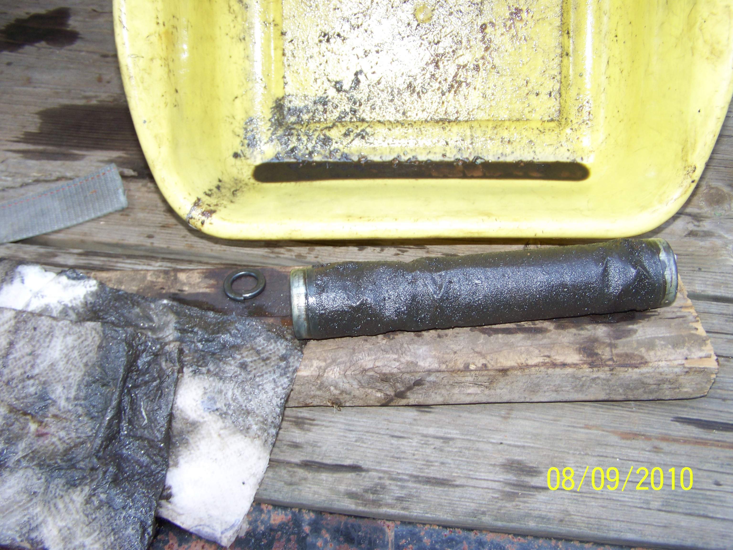

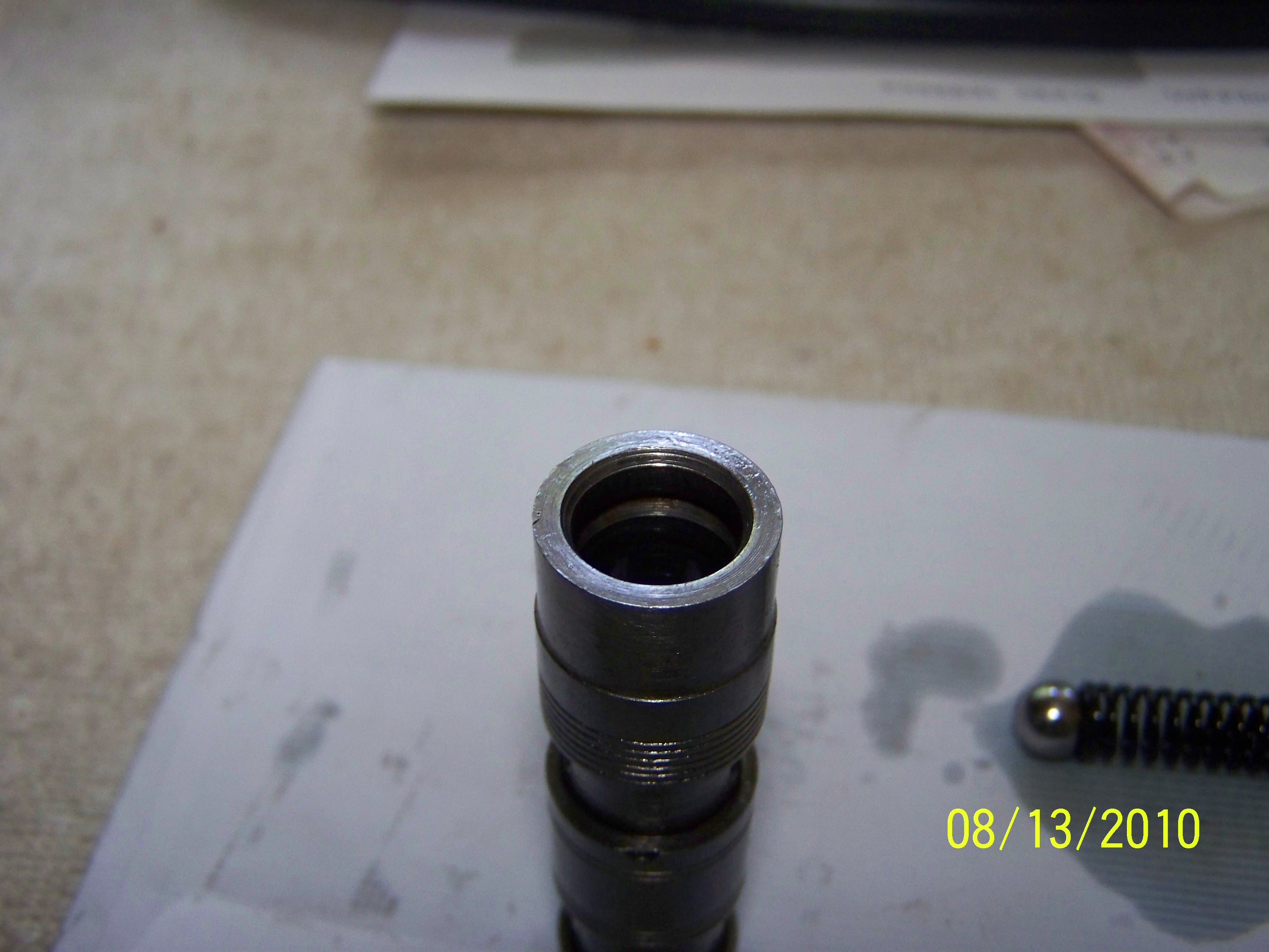

I'm back at it today and took a few pictures. The screen was dirty with small metal chips and it got cleaned, and those are all the parts in the plunger. I know the last picture is hard to see but there is a grove where a cir clip could fit. I'm going to the hardware store to see if I can find one.
