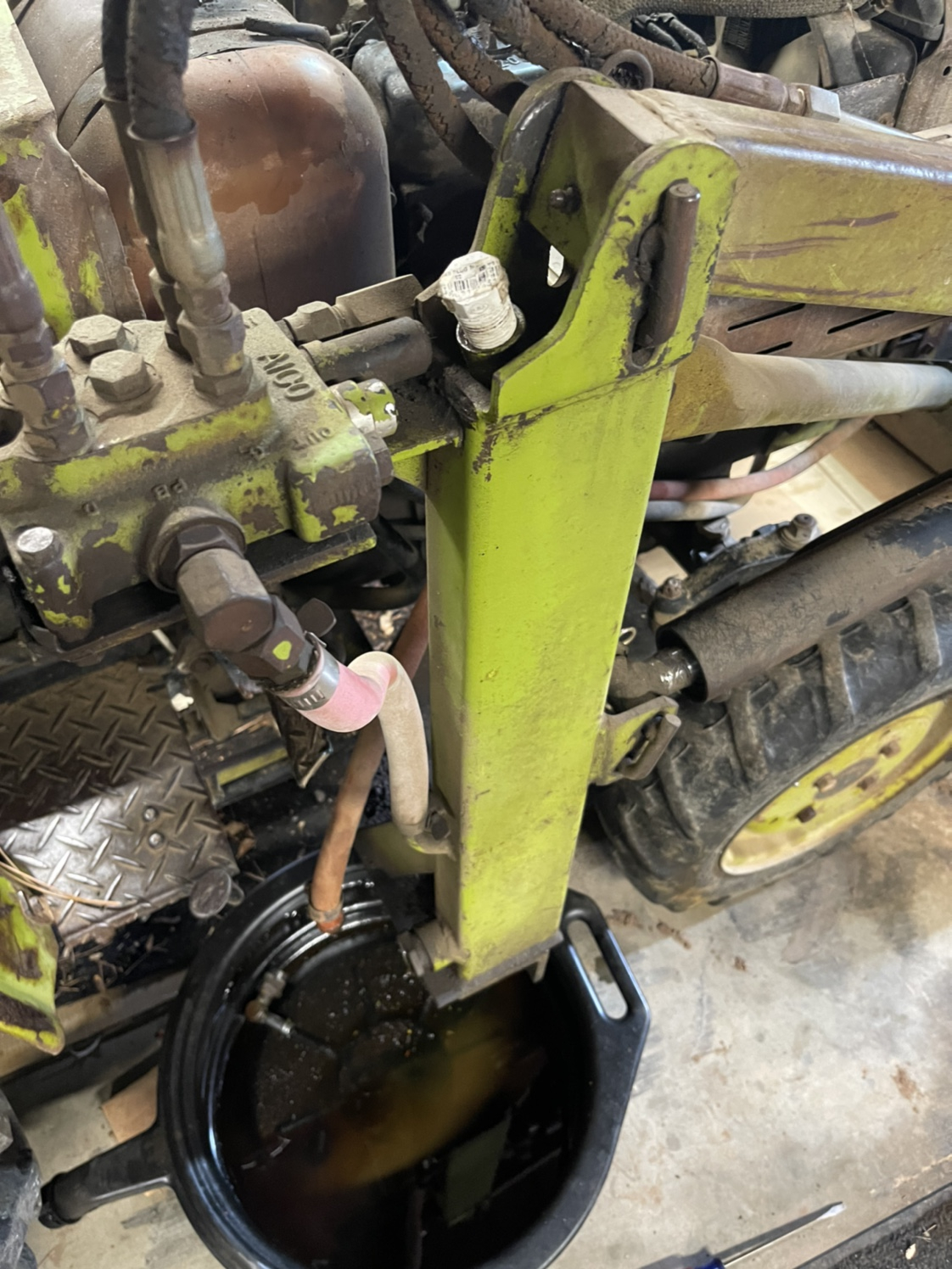

That was my estimate based on the Koyker which was similar. I just drained it out of the bottom of the loader assembly. It’s set up a lot like my Massey industrial. I’ll try and attach a picture. Thank you!

Interesting! That's the exact same AICO loader control that was presumably dealer-installed along with my Great Bend (third party) loader on my YM240, before it was sold new in 1980. And I've seen that control widely used back in the day on 8N loader installs.
But your loader structure is completely different from the Great Bend loader, or the Yanmar loader on my YM186D.
What feeds the input side of that AICO loader control?
Looking at that again - is that a low pressure reservoir before the fluid returns to the sump, or an isolated system driven by a second pump, or ???

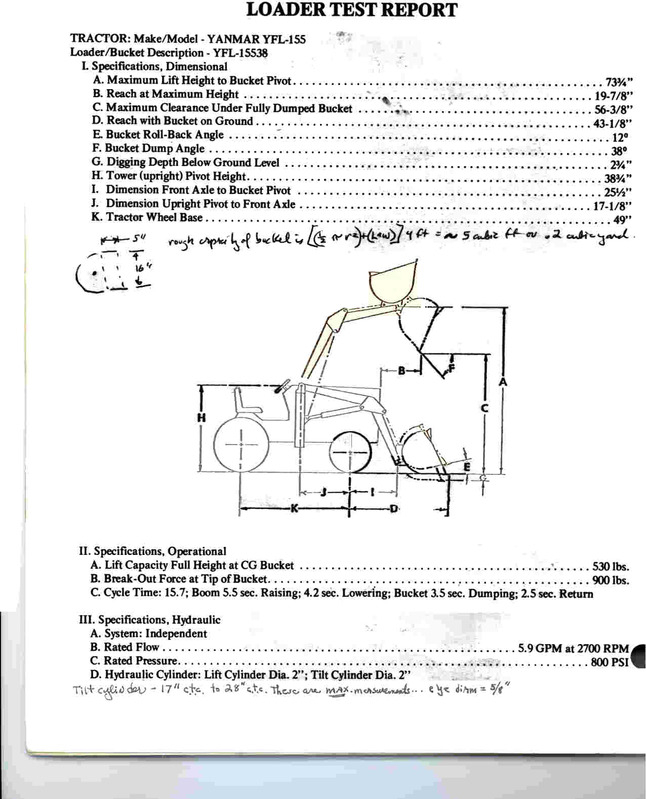

All I have on a YFL155 is the sales brochure. I think rScotty first posted it on the site prior.

Thanks for that! I honestly have no idea. I know there’s a pump behind the front bumper which I believe powers the fel. I added fluid where you can see the white cap on the top, but it started spewing back out when operated. I think it might be all controlled by the fluid in the transmission. I’m also fairly certain these are self bleeding systems, so I may have overfilled it. Drained some of what I added and it seems better now. The entire manual is way too expensive.
