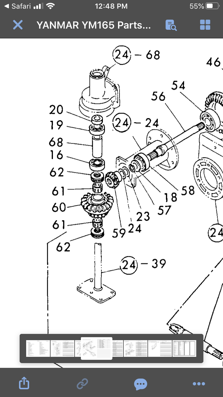

Hey all, grenaded the king pin on my little Yanmar. When I took it apart there was 2 sealed bearings, 2 wrist pin bearings, 2 non sealed bearings, about a 3” spacer and a gear. I’ve tried looking at manuals online but can not find one specific to a YM165D. Can anyone tell me where these bearing go on the shaft so I can get the tractor going again.

At the link, search for all the YM165 manuals. :)

Only the kingpin broke which I had another one machined just need to know which order the bearings go back on the shaft to put it back together!

Found what I needed after downloading the “box” app. Thank you so much folks this will get me back up and going! Much appreciated!
