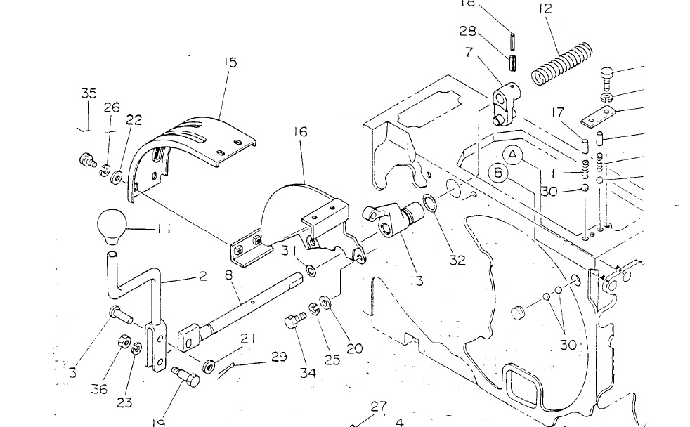

I am new to this forum and tractor ownership. I recently purchased a Yanmar 2610. I noticed some fluid (transmission fluid, maybe?) leaking from a hole beneath the seat (see pictures below). Please give me a hand figuring what this is. Is it a problem? How do I fix it? etc...
Thanks in advance for the help!

That is the other end of your PTO shifter shaft. We just got in a 2610D parts tractor so I took a couple pictures of what it has. It looks like your shaft has pulled out of the housing a little.

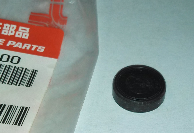

   / Yanmar 2610 Transmission Fluid Leaking - Please Help! #8
After looking at our parts tractor again, there is a little cap that goes into the hole where the end of your shaft is visible. Our parts tractor's cap is a loose fit right now so it turns a little with the shaft. I thought it was the end of the shaft I was seeing. The part you need is in stock (link below)
Yanmar Tractor Parts: COVER 15
