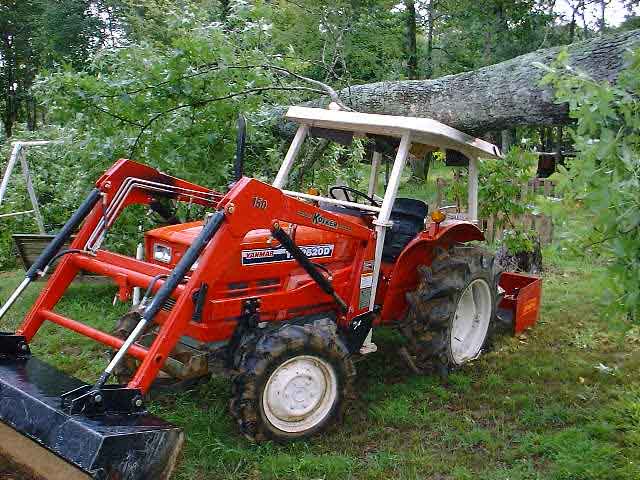

How tough is an YM2620? Check out the picture.

It shattered the fiberglass top and bent one bracket but the tractor itself was undamaged. The weight of the tree was so great that it mashed the back tire flat. I am surprised that it didn't blow the tire out. Another picture.
