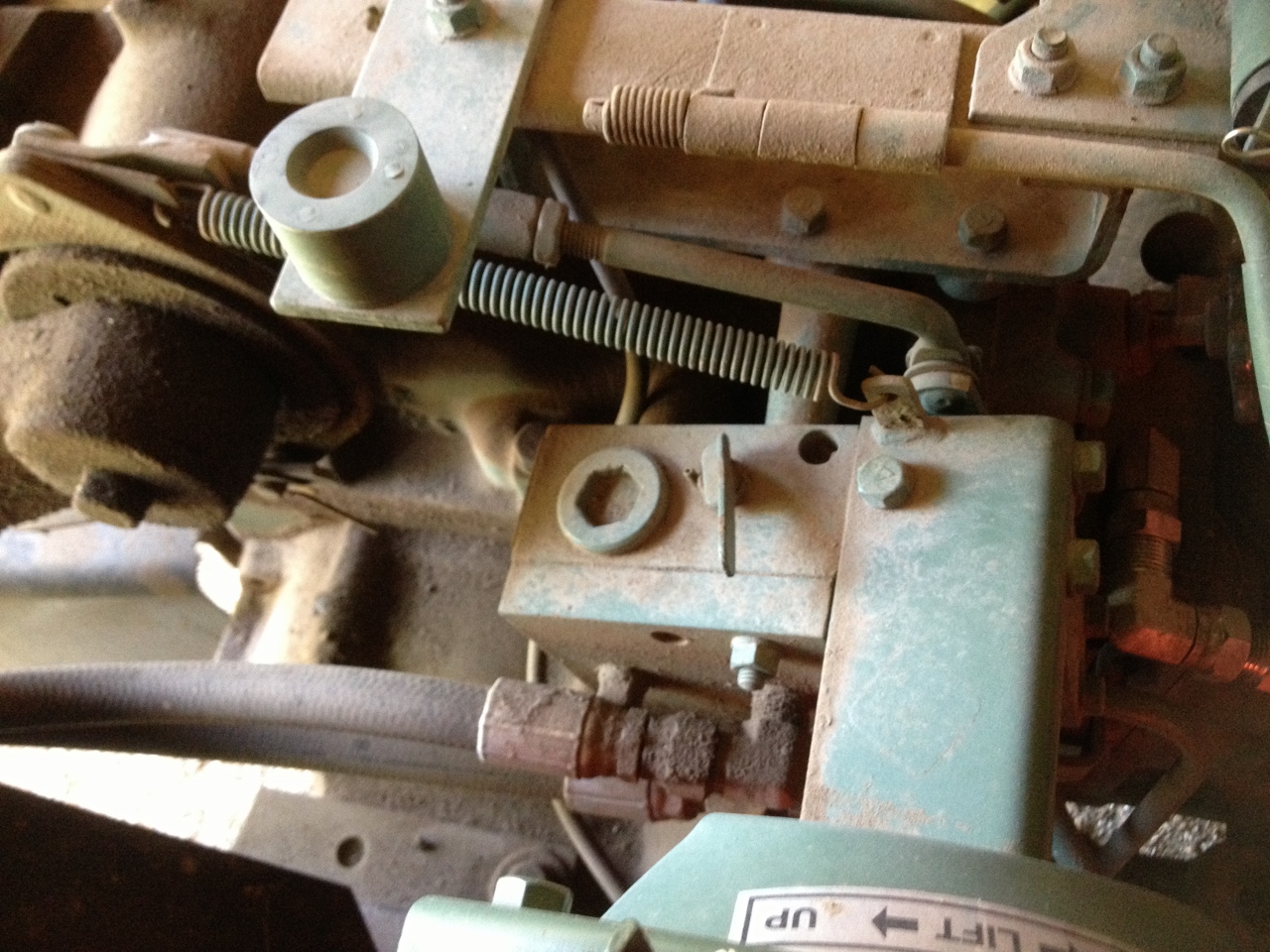

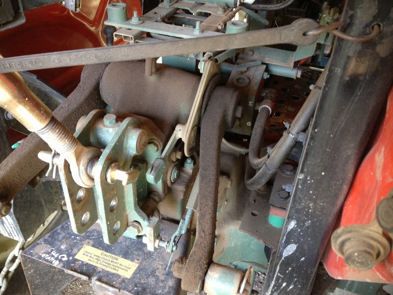

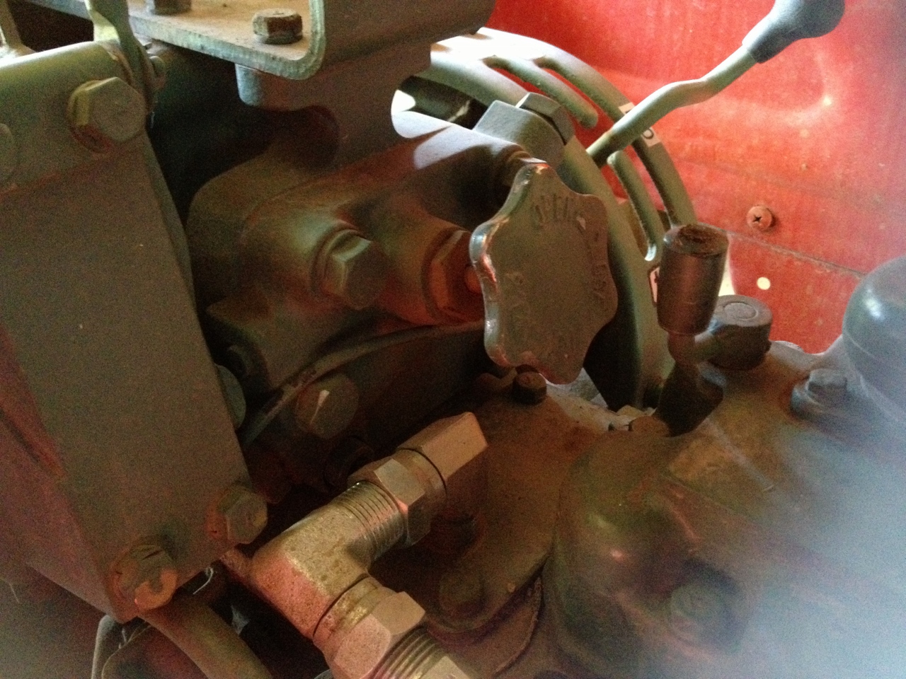

Do you have the auto draft control? Have a look at these pics and see if your controls look the same. There may be a couple ways they could be positioned that might cause the 3pt to not drop.
The little lever in pic 2 by the pipe plug is the speed setting. I can only imagine if it was set completely off it might cause it but I have never intentionally messed mine up to the point of inoperabillity going down anyway fwtw.
Otherwise I agree with the rest there could be something in the valving or possibly a mechanical issue with the rock shaft piston etc internally.
