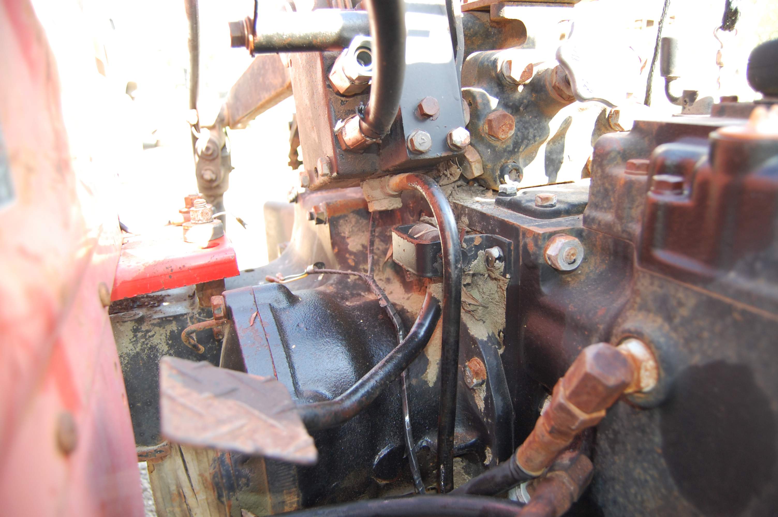

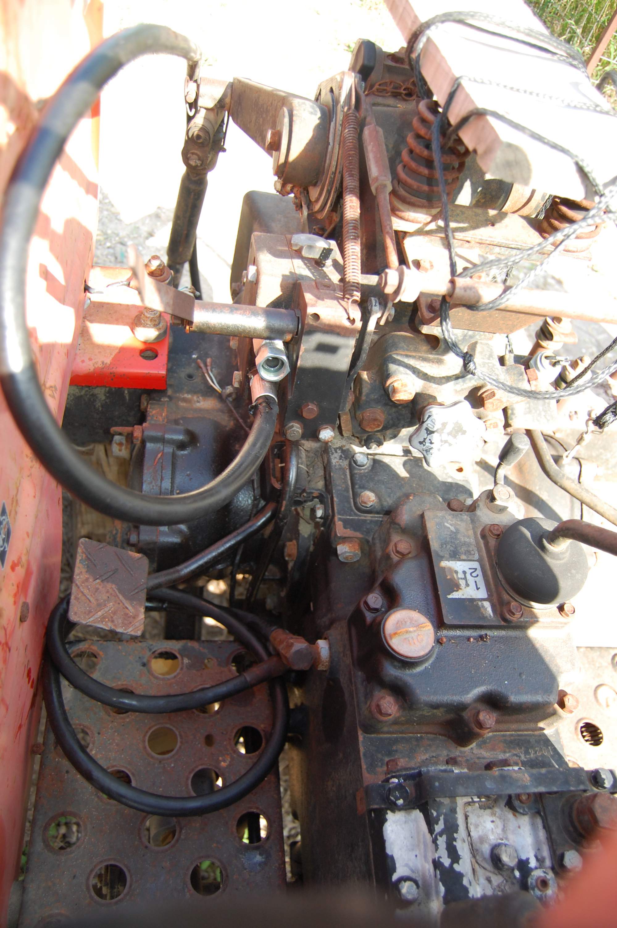

The bottom line coming out of the 3pt block and runs up and back around in back of the tractor where does it end up? That line should be going back into the other port over it to complete the hydraulic circuit- see my pics I have a loop of hose there out and back in.
That is the line that has the line pressure on it and if its going to lets say for instance the side of the trans it is simply returning fluid to the sump and wont power the 3pt block.

I redirected line out to loop to the in on control lever block.

the photos no longer represent todays status. I was asked to test for flow--fluid flows well...I then pluged transmission housing and rerouted the out flow to the in flow in block. I was also asked to check 3 point leveling system from releasing to normal control lever use.

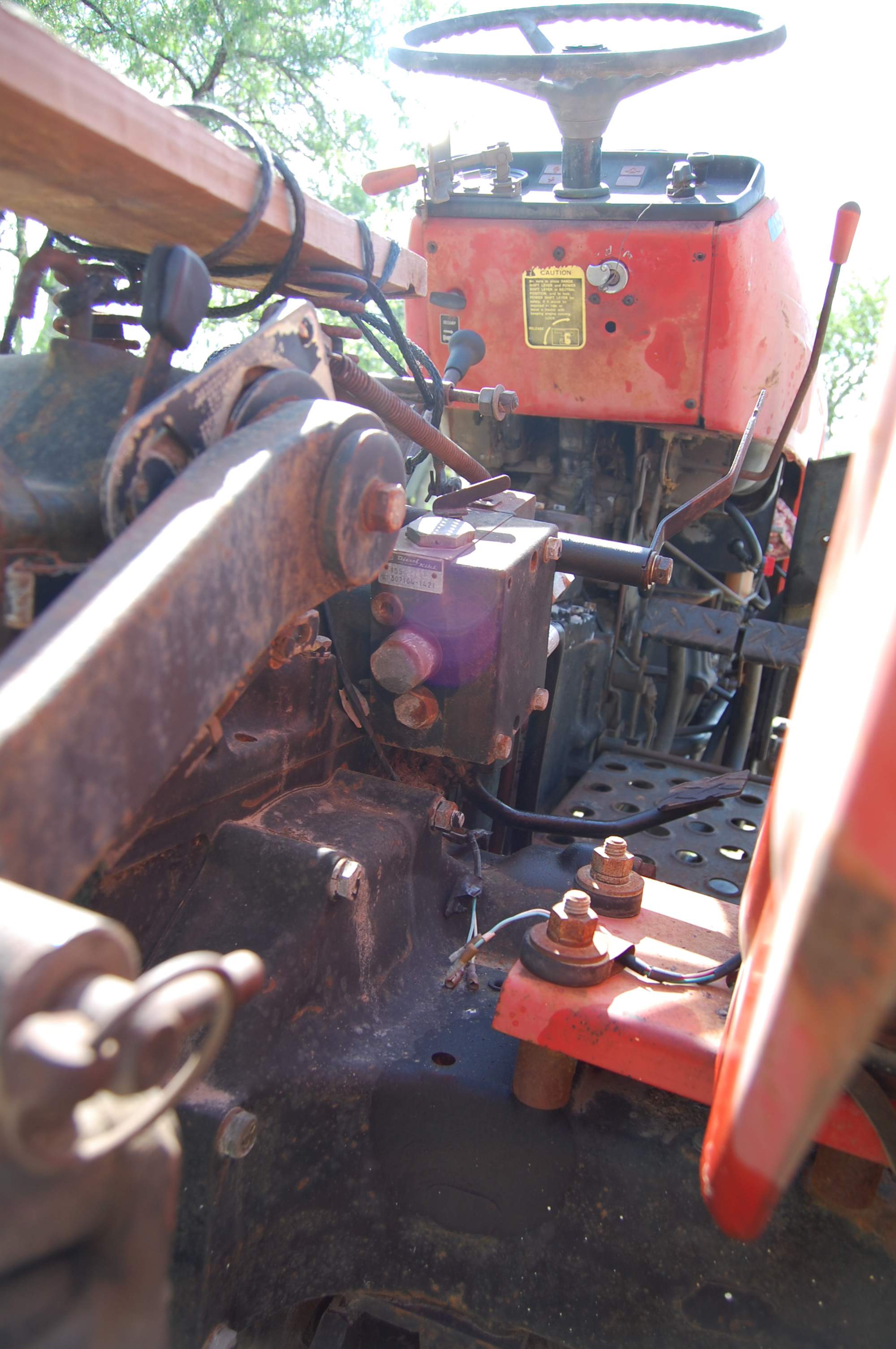

One of your initial pictures shows a line going in the side of the transmission and looks like the other end is laying loose. Is that correct? Is that the line you hooked back up to to the top opening on the control block? I want to believe that is the return line coming back from the leveling cylinder. Is that correct? Where is the control for the leveling cylinder?

The hose going into the transmission housing is a return you didn't need to do anything with the other end of it just leave it be plug it so mud daubers dont get inside is all that needs, it would be tied into the auxiliary valve for whatever was else attached that isn't there now.

My entire diagnosis so far is based on "that hose" being the problem that and the draft lever was flipped up on the rock shaft, simply because if there were not hoses coming out of the 3pt control block the hydraulic circuit would be as designed and we all would be more informed as to what to do. I have a almost exact duplicate of your tractor with the auxiliary hoses and all so I am doing the best I can to help and hope I am?
The one other thing that is a possibility at this point is the lines may be right now and the lift piston or something mechanical is bad?????
One more thing I wonder is where is the knob under the seat set is it out (open) or in closed? Mine doesn't even work any where I put mine its somewhat frozen anyway but I wonder if yours is closed? I cant make an educated comment on that like I say mine is inop just throwing that out open it if its closed I guess?
