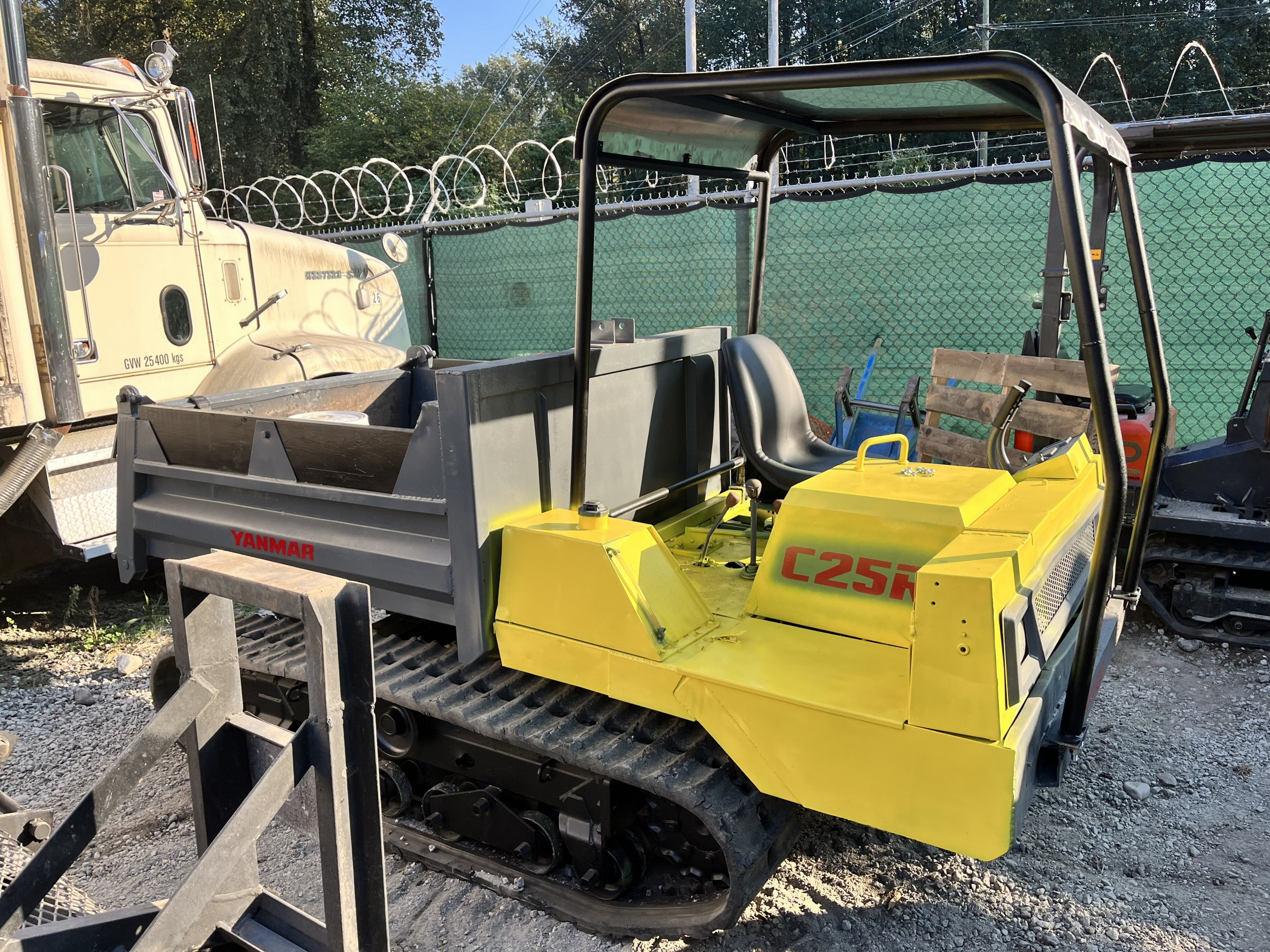

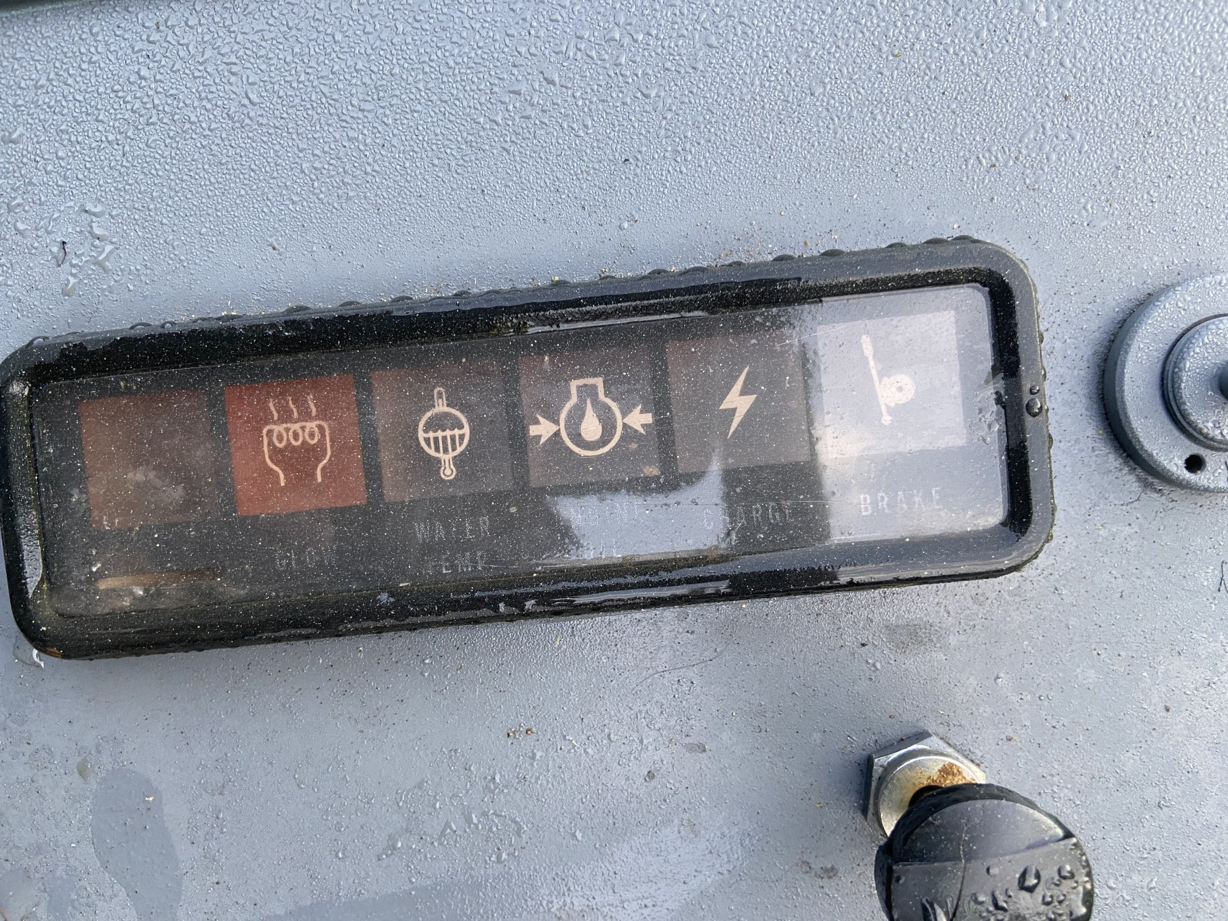

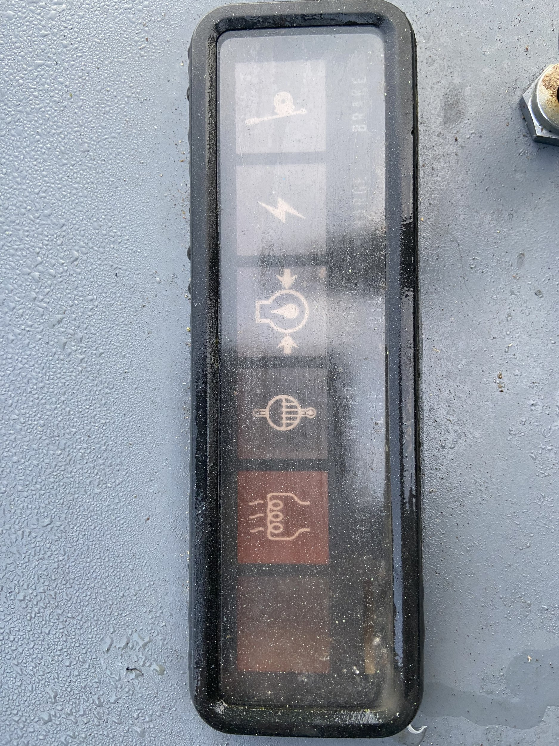

Looking for a wiring diagram for a late 80's mid 90's Yanmar C25R/YFW25R Crawler Carrier Dump.No power to instrument panel/glow plugs/hour meter. Can't seem to find specific manuals online. I am new to this machine. would be greatly appreciated.
Thanks

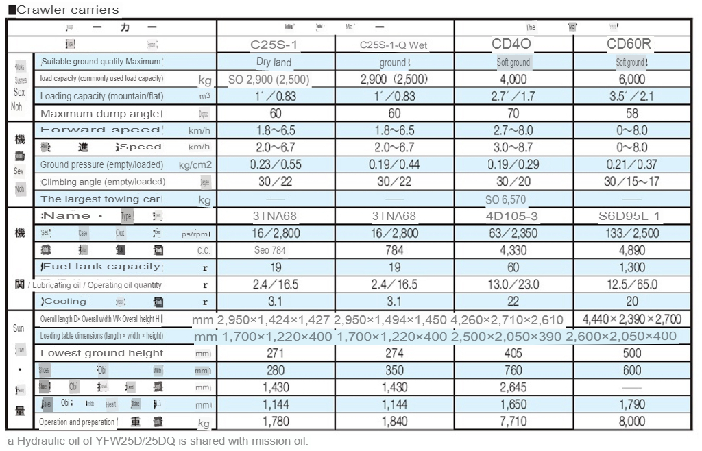

This is the original, next is translated via Yandex OCR

The engine is the Yanmar 3TNA68.
Why is it great to have this engine? It's found in many John Deere Gators and Deere industrial excavators. It's in the Deere F915 fairway mowers too. It's in the Komatsu excavators.
Yanmar has it in, C25W, C30R, C37R, YFW30D, and the very popular KE3 tractor. Typically, the 3TNA72 sibling engine is a direct swap and shares many parts with the 68.
