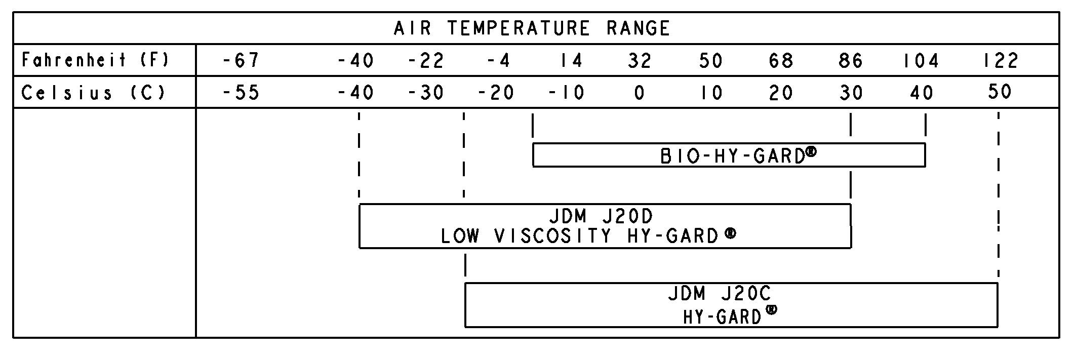

F, FF & FX Series all use J20C or TF500A as the hydraulic fluid. Same stuff.

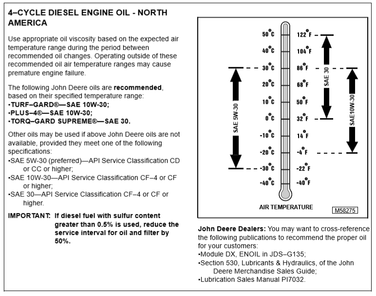

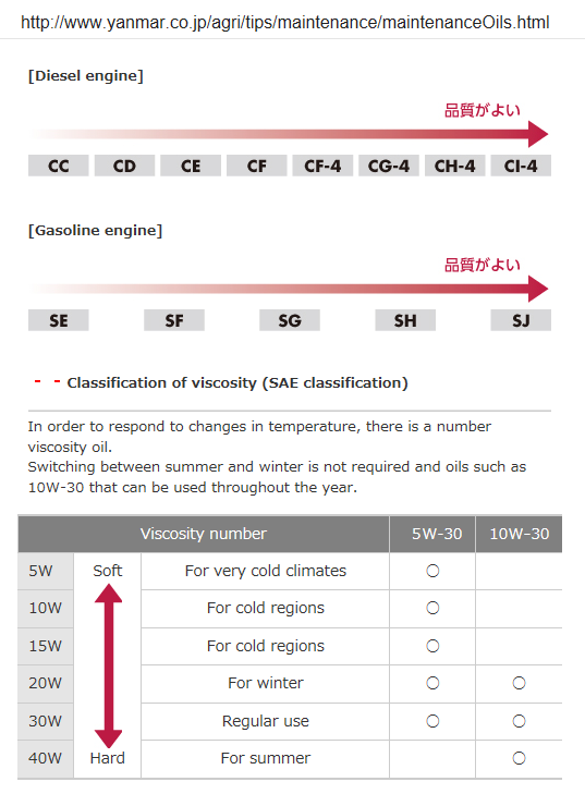

Yanmar Engine Oil grades. Shell Rotella T4 Synthetic 10W30 will do just fine.
And for the same Yanmar engines in the John Deere, the charts are basically the same too.

Because his machine is a Japan made to JIS standards, 15W40 is way too thick and will not cover the long diesel stroke, remain fresh in the piston ring passages and in time aid in creating more diesel soot.
Most if not all the Japan tractors avoid 15W40 because of the tighter passages and tolerances than old American Iron tractors.

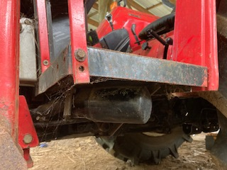

Question: The hydraulic filter that came with the tractor is about 5 3/4" long and 3 3/4" in diameter. The one on Hoye Tractor looks smaller, maybe about 3 3/4" x 3 3/4". I've attached a photo of the filter on my tractor. (I'm assuming this is the hydraulic oil filter!)
It's located under the left side of the floor where your left foot would rest. Is the one on Hoye Tractor OK for the FX32D?
   / Yanmar FX32D--any hints on hydraulic oil change? #9
I would feel very confident the one Hoyes shows will be a good fit for you. Too fine a mesh in the hydraulic filters can cause premature plugging. You can have confidence in the one they sale having the right internals.
