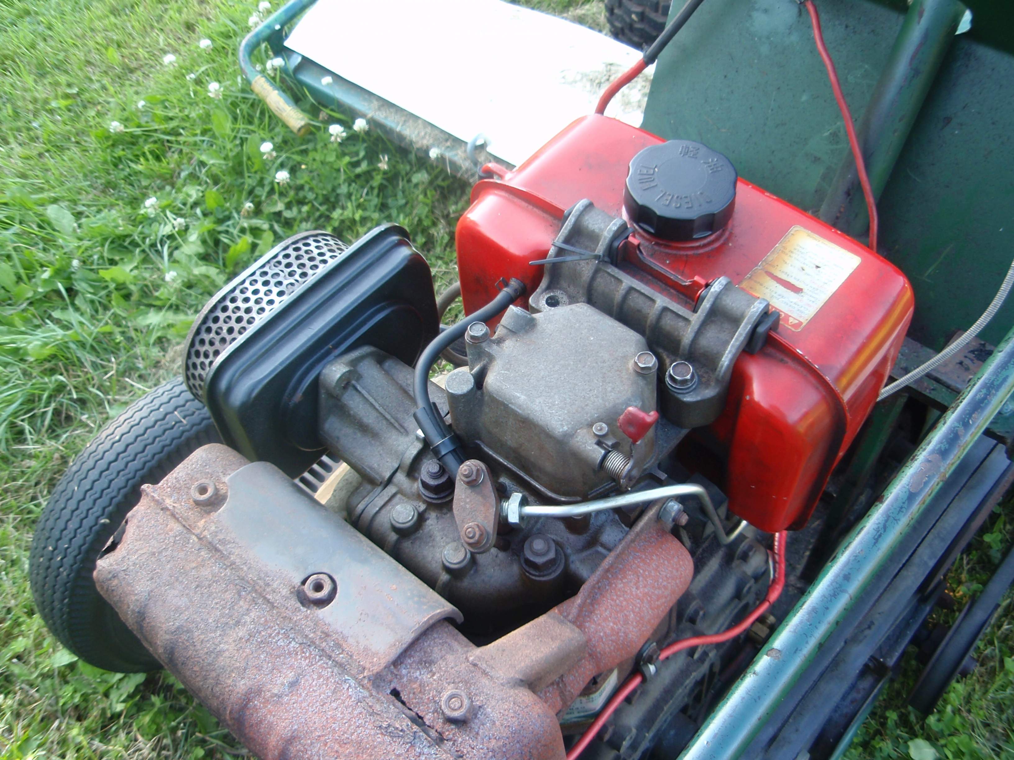

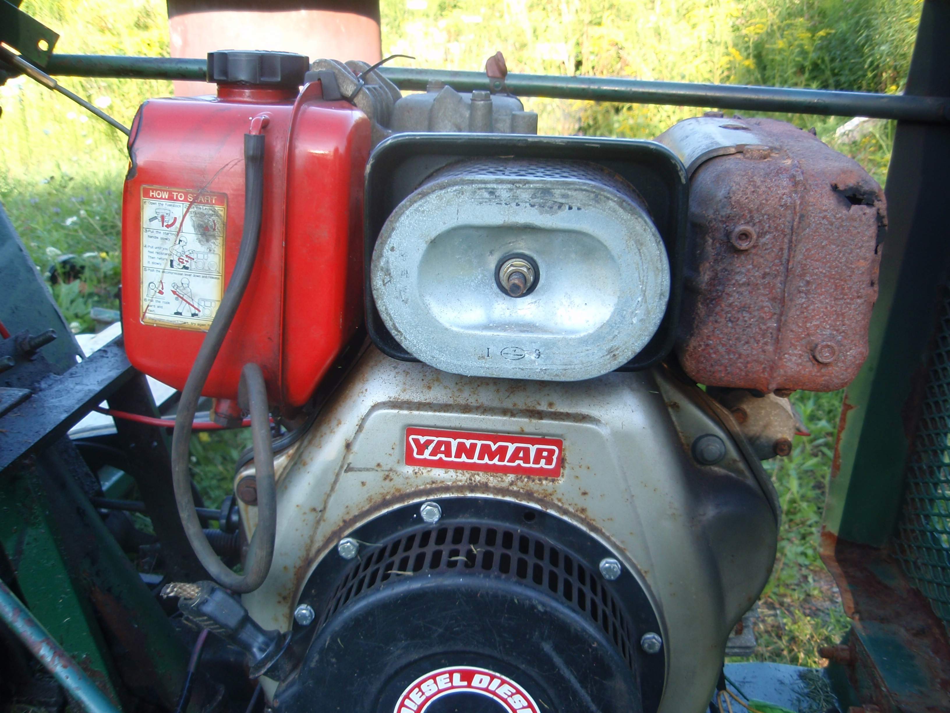

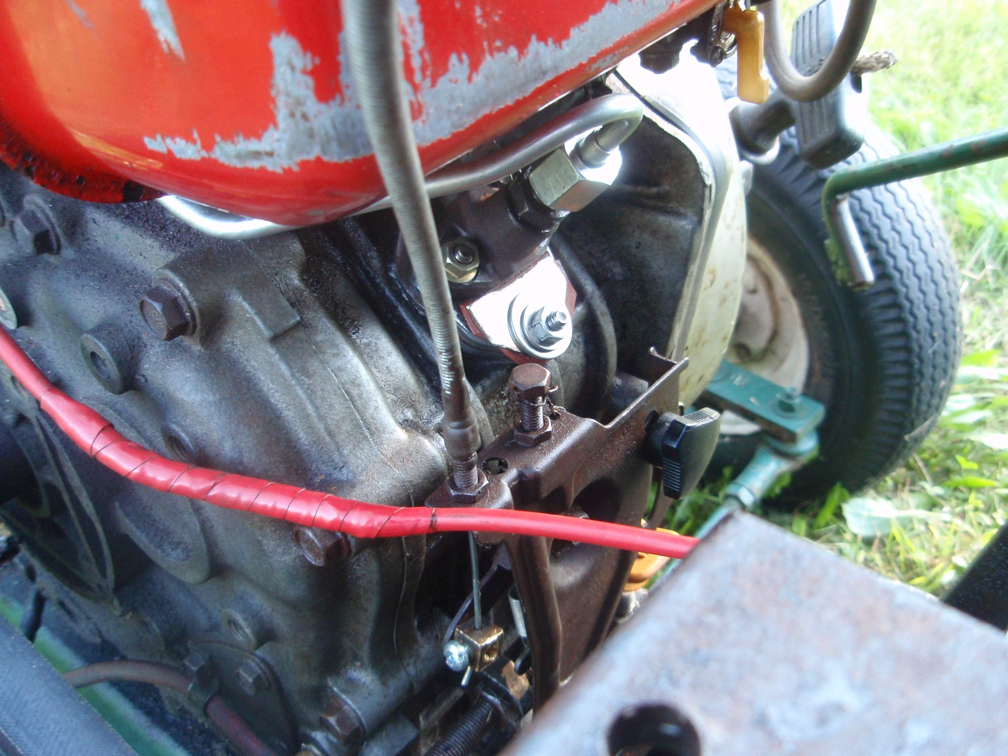

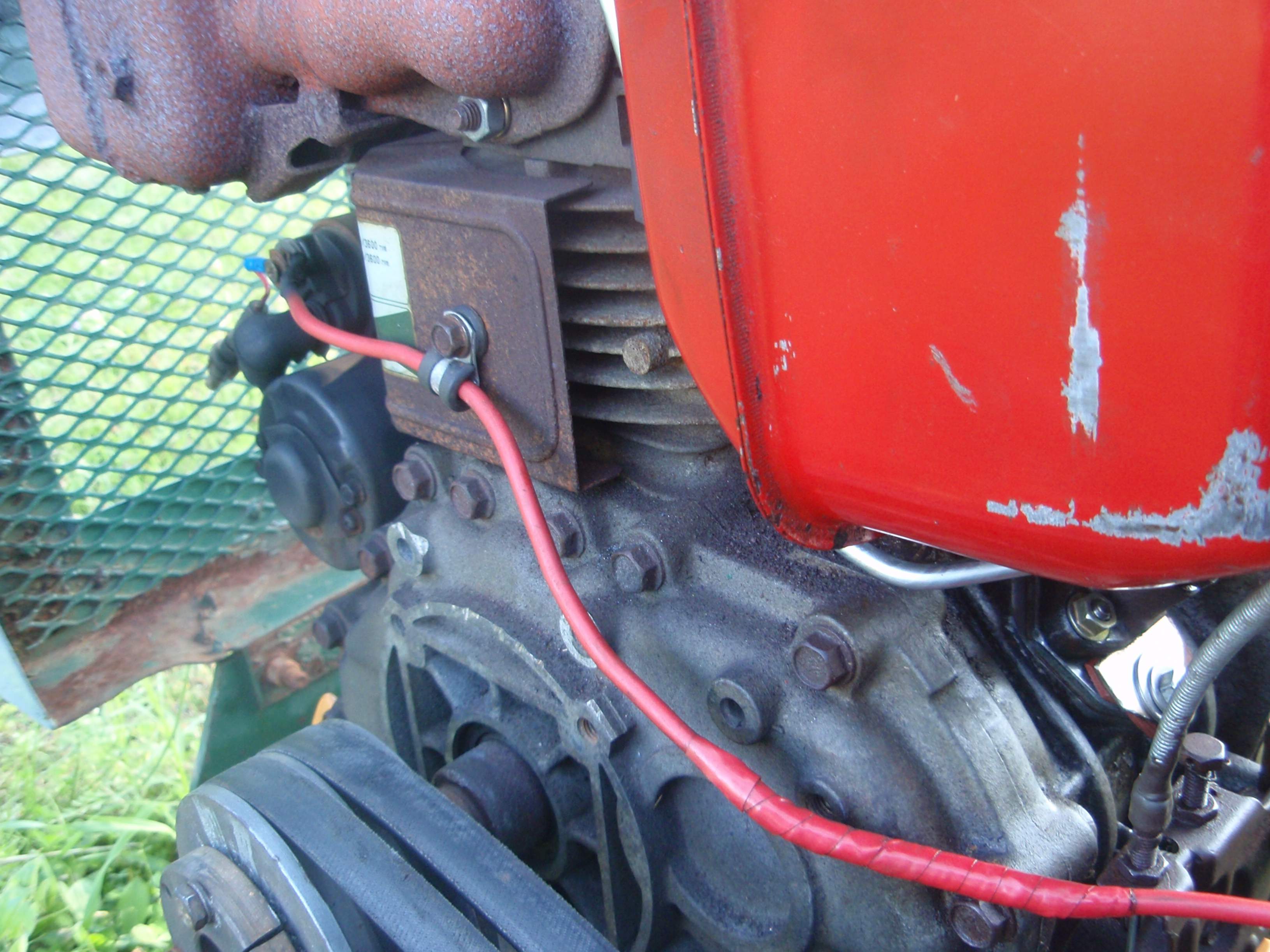

I have a 9hp electric start yanmar single cylinder diesel.When i move the throttle a little the engine revs too high.Could anyone tell me step by step the proper way to set the governor.My main problem is no low idle.The motor stalls out when i go to low idle.I don't want to pull the injector out until i hear from someone who knows more about this than i do

Welcome to TBN.
Post a few pictures of the motor in question and we can possibley help. Yanmar made a lot of motors and I am familiar with a few but not all of them. Or at least a model # and description like is it air cooled or liquid cooled. :thumbsup:

This motor is air cooled the model is yanmar L90AE-DE I have some pictures but am not sure how to post them.

Here are some pics.

Send me a pm with your Email address and i will send you a set of PDF service manuals for your motor. It covers hoe to adjust the governor. TBN does not allow files to be sent through the PM system. :thumbsup:
