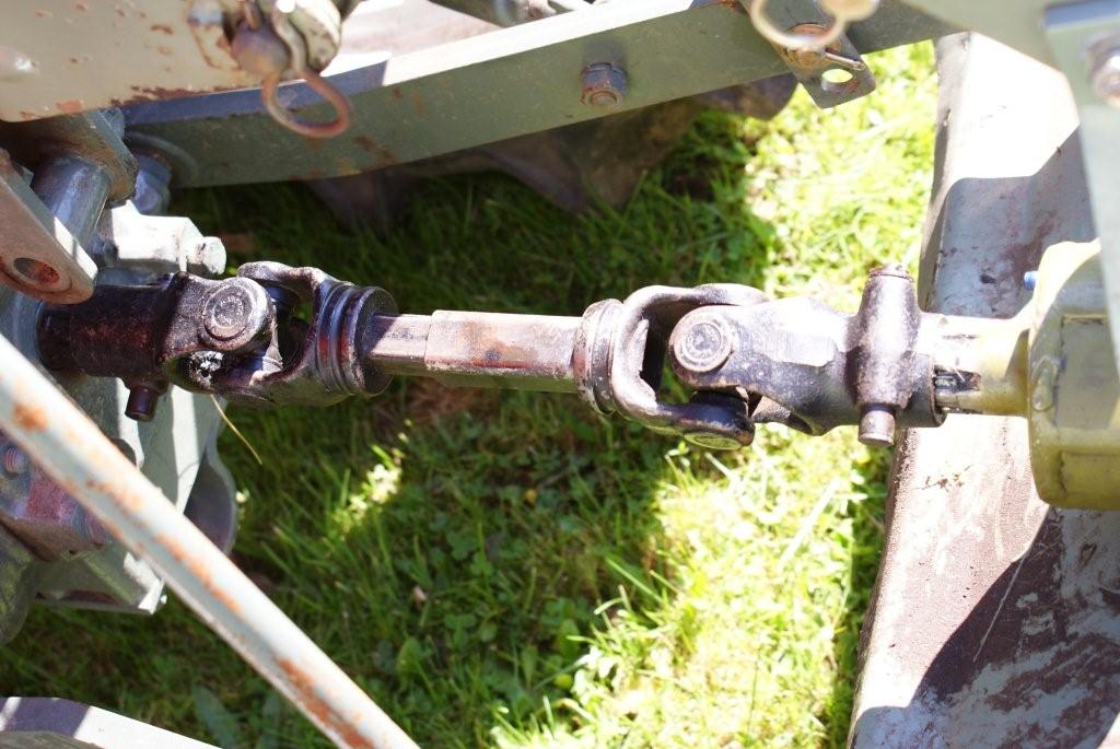

Thank you all for your feedback. I will take pictures and post them as soon as I can. Thank you "California" for setting me straight on the top linkage. I had it hooked up the other way. Does it make any difference whether the which of the 2 holes on the triangular piece is hooked to the tractor linkage? Right now I have it set on the bottom hole to keep extra distance from the PTO and U-Joint. I don't know how the sheetmetal vibrated off. I was looking at how it was mounted and the vibration would have had to have sheared the bolts because they are all gone! My tiller never came with the back wheels and the lower gate. All that was missing. I bought a slip clutch assembly to put in line between the PTO and the tiller because I read a forum about possible messing up the gears in your tractor's transmission and no shear pins on the tines. Does it make a difference where the slip clutch is put? It looks like it could slip right over the PTO, but I see that some people put it directly before the tiller. There were no instructions with it. Thanks again all. I will post those pictures as soon as I can. :thumbsup:

id put it at the tiller. Also i would use the lightest grade bolts recomended for tine connection grd 2 maybe?

Thank you all again for your feedback! I bought the slip clutch and installed it before the tiller. I assumed since I had a Sears walk behind tiller that I could use the tractor tiller to break up hard ground. I guess I learned the hard way! I've been breaking up the sod with the tooth bar on my front end loader and throwing out the big rocks. We have lots of rocks here on the Olympic Peninsula in Washington State. I am purchasing a landscape rake to get rid of the smaller rocks. I found out with this tiller that it works better when I go in reverse with the tractor in compound low-1st gear and have the PTO at around 2000 RPM with the tines going forward. They call this "conventional milling" in the machinist trade. The tines grab better and don't seem to mind the rocks as much. I installed the rectangular linkage as suggested by "California", and I don't have the problem with the tiller tines hitting the rear tires any more. It seems like it would be better if there was more distance between the tractor and the tiller and that the tiller didn't sit so perpendicular to the ground and was at more of an angle, but the reverse tilling seems to help alot when working in this particular soil with this tiller and keeps the **** thing from hopping around so much when it hits a rock. I had to cut the U-joint linkages to accomodate the slip clutch and cut a little too much off the female sleeve, but it still seems to be doing the trick. It's only come loose twice so far. I'm in the process of replacing the female u-joint. Anyway, thanks again! This is a great forum! :D:D:thumbsup:
