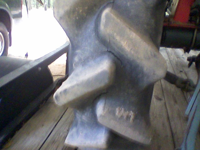

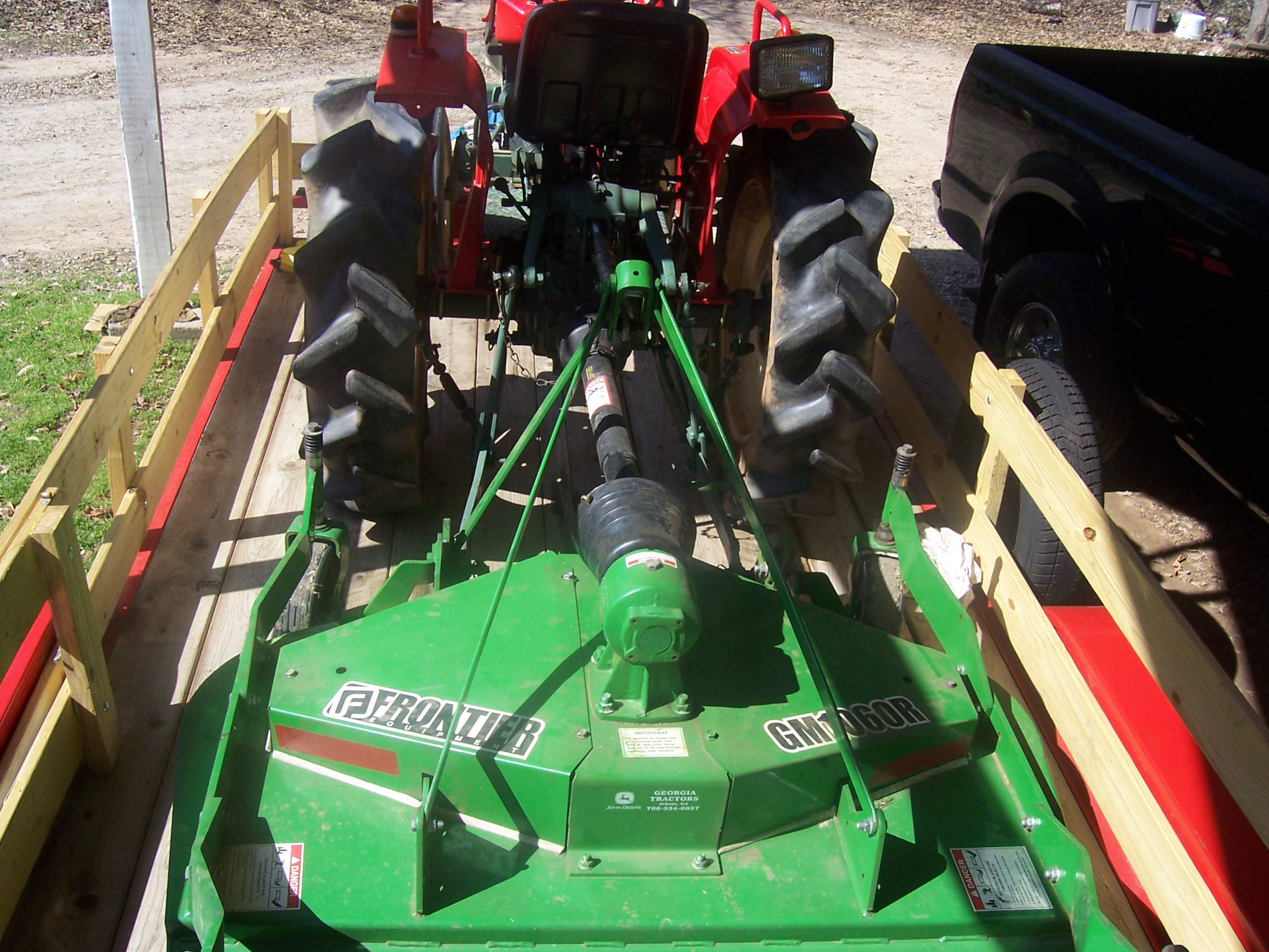

I use My Ym2000 in Dillard Ga. often. Mostly to BB. a road. It's easily a 45deg. slope. My Org. Ricer's work great but I believe I would have problems with a Turf Tire losing trac. in the Gravel. If it was me IMHO. a 4WD Lug Type would be the way to go. Hoye has a few Brand options to choose from. IMHO Thier EL.Cheapo Lug. would work just fine.;) Here my Rice Patty's Which have Extremely very little tread wear. If you look at Hoye's there nowere near as deep. But still will outlast the wear of a TurfTire.

Yeah my Ricer's still look near new too! they seem to dig way too easy but it doesnt aid traction, it only busts up the surface you are driving on. i think standard R1? ag's would do the job better and not chop up the surface as much. i have a set of them on the front and they aid in steering really well in slop and clay and its only 2WD. one day when i am bored i am going to chop the tapered edge off them to see how much it improves traction. as for reverse, well anyone who has had ricers knows the answer to that :thumbdown:
Yep! thats why I haven't changed them out. They work great when I BB. and grade my gravel Rd. I used Crush & Run ;) But the 2000 is basicly my lawn mower I use to FM a few acres with. For me I'm all level ground and my soil is Hard Ga. Red Clay so the more I loosen up the better. No FEL. on it and probly won't have.
