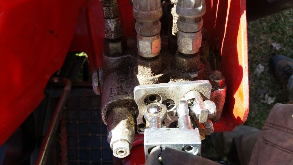

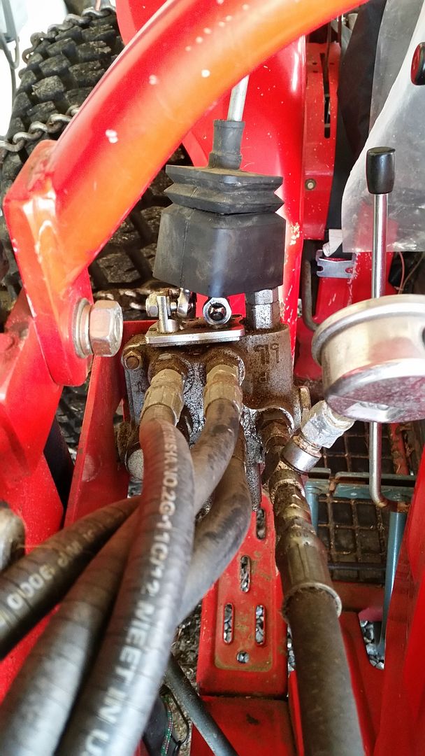

My Italian Made BLB loader valve bit the dust today that came with the V-tek Loader - you can see in the pictures number 2 where (no idea what its called) broke. This sucks but I wanted to get a valve with PB and float so all is not lost. I have no idea what a good replacement brand would be. Can you guys suggest a replacement that will fit the foot print I have? Just trying to find something bolt in to avoid lots of customization if I can avoid it. Thanks in advance!
First picture: Valve Mounting plate:
Second Picture: Tilt rod broken:

Hello,
I have a similar problem with a case 580, By luck I received a catalogue in the mail from surplus center, Lincoln, nebraska, Phone#800-488-3407. They sell a complete line of REPLACEMENT CONTROL VALVES. They have several that are specifically for front end loaders that are a fraction of the price of an original replacement unit. Let me know how you make out!
   / Yanmar with V-Tek Loader - Need Replacement Loader Valve Advice #4
That valve you posted looks to be a good deal.
If it will fit the confines of your space you should be fine .
Be sure to get the PB adapter.
I ordered the valve and a pb kit. I posted a similar thread over in the old yanmar equipment forum and one member asked if it would make any sense to run the flow from pump to loader then to power steering and then to 3pt. I was originally planning on running it from pump to ps to loader to 3pt.
   / Yanmar with V-Tek Loader - Need Replacement Loader Valve Advice #6
Steering should always have priority.
The flow should be split using a splitter, with the splitter having priority
