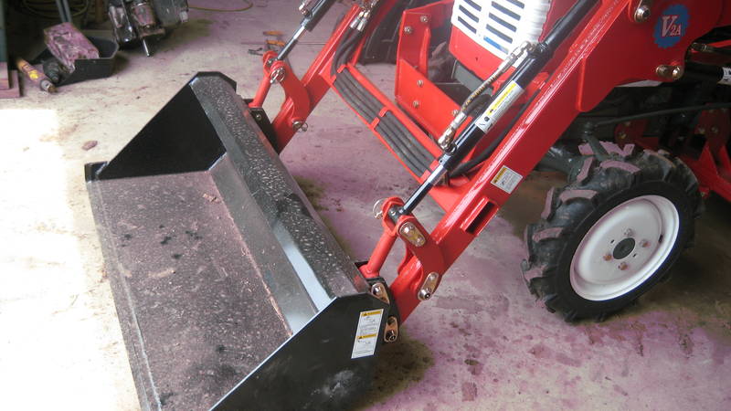

1st Model
Price:$7,000
Date Posted:06/08/12
Description:

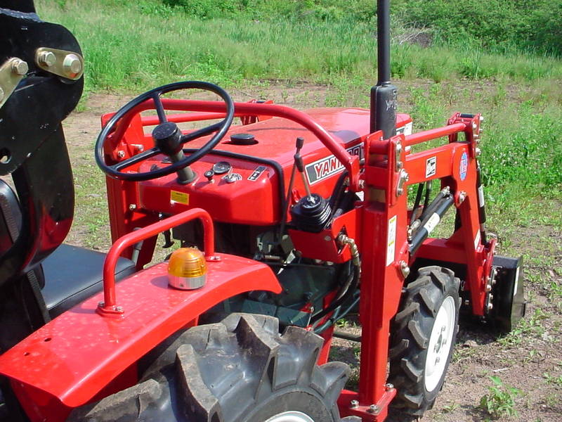

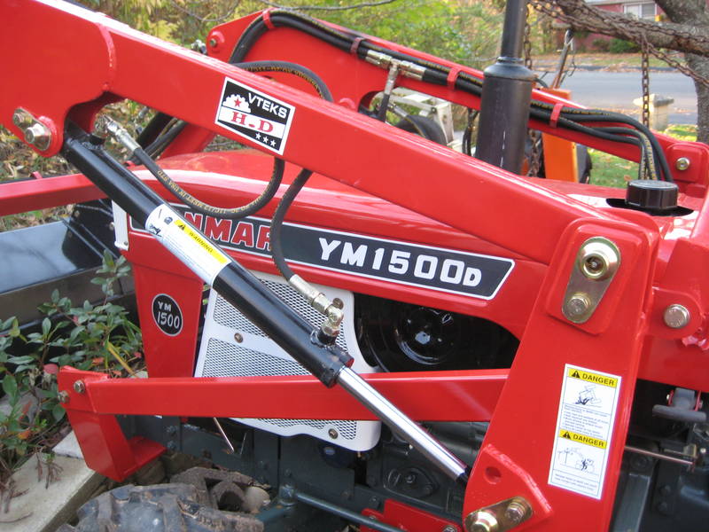

FOR SALE IS A YANMAR MODEL YM1500D, 4X4 COMPACT TRACTOR, 19HP YANMAR DIESEL ENGINE. TOTAL OF 6 SPEEDS FORWARD AND 2 REVERSE. NEW FRONT LOADER AND REAR 3PT HITCH, 2 SPEED 540 & 770 REAR PTO AND A CAT 1 3PT HITCH. TRACTOR HAS ONLY 16 HOURS ON IT.
YANMAR_YM1500D-6.jpgYANMAR_YM1500D-5.jpgYANMAR_YM1500D-4.jpgYANMAR_YM1500D-3.jpgYANMAR_YM1500D-2.jpgYANMAR_YM1500D-1.jpg

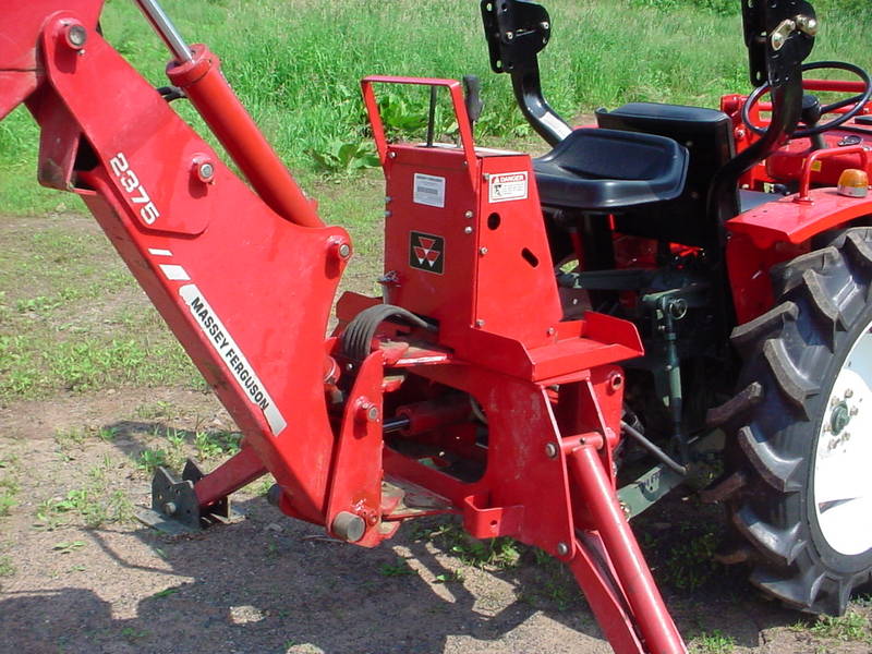

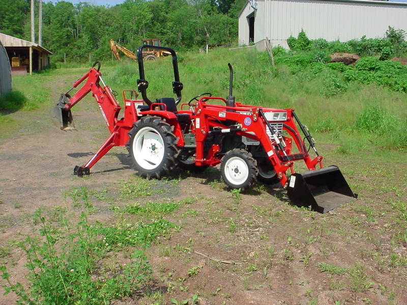

2nd Model
Price:$10,500
Date Posted:05/28/12
Description:

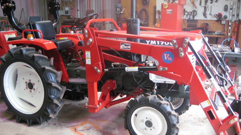

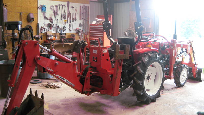

FOR SALE IS A YANMAR MODEL 1700 COMPACT TRACTOR, 4X4 WITH NEW LOADER,REAR PTO,CAT. 1 3PT HITCH AND A MASSEY/FERGUSON BACKHOE. TRACTOR HAS APPRO 16 HOURS ON IT. LIKE NEW CONDITION. PLEASE CALL OR EMAIL ME FOR MORE INFORMATION ON TRACTOR. YOU WILL NOT BE DISSAPOINTED.
YANMAR_YM1700-8.jpgYANMAR_YM1700-7.jpgYANMAR_YM1700-6.jpgYANMAR_YM1700-5.jpgYANMAR_YM1700-4.jpgYANMAR_YM1700-3.jpgYANMAR_YM1700-2.jpgYANMAR_YM1700-1.jpg

That's the guy in east haven.....right.....I bought some suitcase weights off of him...I don't think he has the capability to fix or support after the sale. Those tractors are Vietnamese refurbs probably from vn-1 tractors. The yanmar is a great tractor and many people have had good luck with the Vietnamese reconditioned but many have not. Read up on this forum and others on the refurbing process from vn tractors. Btw, my 2020D is one not sure where it came from but the V Teks loader is a dead giveaway.

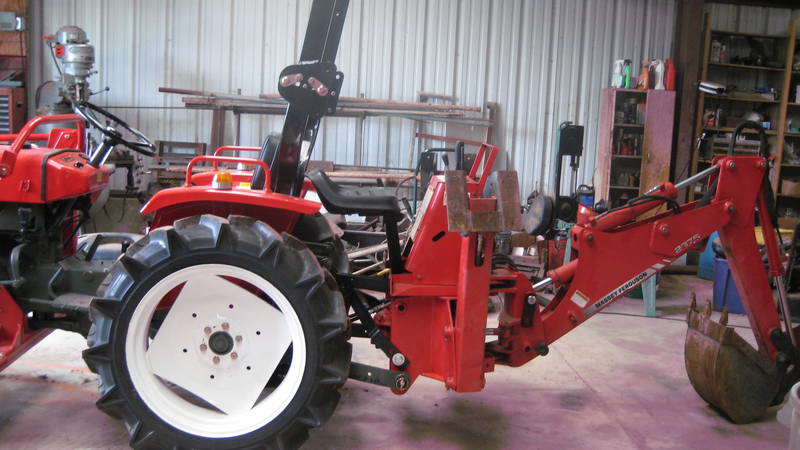

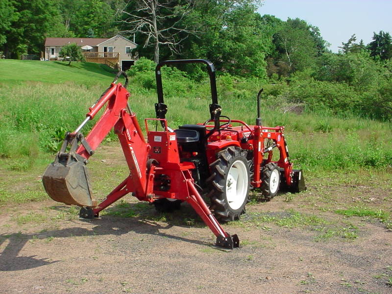

They are VN w/o a doubt the vteks loader is a dead give away as Scotty said. And just for conversation the 1700 has the self leveling loader and the hoe is a pretty decent self contained pto driven pump hoe and looks to be in great condition thats is a probably $2000-2500 piece alone. It may be too big for the weight of the tractor but it would come in very handy sometimes.
The 16 hours issue is another thing the VN's are known for apparently the hours are since rebuild is my guess it sure isn't true hours.
