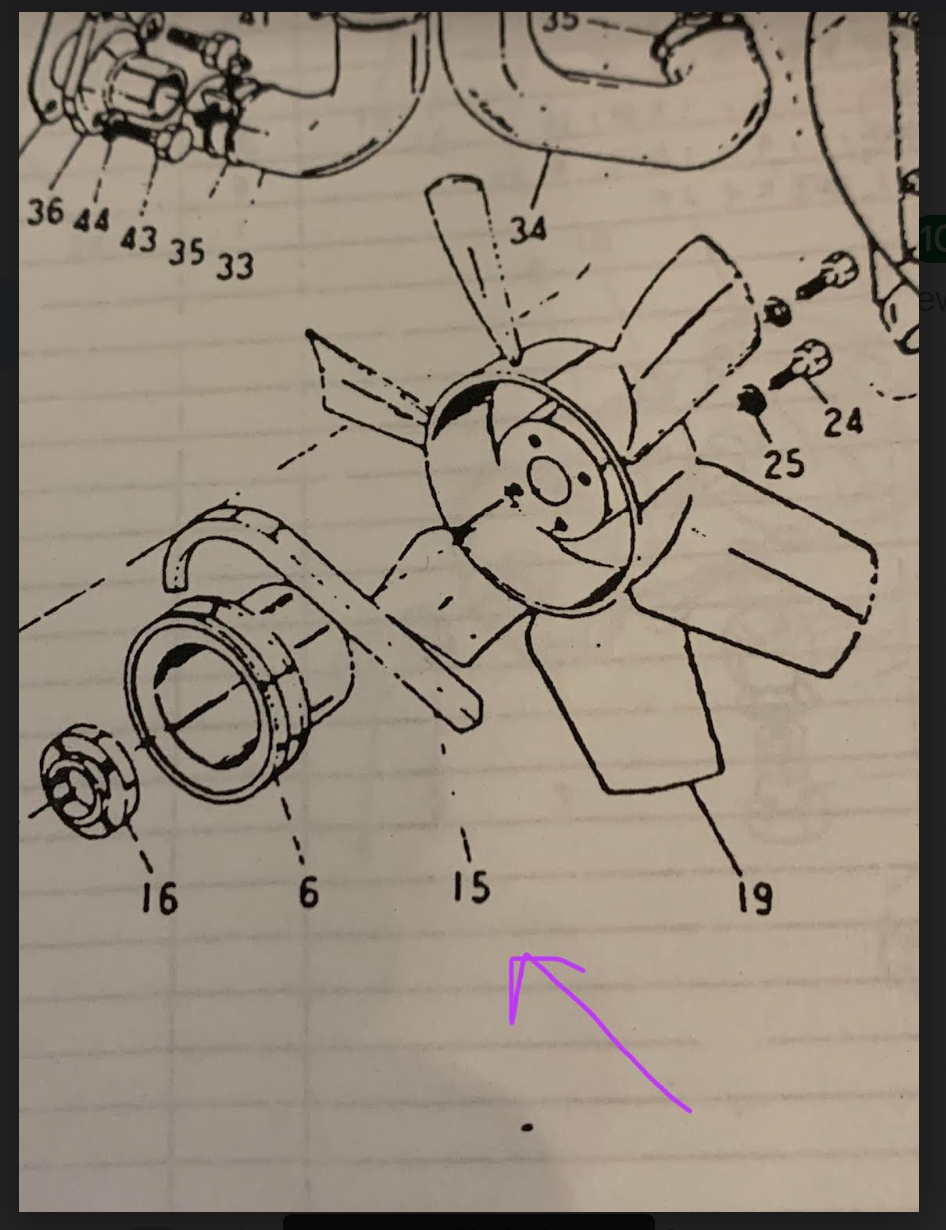

I am trying to replace my fan belt.

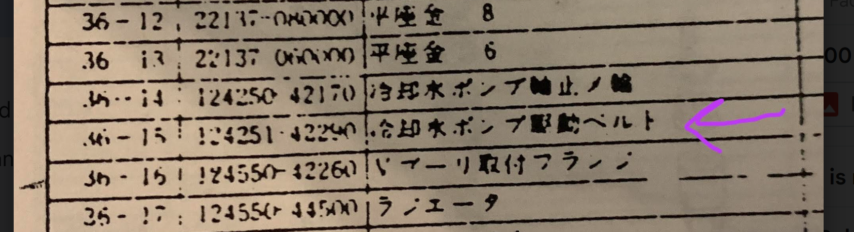

The Yanmar part number seems to be 12451-42290, but I don't have the specifications.
I wonder what would be an equivalent belt in a more available brand.
Any suggestions would be most appreciated. Else I will take the belt off and carry it to local shops.

I found it at Hoye tractor, just as I previously found other parts I needed.

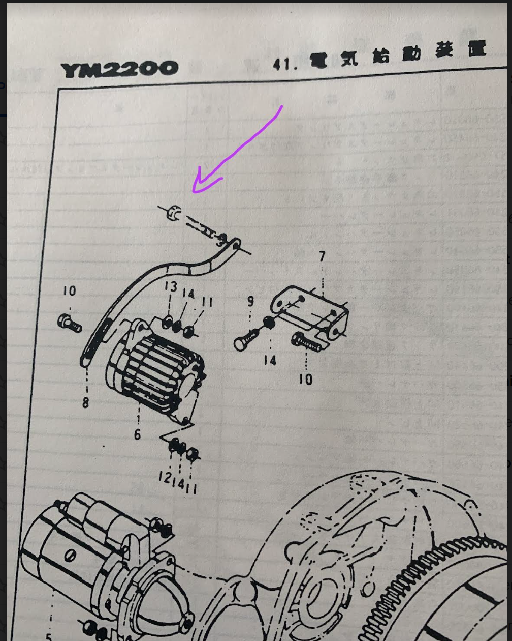

When I was installing it, I realized why the belt frayed; the tensioning bar was loose, having lost the bolt that attaches it to the block. The threaded hole in the block appears intact, so I suspect the bolt came loose and fell out. I am trying to purchase a replacement bolt, but I cannot tell the size and whether it is metric or not. My Japanese parts manual does not show a number for this bolt. Does anyone have an idea?
   / YANMAR YM2200 fan belt.
It is wider than the bolt that attaches the other end of the "tensioning-bar" to alternator, but I cannot tell its size.
Thanks
Robert

I figured out the bolt ! It is a M8 1.25 65mm long metric bolt with about 2cm of the tip having thread, the rest smooth.
   / YANMAR YM2200 fan belt. #7
So it's an M8 shoulder bolt. nice.
