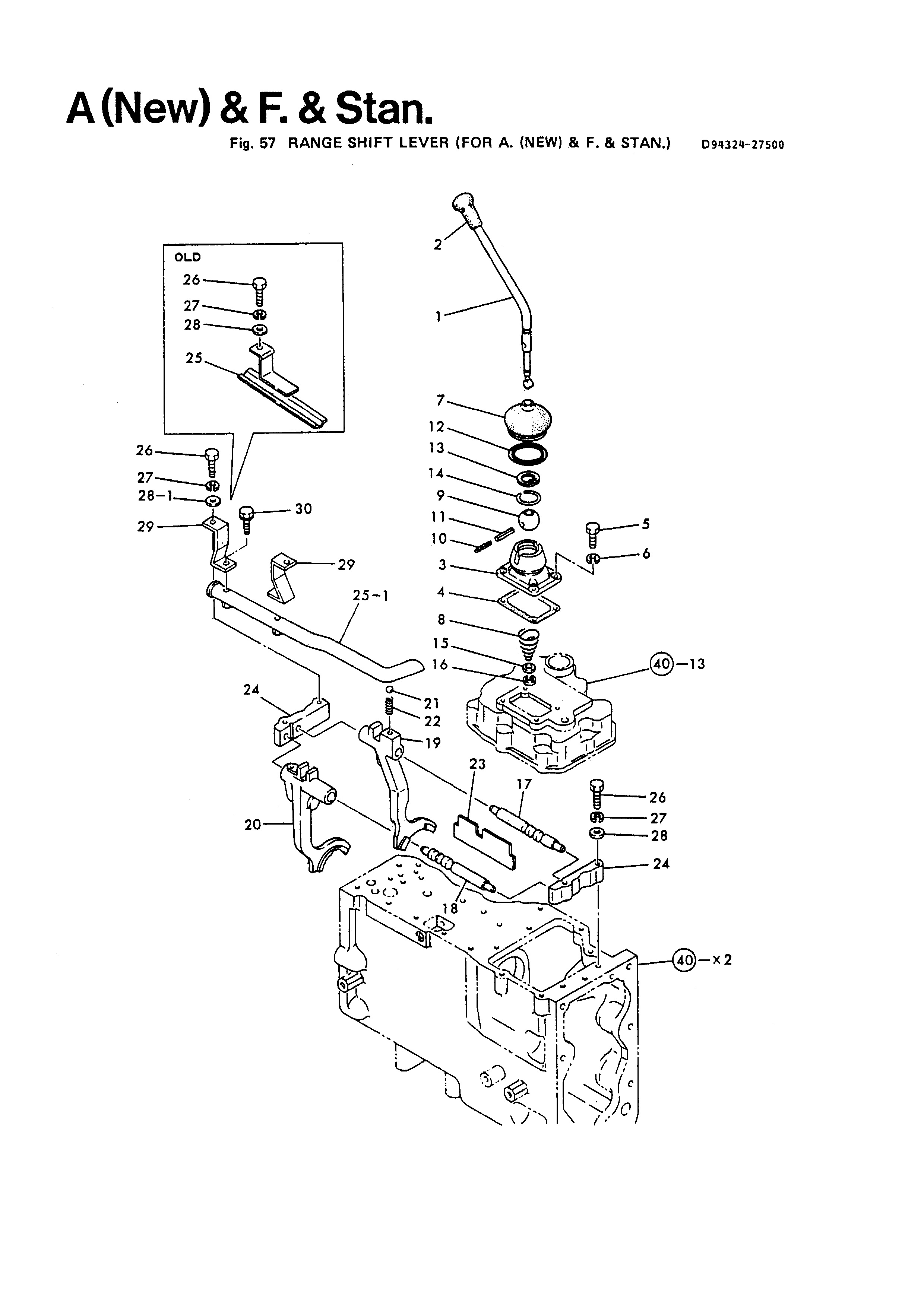

Is there something to inspect or adjust that will stop the tractor from popping out of gear when trying to use the 4th gear range? It does not do this in range gears 1-3. It seems like its not fully shifting into 4th. I can use 1st gear on the powershift with keeping slight pressure on the range shifter. When trying to use third its really trying to kick it out of gear. Any help or suggestions would be greatly appreciated.

Most likely you need to shim the shift shaft. All the ones I have seen have a loose shaft that partly slides with the shift fork. Put some shims over the end of the shaft so it can't slide, allowing the fork to fully engage in the detent.
   / Yanmar YM336D Popping out of 4th gear on Powershift
Thanks for the quick response. Can you remove the range shift lever from the top and put the shims in from there? I saw springs and ball bearings and got scared! Can you walk me through where the shims go? I really appreciate the help.

The ends of the shift shaft are smaller than the rest of the shaft, put 1/4" or 5/16" I.D. shims onto the rear end of the shaft to push the shaft forward, or you can use thin flat washers.
