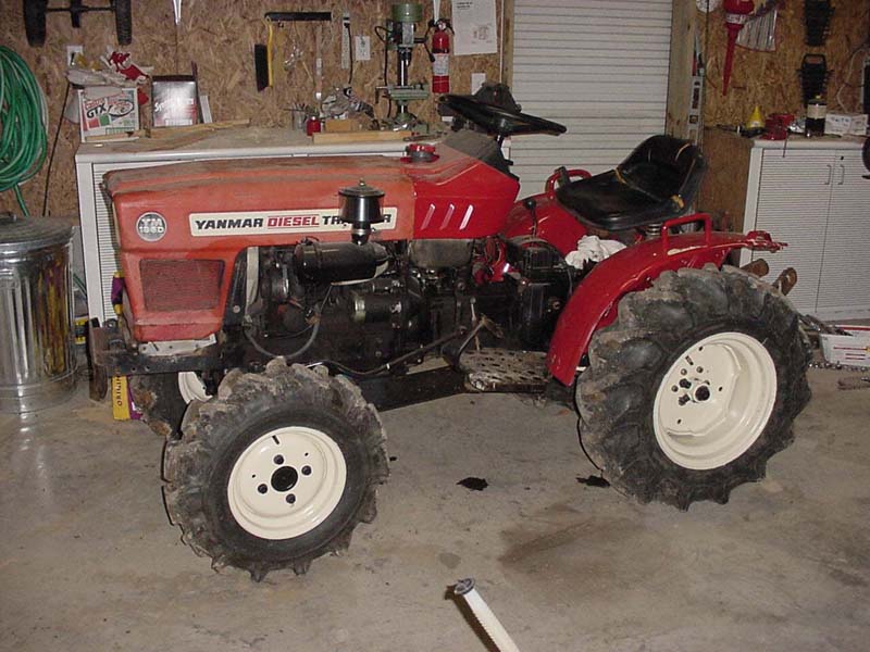

You can just pretend that your pic is mine, too. I just painted the hood, but mine looked just like that, last week. I got new decals and emblems with mine at purchase and will put those on this weekend. I guess i'd better post a pic, too
I can't figure out what's differant about your shifter. I can't see the column mount one and my range shifter seems to be set back farther. Is yours hydrstatic?
