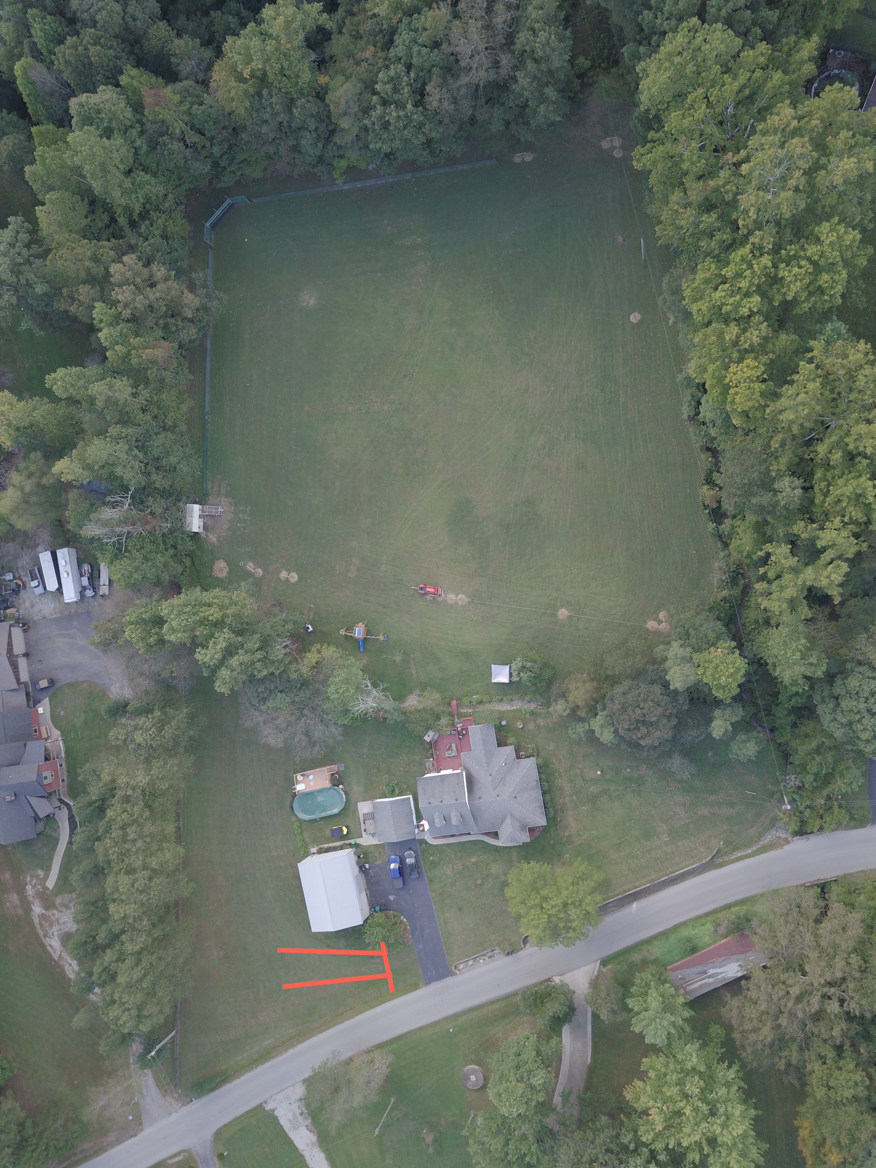

Hi all.
Family and I bought a house on ~5 acres back last fall. Since we've lived here, we've learned that there are some areas in the yard that water will stand, and it's becoming an issue. We have a field behind the house and the only way to get to it is to drive through the yard. I'm wanting to put a gravel drive, but it would go right through a place where water will sit. In fact, there has been standing water there for the past 2 months straight (in KY, so winter is here, but it's only gotten down to low 20s/upper 10s so far). I think a french drain system would do the trick, right? More specifically, Lowe's sells EZdrain by NDS, which should be as easy as trench, drop, cover.
What I'm trying to figure out is what is the best way to trench and how deep do I need to go. I have my Kubota L3560, but no backhoe. Neighbor has a bobcat and excavator I could use, but the smallest bucket he has is 24", so going to be more mess than anything. TSC has the $200 Middle Busters as well as the $200 Subsoilers. The MB may not go deep enough, and the Subsoiler wouldn't be wide enough of a trench (the EZdrain stuff is 8" in diameter). EA has their 18" Potato Plow (Potato Plow | Middle Buster by Everything Attachments) which should go deeper than the TSC MB, and be wider than the TSC Subsoiler. This ground is soft, full of clay, but not broken up before (that I'm aware of). Would something like the EA Potato Plow/MB be able to get me a 16" trench in a few passes? Should I drain to the ditch, dig a dry well, or just lay enough EZdrain and call it good (I've always heard a proper french drain system doesn't need an outlet; it will hold water until it can soak into the ground down below)?
I know I could rent a trencher, but I have several areas on the property that I'll eventually do this to, so I don't want to repeatedly rent a trencher, nor do I plan to do all my trenching in a single day. I don't mind picking up a $350 implement that will do the job, and find other uses for later.
I've got a few pictures in a Google Album that shows the area I'm focused on.
Drainage issues - Google Photos
The area is between the road and my shop, and also backs up to the blacktop driveway. My ultimate plan is to place a gravel drive from the blacktop, around the building and along the backside of the building to the fenced in field in the back. I took these pictures yesterday after a solid 14 hours of rain, so it shows how wet everything is right after a rain, as well as how much water the ditch sees. the ditch will run dry in a day, but that area in the yard will stay like that for weeks, even in the summer. Nasty to mow, and you can see tracks where I've driven my truck with a trailer through in a couple times, more than 2 months ago. What's the best way to get it dried up?
Any advice is greatly appreciated!

I've attached a drone photo and marked red lines where I'm looking to do this. The ground behind the shop (toward the neighbor) slops uphill, so I really don't need to go any further that way. The backside of the shop has a slight slope toward the road as well, and the area with red lines is really the low point in this quadrant of the property. I feel if I address it, I will see improvements in that whole area, as long as I do it right!

If you run 4" or 6" perforated field drain tile many of the trenchers that can be rented will do an 8" to 10" wide trench.
If you lay a strip of fabric down with a bit of gravel in the bottom then the perforated drain and fill with grave most of the
way and lay the fabric on top of the gravel and sandy loam you should get good drainage with a minimal cost.
I wouldn't bother trying to tee any of the lines 2 or 3 separate lines running to the ditch would be good.
In the ditch you may still need a dry well full of pea stone to keep the critters from going up in the drain tiles, then dieing
and plugging them up.

You have a tractor and loader?
Start at the low end and dig a trench the width of the bucket through to the wet area. Gota make sure it all slopes to the road ditch. Stockpile the dirt. If that works for proper drainage lay the drainage pipes and backfill. Sow new grass.
Working from the bottom the trench should constantly drain.

It take's alot less time and expense to move water through a shallow trough depression(swale) than french drain or other pipe. Look at it this way. You have to dig a ditch to install pipe,why not let the ditch do the job and save the additional time and expense of pipe,rock,filter cloth and backfill. The ditch need's to become wider as it become's deeper. The idea is have it more of a gentle slop so as to be able to mow along ditch without blades digging in.
I reccomend you buy,beg,borrow or steal a transit or other means of finding grade in several locations. Draw a map and mark elevations. The two key elivations are #1. place where water stand and #2 the closest place to #1 that presently drain's well. If #2 is 125 feet away from #1 ,it only need's to be 3" lower to drain well. Your neighbor's bobcat should make short work of it by lowering one corner of blade to cut a long vee trough. Us map created earlier to redestribute soil.
Something you said caught my attention. "The ground behind the shop (toward the neighbor) slops uphill, so I really don't need to go any further that way." How much run-off from the neighbor will you be handling? I've had two properties where neighbor brough in soil to raise their yard so that rainwater ran into my yard. My solution was building a berm along property line. In both instances,the neighbor didn't like it and said I should cut a passage way for their water to get past berm. In both cases I got them to admit to raising grade on their property then asked if they would like me to raise my grade so that not only would they have to deal with rain that fell on their property,mine would run onto them as well. If getting hold of a level is a problem,water levels are inexpensive and very accurate. You can easily operate 50 feet between points and some people go even farthar.
