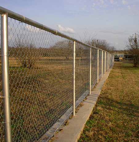

A while back, during my rainy period someone asked about a long lasting fence that was dog proof and was easy to weed under. This was my answer. That's 2 7/8 oil field pipe, the concrete is 24 inchs wide, with 3 peices of #3 rebar, center one welded to the posts. Wire support at bottom is 7/8 sucker rod. 2 coats red primer, 2 coats aluminum topcoat. Commerical 6' chainlink. I figure it's the last fence i'll put up in my lifetime.

I do a lot of fencing work and that's one of the nicest jobs I've seen in a long time. I expect you're right. That's about the last fence you'll ever need to build. Sure is nice to see somebody do it right the first time.
My hat's off to ya.
Slim
   / Yard Fence, dog proof, and no weeding! #3
A very good fence design. Sure looks neat and clean and should stay that way. Dog's won't easily be digging under that now, will they? John
