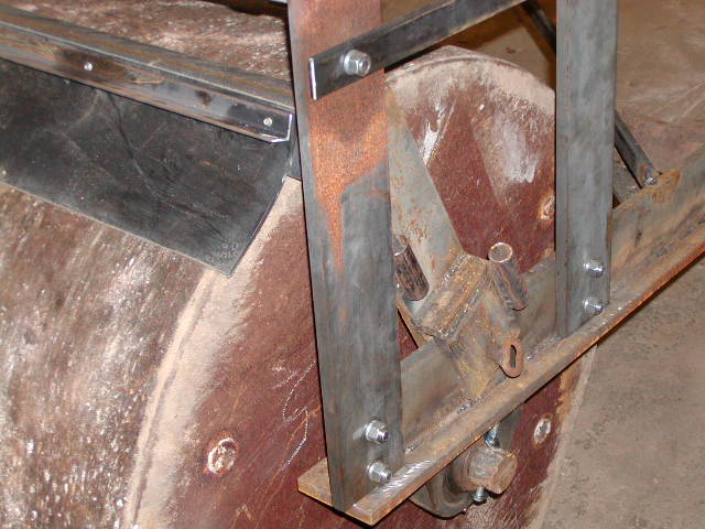

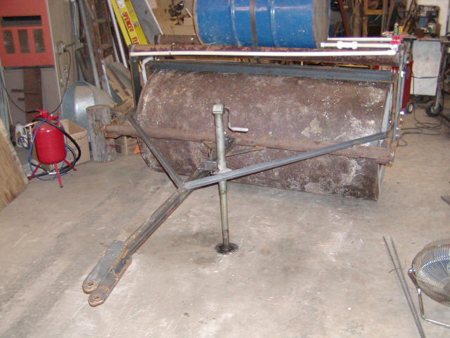

Attached is a picture of one I just made. Have only used it so far to roll some newly planted sod, & tried to smooth out some rough pasture but hope to use it for patching asphalt drive. Is 36"x74" filled with concrete. Tank was to thin walled to fill with water. I figured it would just punch dents in tank if not filled with something solid. I think it should be pushing, maybe 7000 lb. Also strapped a 55 gal water tank to top.

Another View

Murph,
Here is a picture of the roller I made from two old water tanks placed end to end with a 1/4" steel plate rolled and welded in place around them. The tanks have holes drilled in inside ends, and has a steel bar extending through to both ends and into the bearings. Each outside end has a coupling welded in with a plug. These plugs are 180 degrees opposed to allow water out and air in when emptying. Can't say anything about the weight other than I fill it with water first thing in the spring and empty it a few weeks later. It sure does squish the lumps and bumps of winter!

And one more pic - just for details

The axle is a 1" bar straight thru both tanks and into the pillow block bearings on the frame. The tanks also had side holes where valves were installed, but the roller steel shell is continuously welded down the side and all around each end to make it water tight.
