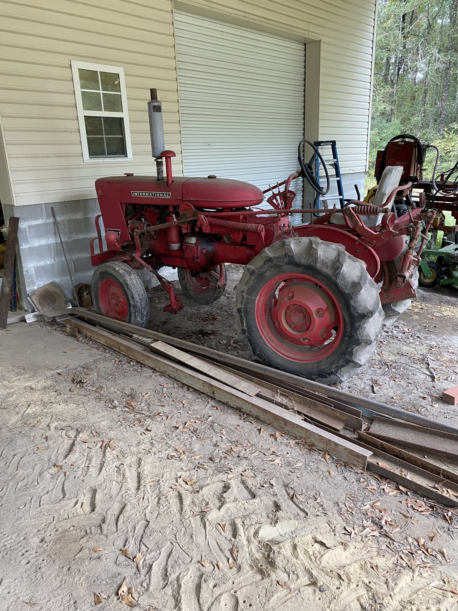

Any way of telling what year my inherited Farmall Super A is. The label under seat is unreadable.

Zoom in on the left side of this 140 and you'll see a silver serial number plate. Does yours have one of these?

Look at the right front corner of the engine block above the magneto/distributor drive near the head. There will be a flat boss there. On several of my tractors, including one Suer C, the S/N is stamped in there and all match the S/N stamped in the tags. You may have to clean/scrape/sand/brush to get paint, etc. off but there should be a number there.
