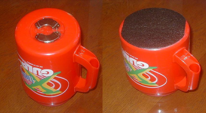

Here is my version of the now infamous Chalkley Cup. I must say that that bad boy is even bigger in person than it seems in the photos. Unfortunately there are no 7-11's around here so I can't take advantage of the 88¢ refills. Anyway my cup is basically the same as the others except I cover the entire bottom. I used that roll stuff they sell at Sears to line the drawers of your tool box. It's thin enough so as not to interfere with the magnetic forces yet provides some grip and paint protection.

Got'a have one! It looks like a magnetic cup that would stick right on the fender. Orange too! Where can I get magnets like that! What an awesome promo idea for Kubota.

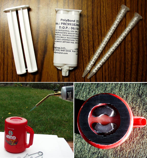

I have ordered some magnets and I want to build a magnetic cup, but I don't know of any glue that will stick to the plastic of the common plastic cups. Does anybody know which glue works on these plastic cups?

The cups are made of polypropylene, which is indeed a difficult material to glue to. The only product I found which is actually made for that application is made by Nbond Adhesives Int'l.
I went kinda nuts researching and experimenting with the stuff, but I'm almost a year into my field test, and my magnets and cup are still one. It may challenge your attention span, but you can read the details I included in this post.
The picture that goes along with that post is no longer accessible, so I've attached it here again.
Good luck, and keep us posted. /w3tcompact/icons/wink.gif
