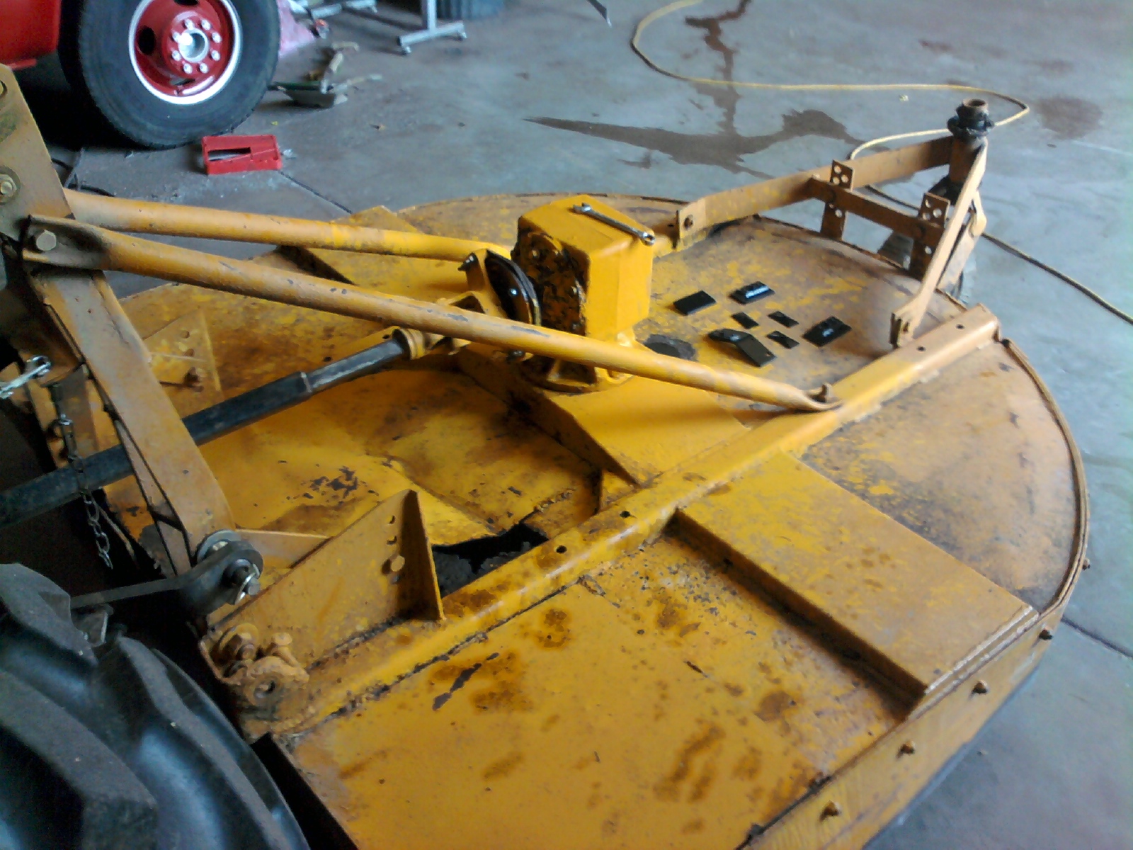

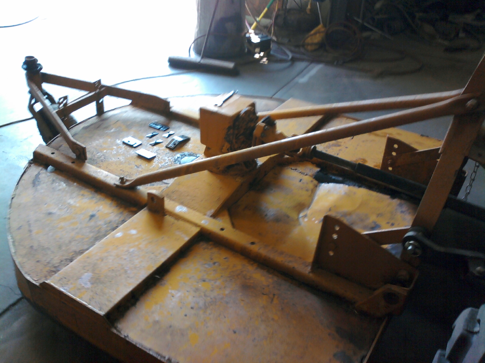

Be looking for new blades and every place I have been first thing they ask is what brand, so I have no idea what to tell them. Can anyone please help id from the pics? I do have one place I think will be able to match up the blades but it will be a few days before I can get over to there location 50 miles away. Thanks

I can't help you with the brand, but you can get replacement blades by measuring the hole size, width and thickness of the blade, and length from the center of the hole to the end, and direction of rotation.
It's much faster and less expensive to shop online or call around than to run all over the world looking.

Looks like a Servis or maybe a Modern?? I feel we can supply the blades with the width, length, thickness and size of hole (probably 1 1/2 inch)? Ken Sweet

I pretty sure its a sidewinder, without the tire drive. Still in business. Need parts? 800 343-5825 You can direct order.

The round pipe supports, and the trapezoid gear box mount give it away. They're in Missouri. They are absolutely the finest rotary cutter ever built, especially the tire drive units.
