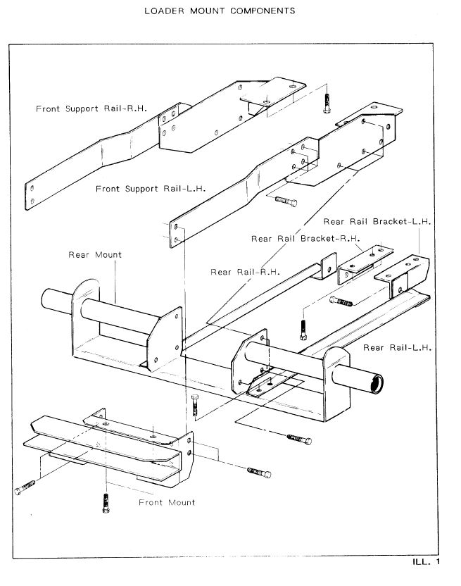

Have seen metion of steel members other than the member that loader connects to .looked like it went from member that loader coader connect to to mid tractor.this appeared to be angle that connected to cross member tracking back and connecting to possibly rear axle portion .Any insight on this topic.
Thanks 336 d with yfl 1575 loader.

This isn't quite what you asked, this isn't an OEM Yanmar loader, but the second and third photos in this old thread might give you some ideas.
Not shown in those photos, there are also arms forward that bear weight down on the front bumper.

Is it the rear rail in the picture below?
