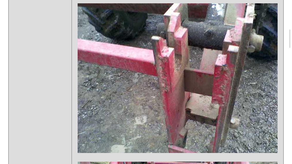

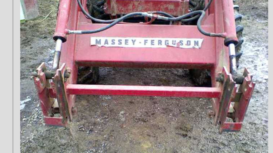

If I can I will attached a photo of something I have seen done. You will need some fairly good fab skills to build this.

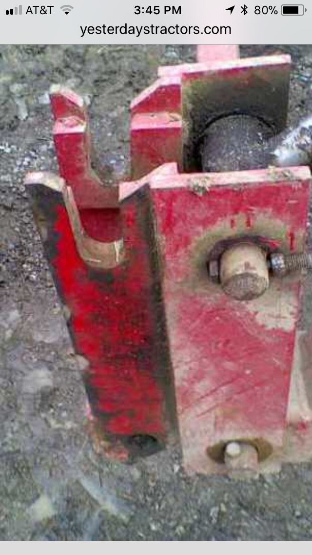

This Quick attach Bucket was easy to Remove or put back on. Similar or same setup. Only a couple yrs. old and JD Frontier so I beleve it should be common and easy to get parts. Repair/Replace
