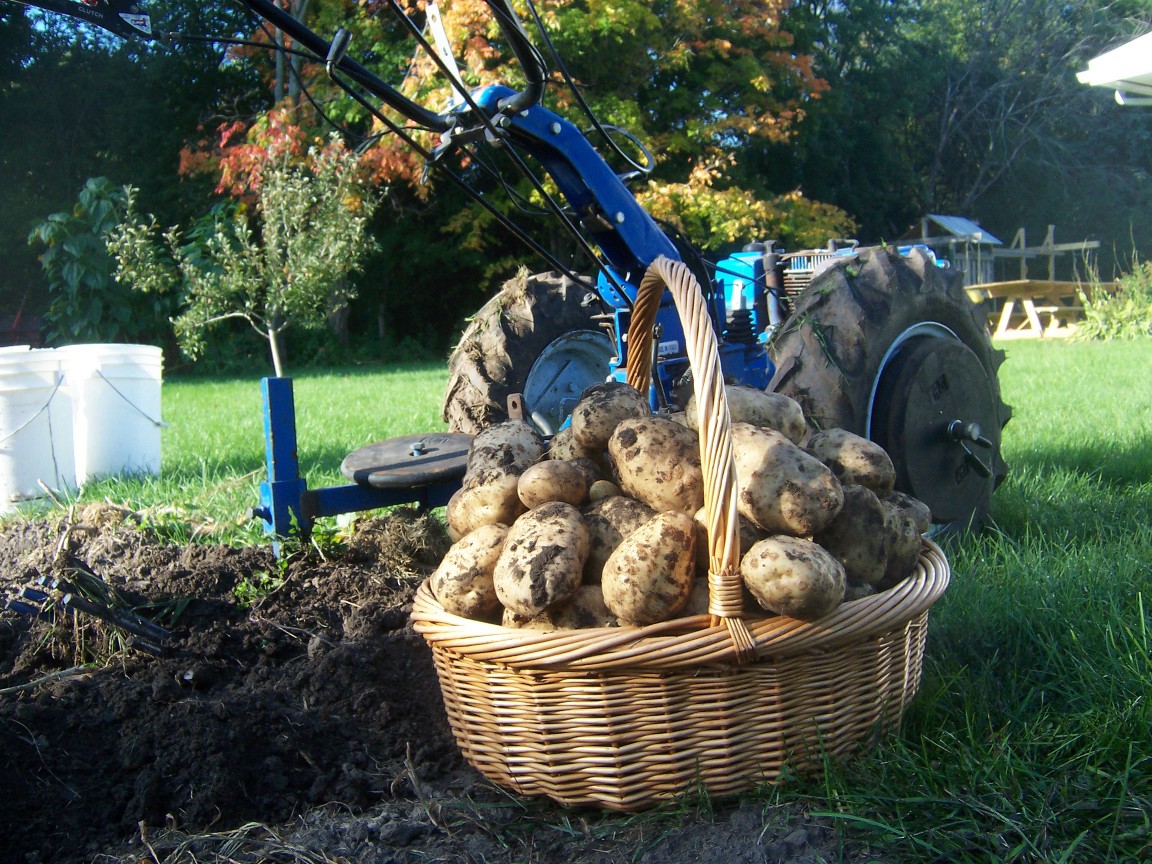

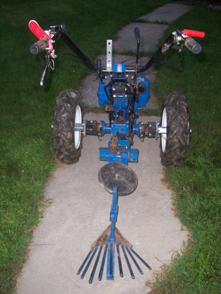

Another reason against wheel spacers is the wider your track, the harder it is to turn a solid axle machine. I had put free-wheel devices(the outside tire ratchets forward when turning), 6-12-23 inch tall tires, 10 inches worth of wheel extensions on each side, and weights on my 730 last year to dig my potatoes. The 730 was an absolute bear to turn with all that weight and rubber out that far from the transmission. That's an extreme example, but a true one.
Extensions are great and necessary in several applications, but running a tiller is not one of those situations.

Man those are some good looking potatoes!!! My crop last year were total duds, no bigger than golf balls and most of the plants didn't make it. Does your 730 do a good job plowing with the extra weight?
