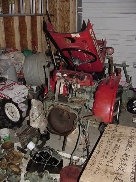

Splitting a tractor is not really that difficult. It is just very time consuming. It is also very educational. Getting it back together is the hardest part IMHO. Just take is slow and you will learn alot in the process. I attached a photo of my YM1110D split. I had the front axle off when I put it back together, and that made it harder.

First, how much oil is dripping? We don’t know for sure which seal is leaking so it would be good to find that out for sure before ordering parts and having somebody tear things apart. Any competent mechanic that runs a small shop can do this job half asleep. Just find somebody you can trust, your parts can be bought online from Len or the like. These tractors like most from that era are built to be simple machines that can be worked on in a field. To decide if it is the engine or the transmission that is leaking, drain the oil out of your engine and wait a few days to see if the drips stops.
   / YM 1500 Oil Leak #8
I have to agree with gbirky. If you have to split the tractor, it is a great educational experience and is allot easier than it looks. You will end up knowing your tractor much more intimately (if that is what you want) and have a better feel for why things are working or not working properly in the future. Sounds like EFC has some good advice about isolating the source of the leak.
