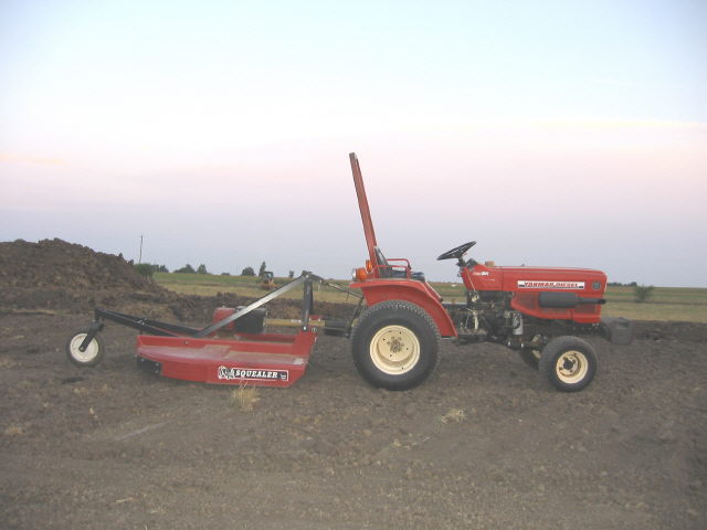

Have a 187D with turf tire option. Looking for full set of ag tires and wheels for winter. Looking for info on what size the ag tires and wheels should be and whether they changed any gearing for the turf tire option. Also, if someone has these ags avail., what the cost would be.

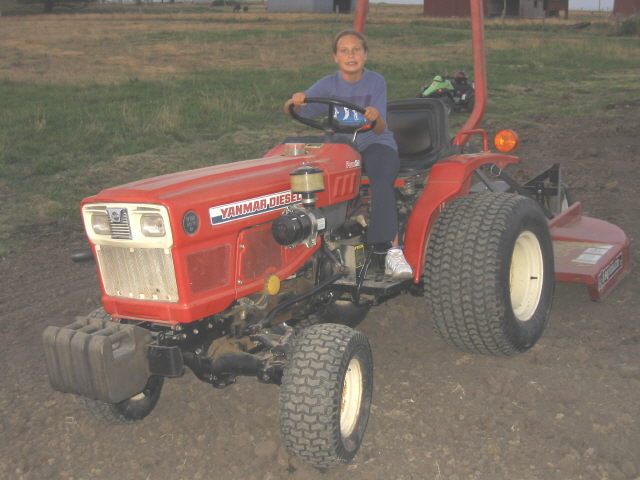

Thanks for all the info everyone. I don't want to get rid of the turfs that I have. Perfect for mowing. Just want an extra set of ag tires and wheels for winter. I believe that 6 X 12 and 12.4 X 16 sound about right. I'll try to figure out how to compare the aspect ratio of those with my turf tires and see if they're close. The original buyer of my 187D purchased it with the turf option so these are definitely the turf tires the 187D came out with. The fronts are 20 X 8.00 X 10 and the rears are 31 X 15.5 X 15. I believe the rear wheels are 13" wide.
Now all I have to do is find a set of ag wheels for it. The fronts are 4 bolt and the rear are 6. Please let me know if you have any avail. Guess I could get them made right down the road at HEY WHEEL & RIM http://heywheel.com but I'd rather just find a decent used set for a reasonable price.
I have to say, and I'm sure Whiskey will agree, the 187D is a great little tractor. I bought it with a 5' Bushhog Squealer. Thought the 5' might be too much mower but the 187D has no problem handling it. All the filters are in stock at the local parts store. Even found the Wix air filter at O'Reilly Auto Parts for about $15.

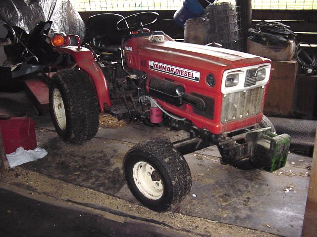

You bet your backside /forums/images/graemlins/grin.gif, I've run my YM187 hard for years and it's never asked for anything but good fuel, clean fluids and filters. I just bought a new tractor (it's a yanmar...go figure) and I just couldn't bring myself to trade the YM187 in on the new one.
The next project is to clean it up and put it back into shape...it's not anywhere as close to as purddy as yours /forums/images/graemlins/blush.gif
