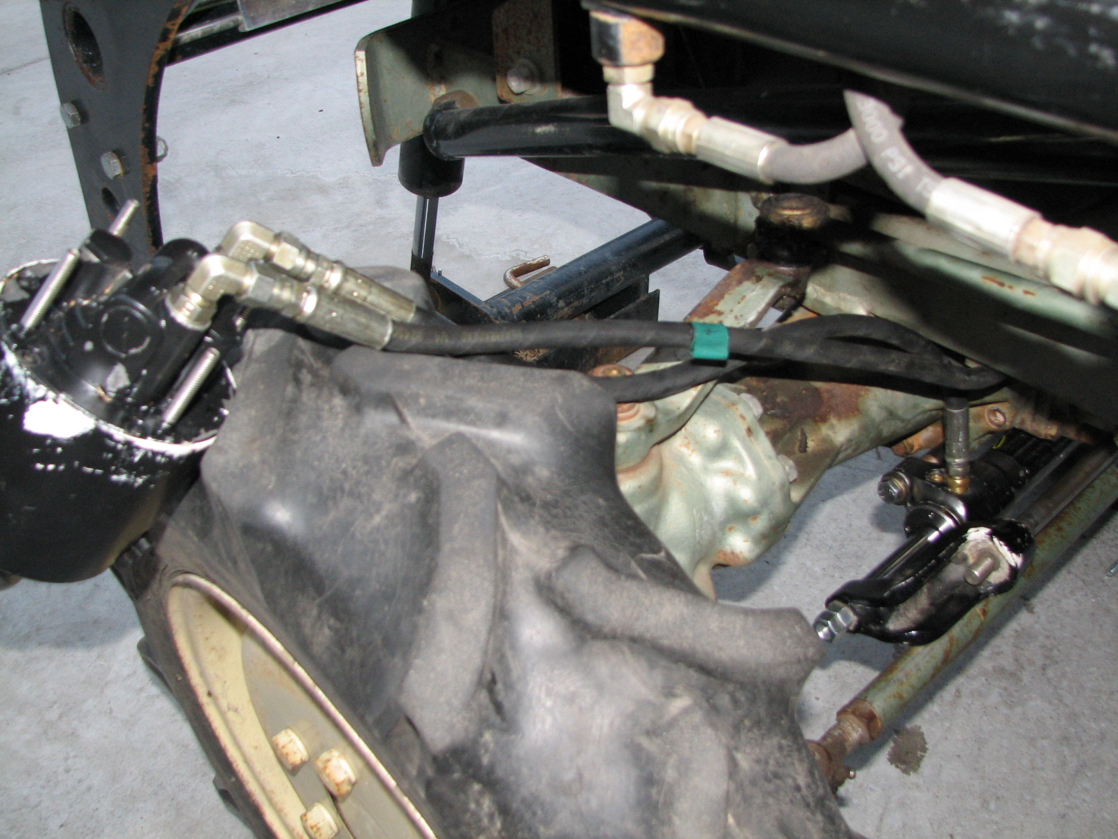

Ok I know there not a add on power steering for the YM2000. has anyone thouth about trying to put a hyd steering unit from a outboad. From what i understand the pump produces about 1500 psi to a hyd steer cylinder. I havr went out a got a unit and trying to install now. Any ideal or commints? thanks Tim

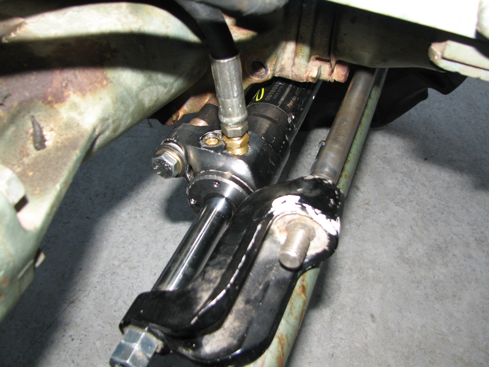

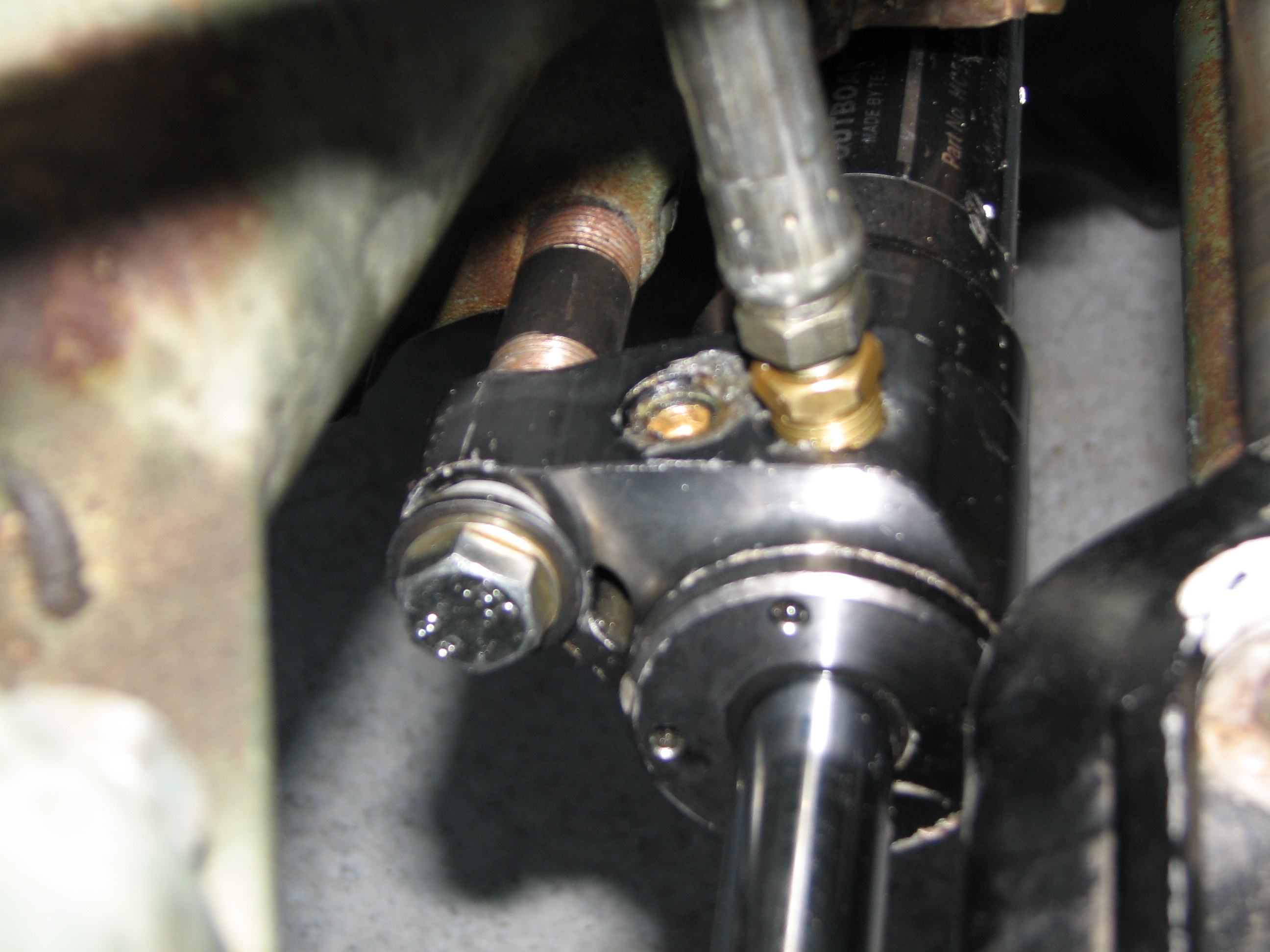

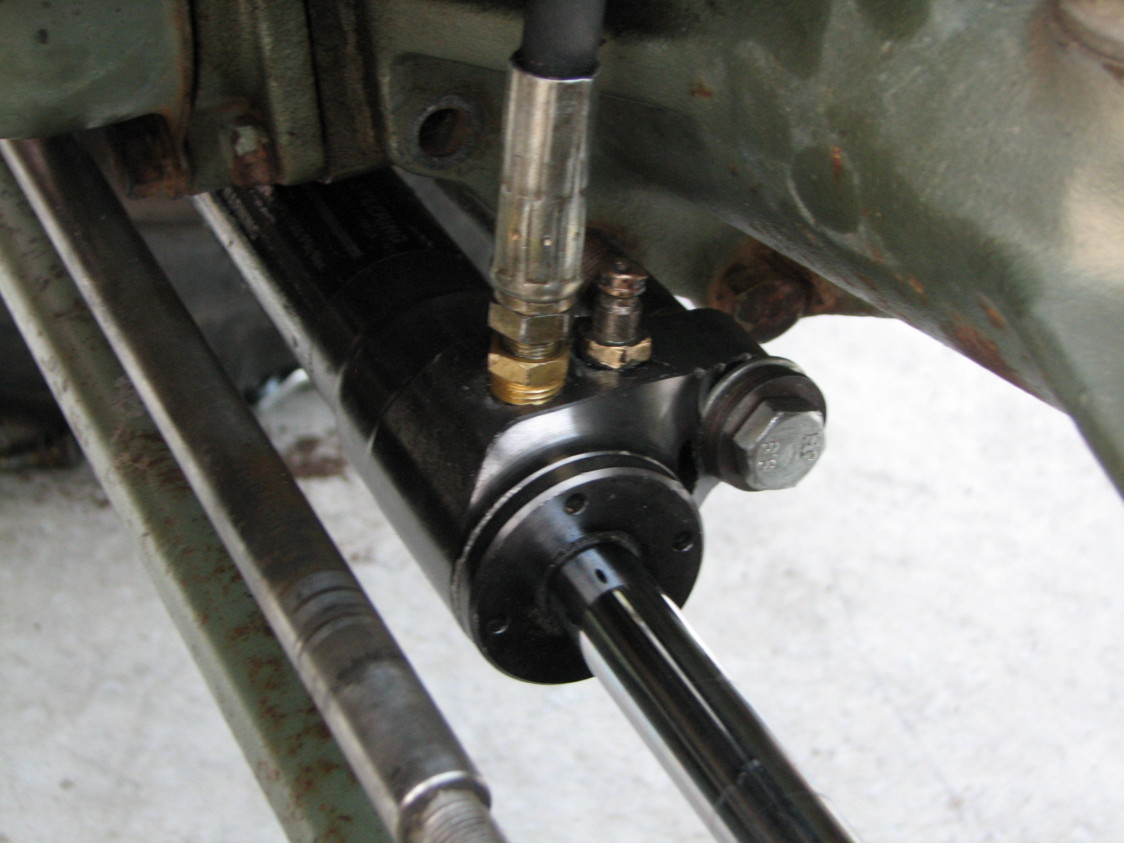

OK worked on this project today alittle.. Here are a few pic so far.

Tim,
Very Nice Job!
I have to admit that I was thinking along the same lines as Norm. Will the add on be strong enough to withstand the rough environment of typical tractor work (?). And also thinking that it's original design was for a more gentle operation...
I've changed my mind. Looks like a well thought out and sanitary installation. The pump and related castings and ram look physically strong enough and your adaptation appears well engineered. Maybe a 'skid pan' or some form of protection from the underside would protect the pump, hoses and drag link connections...other than that, I'd let her fly and see how well it holds up during a day of typical tractor operation.
Oh, maybe one other change? Your picture size loads painfully slow for us dial-uppers :).
I look forward to your progress and thanks for sharing.
Mark

Nice install.
I would put one of those rubber shock-absorber boots over the exposed smooth cylinder ram. (Hose clamps at each end to keep dirt out) The rack was originally meant for water only, no dirt/mud/rocks etc.

Havent had time to work on it this week. The cylinder shaft is just under the size of the drag link. The cylinder location splits the drag link. but the ideal of a skid pan and boot cover is also good. I will removing the ols steering asy and insatlling a cover plate with the pump installed on it. i will use a small shaft with a unvesal joint on it from the whhel to the pump.
