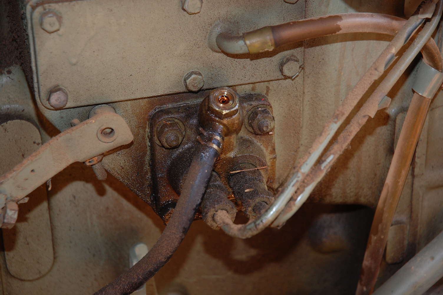

After changing my fuel filter, I turned the bleeder screw and the head twisted off, leaving the screw in place! Any thoughts on how to get it out, or will I have to replace the whole assembly? See photo attached.

I have had good luck with those backward drill bits that you can get at Sears, etc. If you do need a whole assembly though I have them for only about $8 and they include the new bleeder screw.
Good luck

Thanks Aaron! Your web site is fantastic. Sam? was a big help, just ordered a new assembly! You keep a lot of Yanmars working in the fields!
