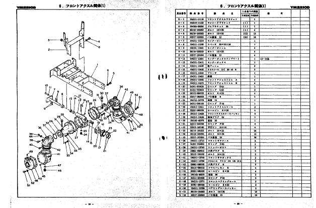

Did you download the FREE manuals yet. They can help to answer your questions.
Manuals are at the Yanmar Tractor Owners Group, the link below in my signature. ;)
BTW, there are 2 parts manuals, early model and later, so get BOTH just in case.
IF you don't use the YM in front, some will think you own a Mitsubishi tractor with that model number.
This is from the early model parts manual.
This is front the later (newer era) model.

'some' of the -10 and -20 series are swapable in the correct tractor family. There is a thread here about Yanmar Tractor Cover pages that goes into those depths. Basically all that changed was the engine had more power or the machine was gear vs. PowerShift on the floor or PowerShift on the steering column at the dash.
Ah ha, caught your other posting in the newer Yanmar thread. Looks like you are looking for the knuckle & kingpin assembly. Those are RARE. Yet, someone did their homework months ago and found out that the John Deere 790 4WD assy was a perfect drop-in for their YM model.

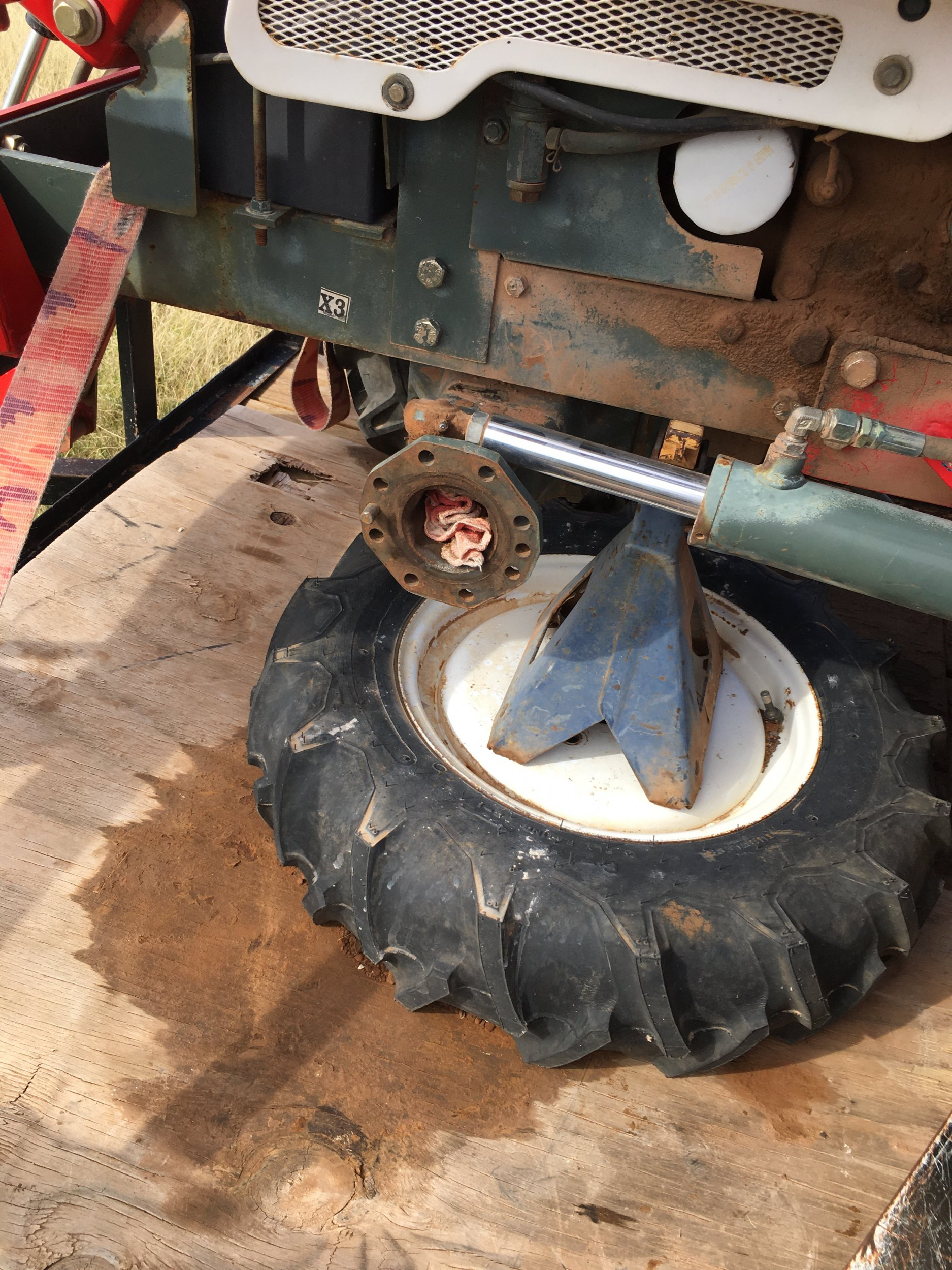

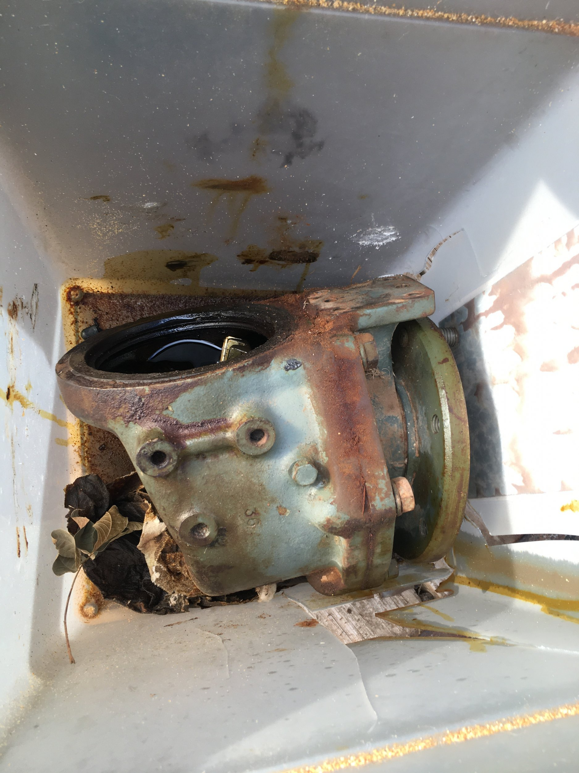

I sent it to repair shop... and they lost the parts and everyone quit... so this is what I have left!!!

WOW. o_O
IS there a way to mount the wheel on and make it a 2WD till you get the 4WD parts?

This tractor only has 100 hours on it... sat for years... starts right up!!!! Wish I could just find someone with the whole assembly... together and buy it from them.
