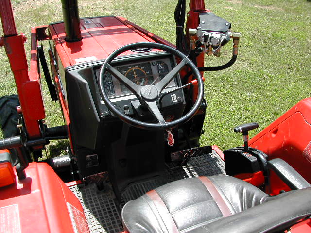

If you are planning on putting a loader on the tractor, go for the FX. Here's why, the shuttle shifter is on the right side fender and when you are using the loader and changing directions alot, that shifter being in close proximity to the FEL joystick is nice.
